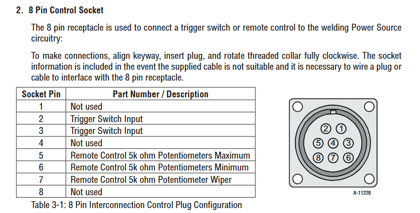

The first thing to tackle was the connector, as although some companies were selling spare plug for about £25, I could not find any information about the actual make/model of the plug.
The instruction manual details the pinout, but not the part number.
After some searching and test fitting, I believe it is a TE Connectivity AMP CPC (Circular Plastic Connectors) Series 2, 8 pin, reverse gender.
Male plug : 206434-1
Housing Backshell: 1-206062-7
Male crimps: 66506-9
You will find all of these part numbers availiable as free samples from TE, if you are a "business" ;-)
I got away with using a crimp tool for Molex XH pins, sure you could use some pliers in a pinch.

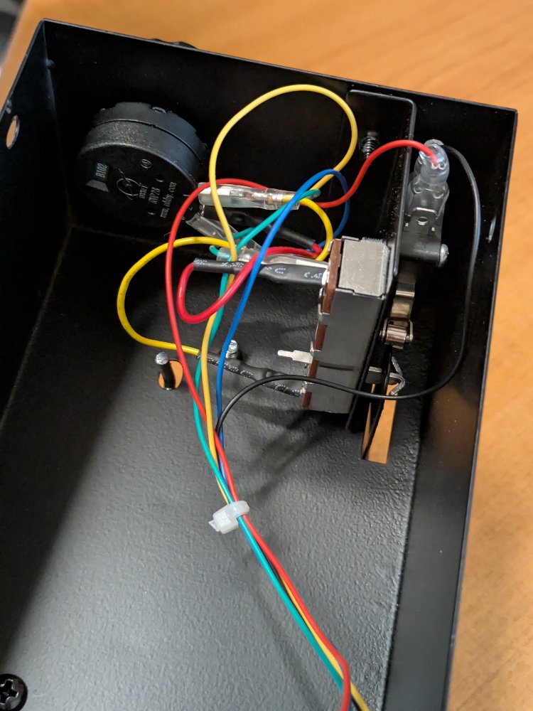

The next piece of the puzzle was a pedal. I found a pretty generic one with a 1k pot from Aliexpress for about £30. It was sold as a HZXVOGEN 5 Pin Foot Pedal For HVT250P.
The manual seems to explicitly call out a 5k pot. If it is just used as a voltage divider, I don't see it making much difference. If the signal is current driven to eliminate noise, maybe this will come back to bite me.
I hooked the terminals up as follows (your cable colours may differ!)
2 - Red (switch)
3 - Black (switch)
5 - Blue (Pot hi)
6 - Yellow (Pot lo)
7 - Green (Pot wiper)
The second pot on the back limits the maximum.
I will report back once tested!
