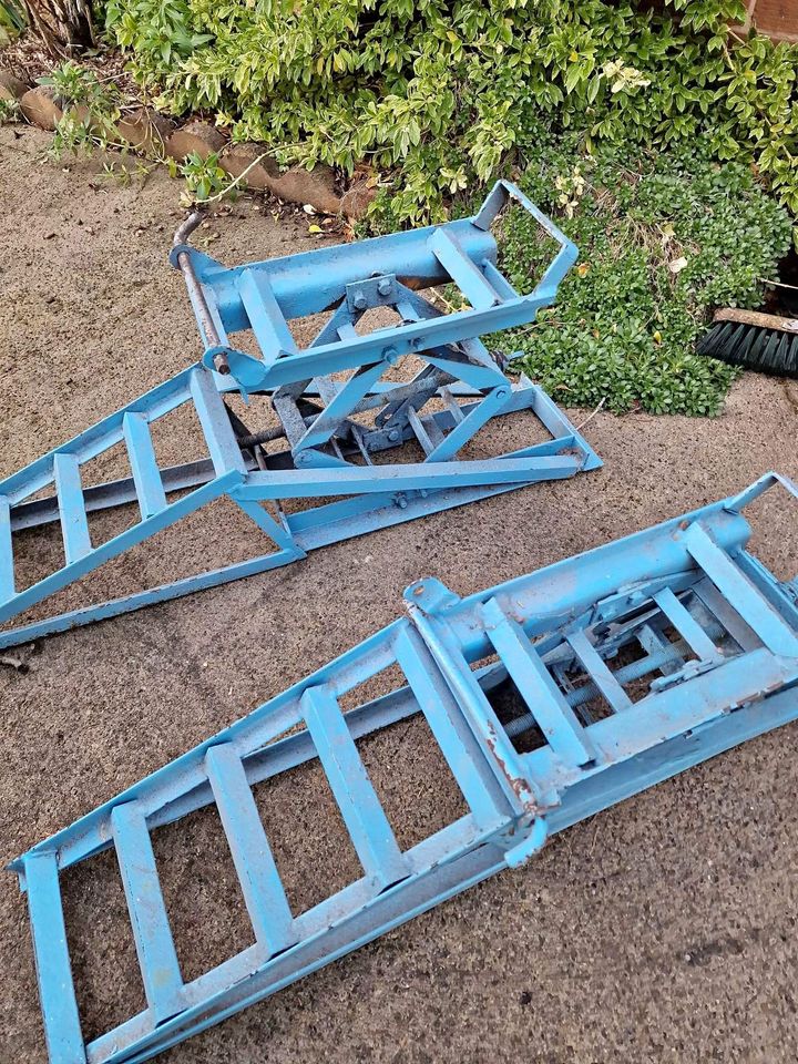

Would the cost of you making them be cheaper than.........
4 ton Hydraulic Car Ramps 2x Heavy Duty Garage Auto Van Bottle Lift Jack Ramp UK | eBay UK
The maximum loading weight is 2000 kg per ramp. Hydraulic lift cylinder inc luded. Made with Heavy duty steel. -Total length: 1140mm Drive. - Color: Red.www.ebay.co.uk![]()
Yes I can see it being a pain.I had some of these but not for long winding them up was a pain in the ar$e if I made some id use a porta power or hydraulic jack to raise them not a screw
And there's nothing to keep the floating bit horizontal either.The lifting part on the ramp in the original posting looks rather unstable. The mounting points of the scissors are very close together.
the wheel does always drop into the center of the raising bit but I always thought the pivot points of the scissor bit were too close together so would not use them without axle stands under the chassis so that to me defeats the point of rampsAnd there's nothing to keep the floating bit horizontal either.
If the wheel was offset fore or aft the whole top thing would pivot that way.
I made a set like that.I've seen ones that don't scissor, you drive on and then remove the ramps?

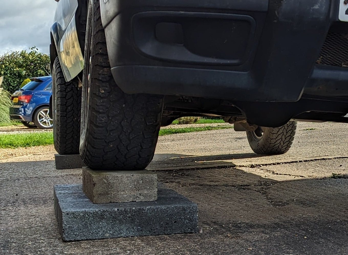

I don't like using ramps or jacks, they both scare me a bit.
But I'm quite happy to use heavy concrete blocks...
Plenty solid enough for my Disco TD5, runs up there no worries.
Disco is standard height so goodish room anyway, but these lift it about another 8-inches, quite handy.
And very cheap...
Could do with a few more blocks to make it an even lift , but I'm a bit tight...
