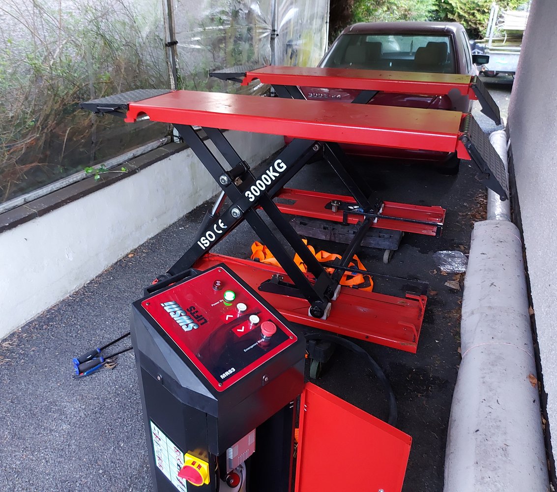

I like the pneumatic lifting idea, but I’d just have to have some kind of fail safe locking pin in place. Or axel stands.

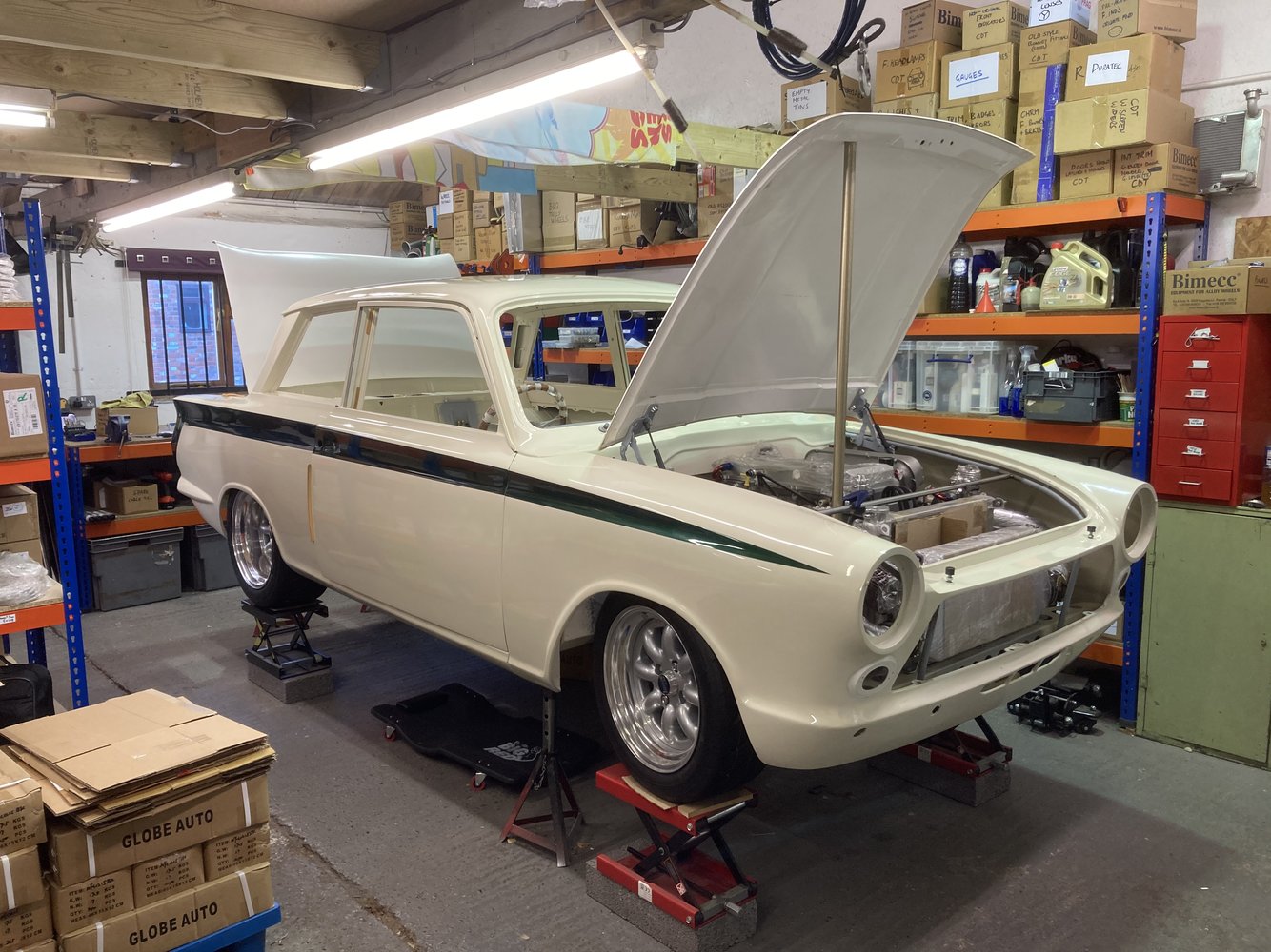

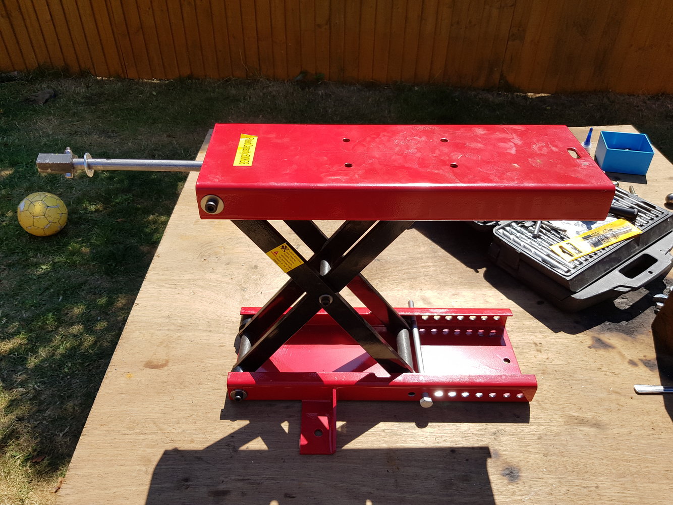

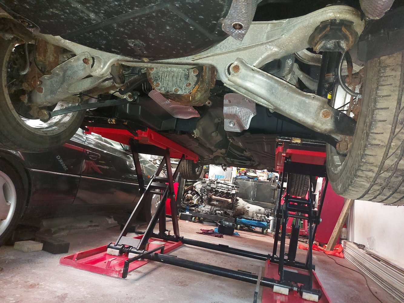

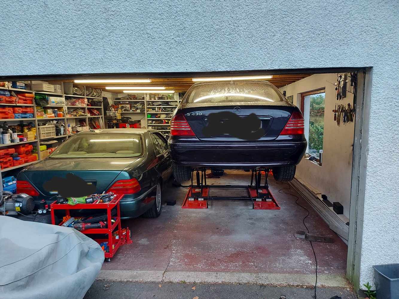

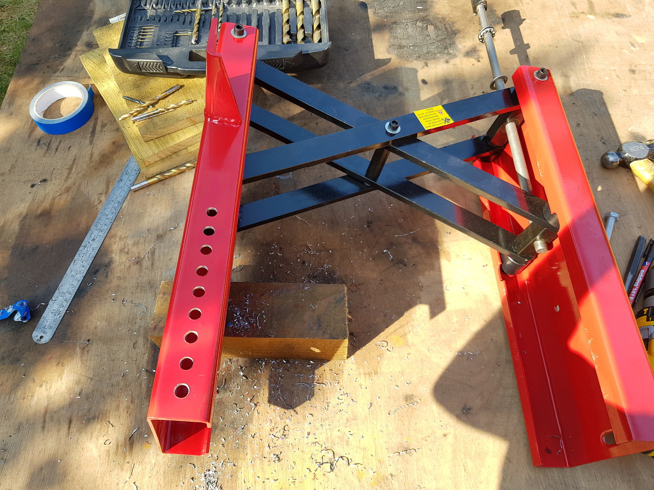

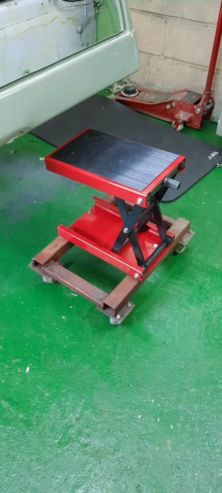

Can I share a similar idea. I used four motorcycle screw jacks. 460mm lift. I still used axel stands for extra safety. The screw jacks work fine, but it’s a faff. You have to lift each corner bit by bit.
