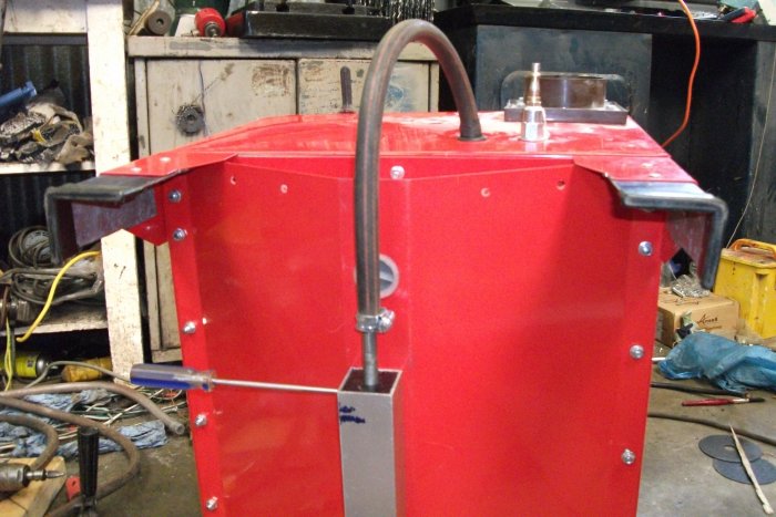

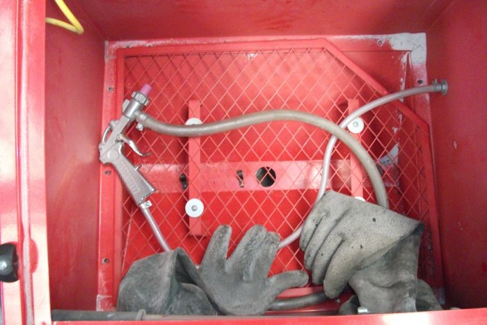

i like the cabinet so far make sure it has strong legs as blasting media is very heavy. i found aliminum oxide wore my tips out in no time [hrs] where as j blast supa fine only wears them very slowly but yet seems to do just as good a job and is just as quick at it.
The coating on ally wheels can be very tough i have recently done a Toyota set and it was quite slow going compared to removing paint and rust
how are you going to fix your winow ?
i used a sheet of ply bolted in and sealed. with my window cut out in the ply then used heavy duty drought excluder around the edge where the glass sits then put window in. then i have 4 wooden turn buckles holding the glass in . i put a bit of foam between the turn buckle and the glass 10 seconds and the glass is out.

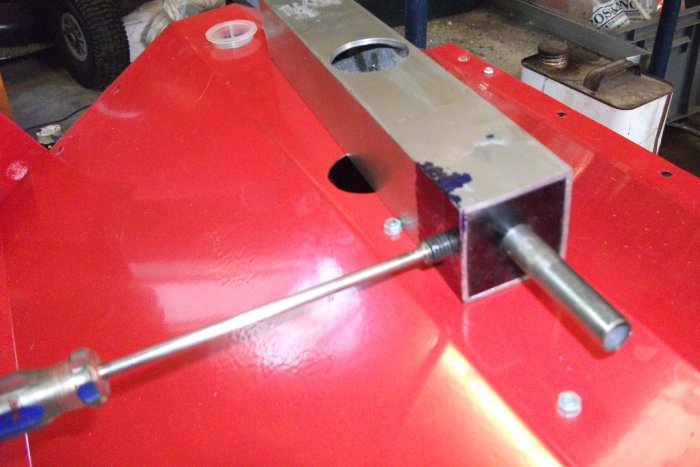

when you cut your tank open consider putting a raised mesh floor in. it keeps your work off the cabinet floor and helps to keep the dust down within the cabinet you may just want a small one otherwise it would make brushing out difficult so just a small mesk work stand/ bench
that will help the problem that is what i did for years before altered mine. it slows down the suction in the pipe
