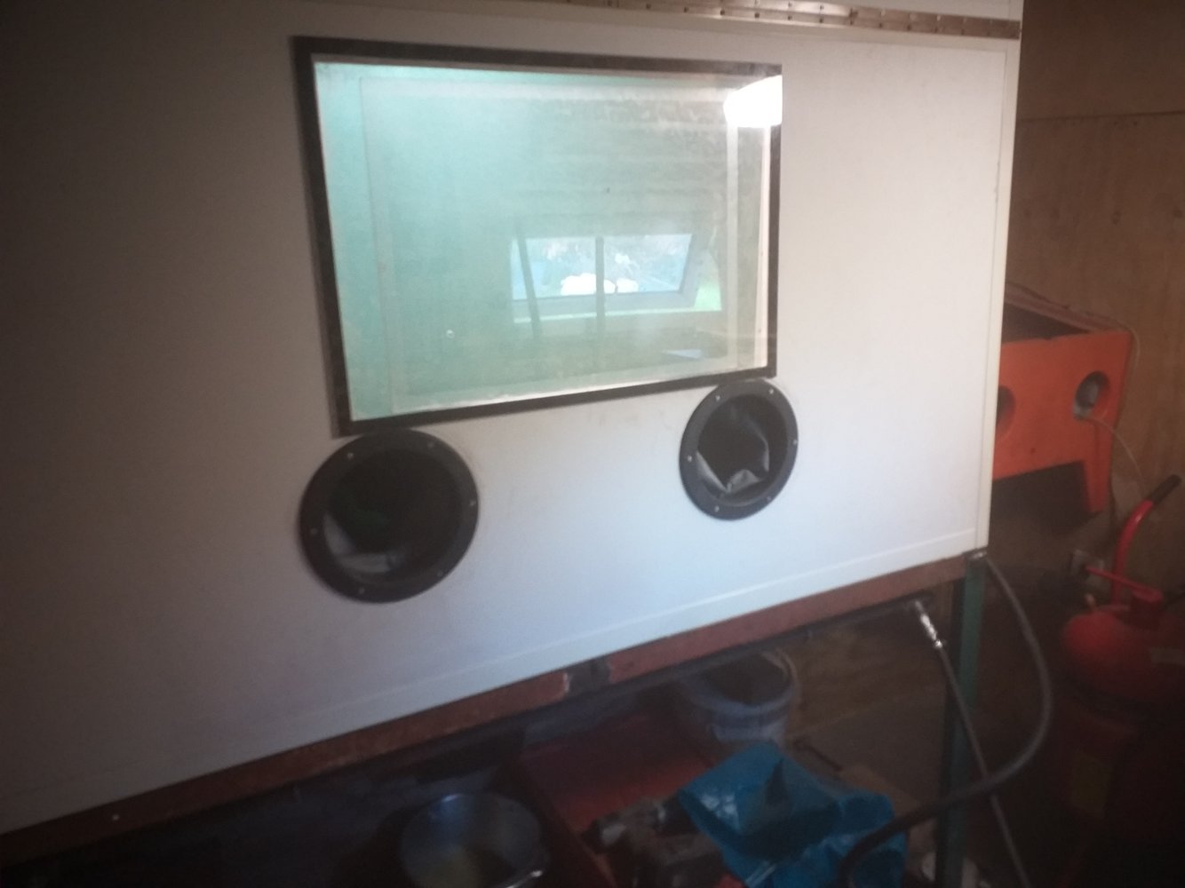

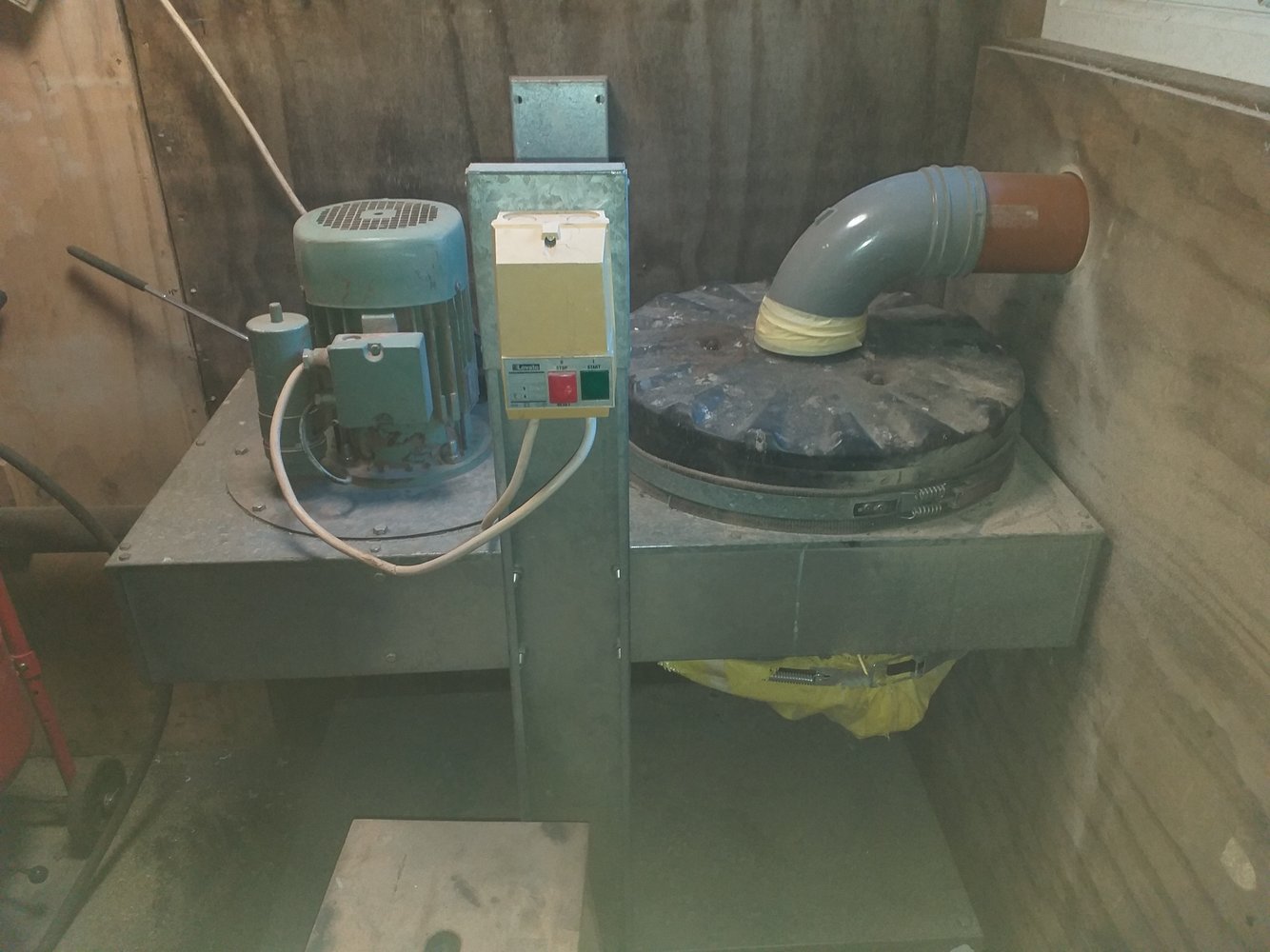

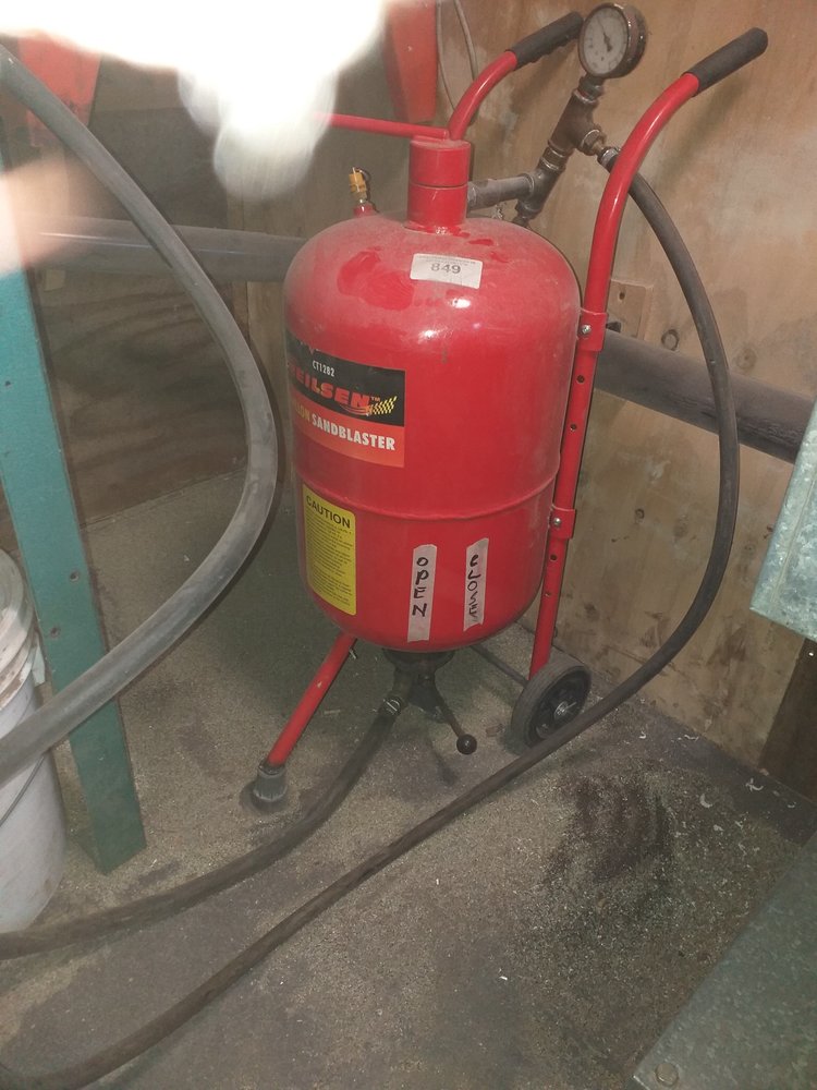

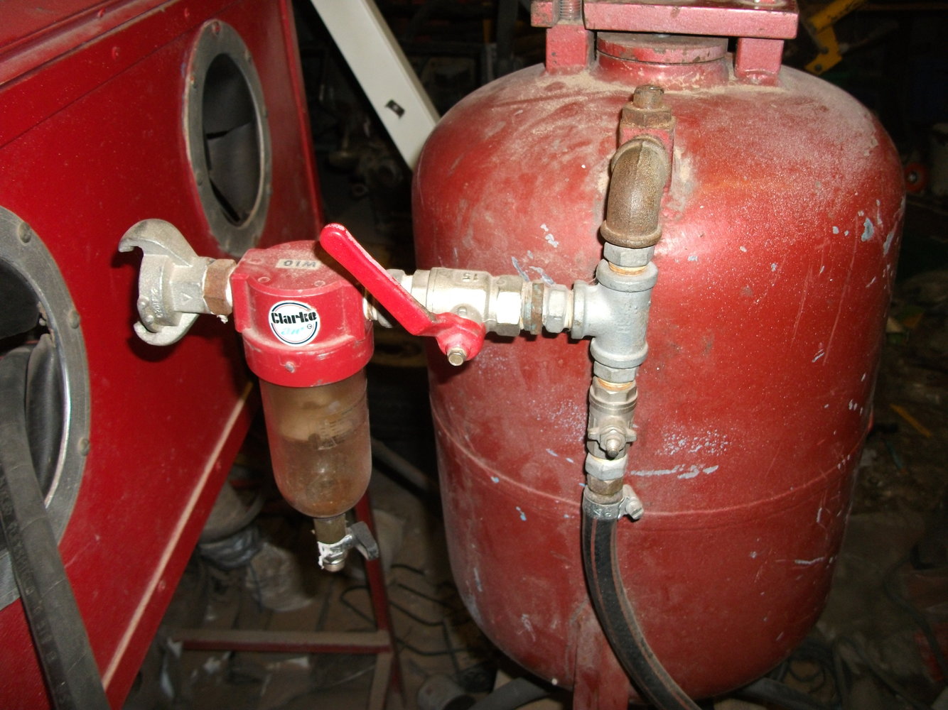

there are loads of posts on here about blasting cabinets, unless you want something special just use a commercial one, they can work quite well with a few tweaks, one of the main ones being having adequate dust extraction. Ive got small benchtop cabinet that has been modified and works quite well. If you want a large cabint or to do large parts I'd be looking at using a pressurised system rather than a syphon system as it works much more efficiently.

Are you using a pressurised system as opposed to syphon? It appears pressurised is the better option?
