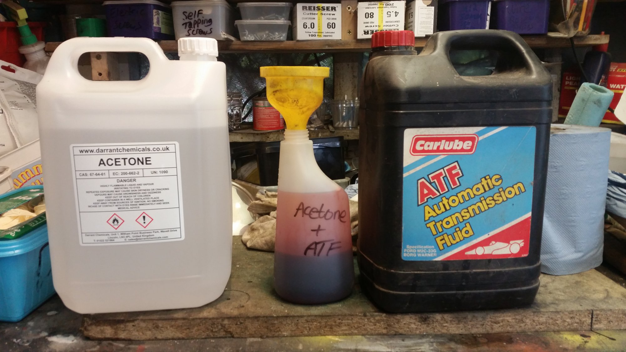

I received my acetone yesterday £12.95 delivered from Ebay for 5L
If your using penetrating oil to free up seized nuts and bolts then a good home brew concoction is a 50:50 mix of ATF and acetone.
I came across this a while back and looked it up on the net. Some scientists have deliberately sized some nuts and bolts by soaking for a week in sulphuric acid then applied a variety of commercial and home brew fluids and measured the tourque required to free up. The ATF/acetone mix was a winner each time, plus much much cheaper.
I now have some in a wash bottle and can report it works a treat.
It's a funky reddish pink colour and tends to separate a little when stored, just give it a shake before use and I can report it realy does work. Give it a go and it will be interesting to see what some of you folks think
so when youd come back to it it needs a shake ya?just made up a sprayer bottle full and yes it does separate quite quickly not used it yet though
