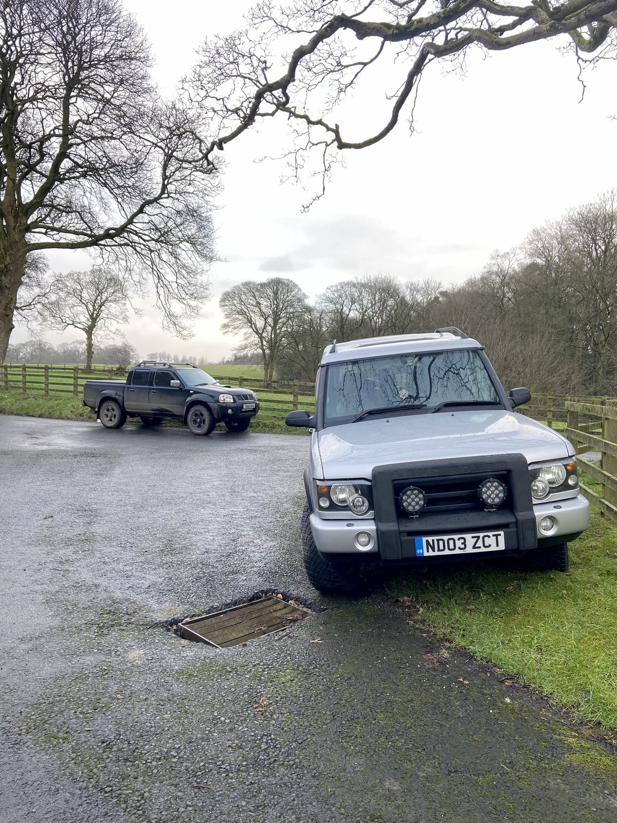

Cheers, I dont think she knew, its only been to Tesco and back in the last few years,You're a man possessed, it is great when things are easy and cheap to make perfect when a previous owner didn't even know or didn't care.

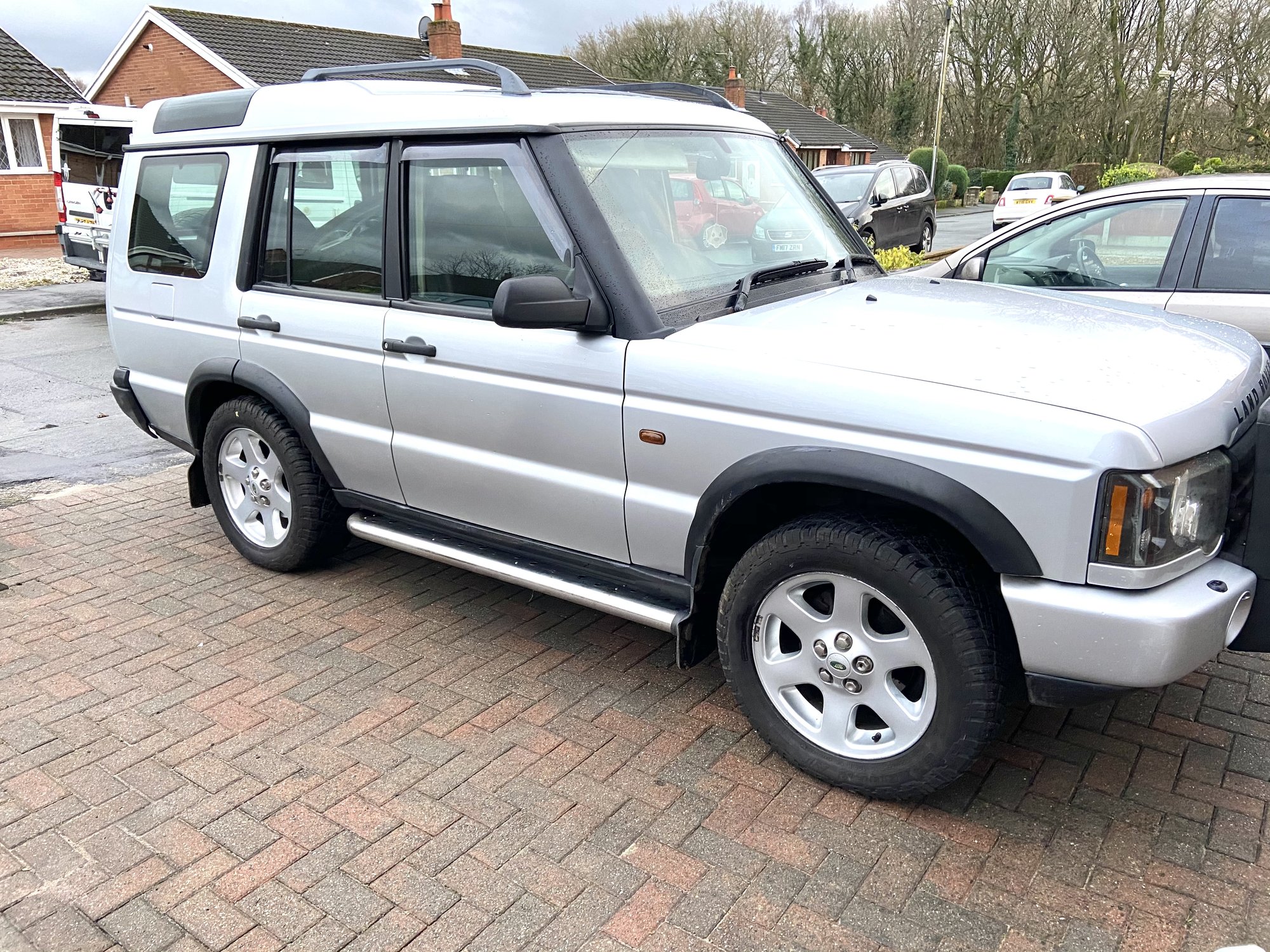

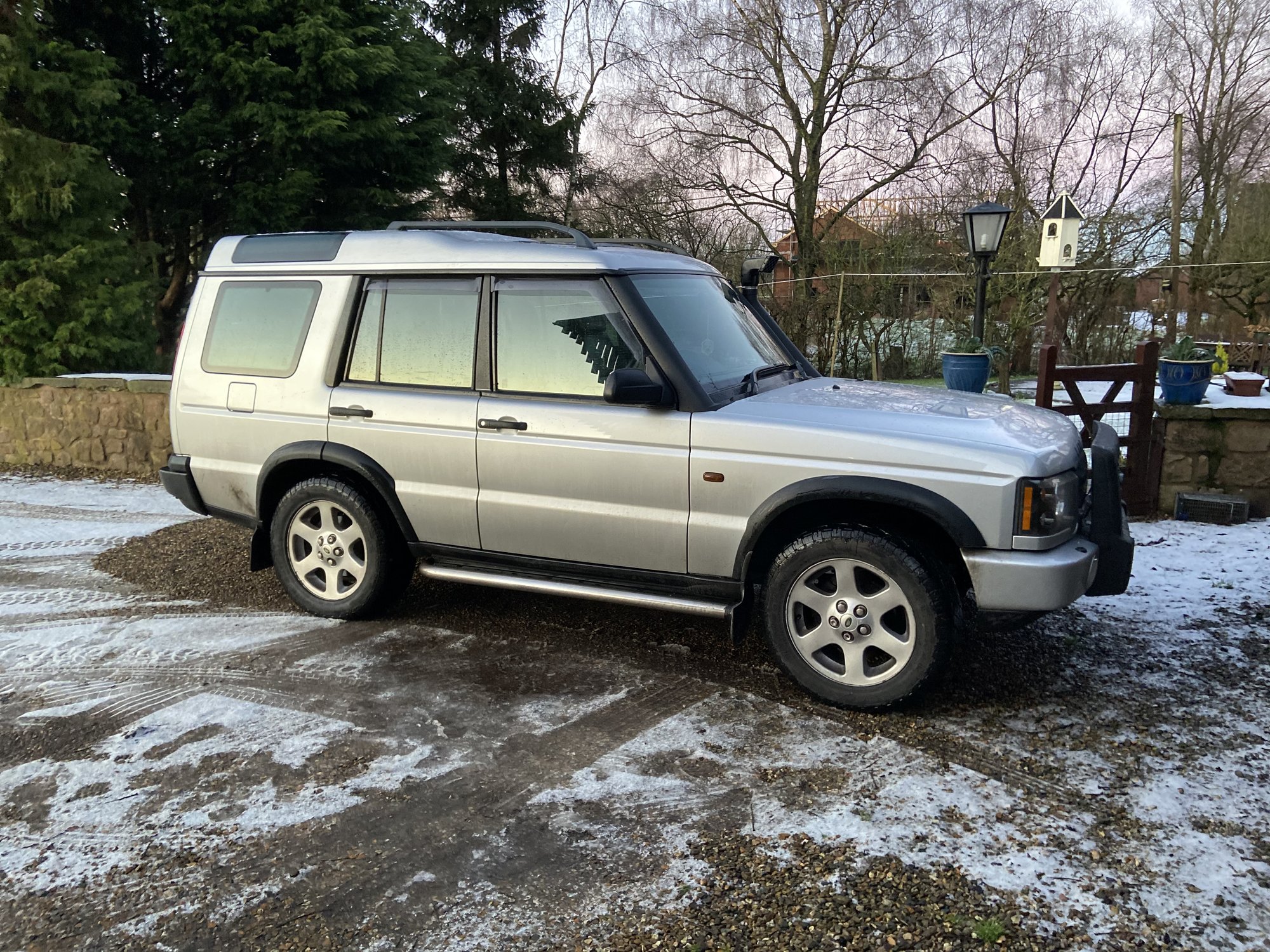

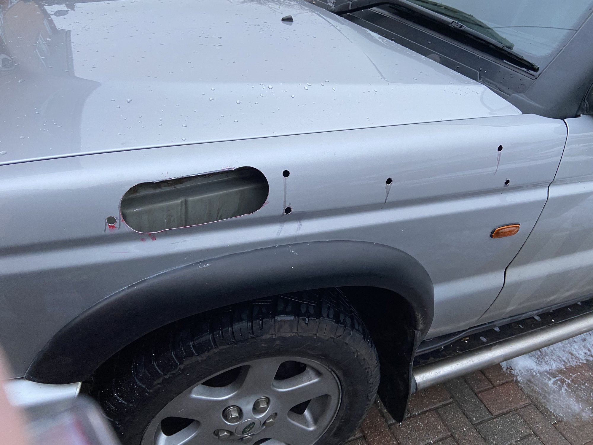

Decided to leave the side steps on. Made a start on fitting its christmas present today. Done the scary bit![]()

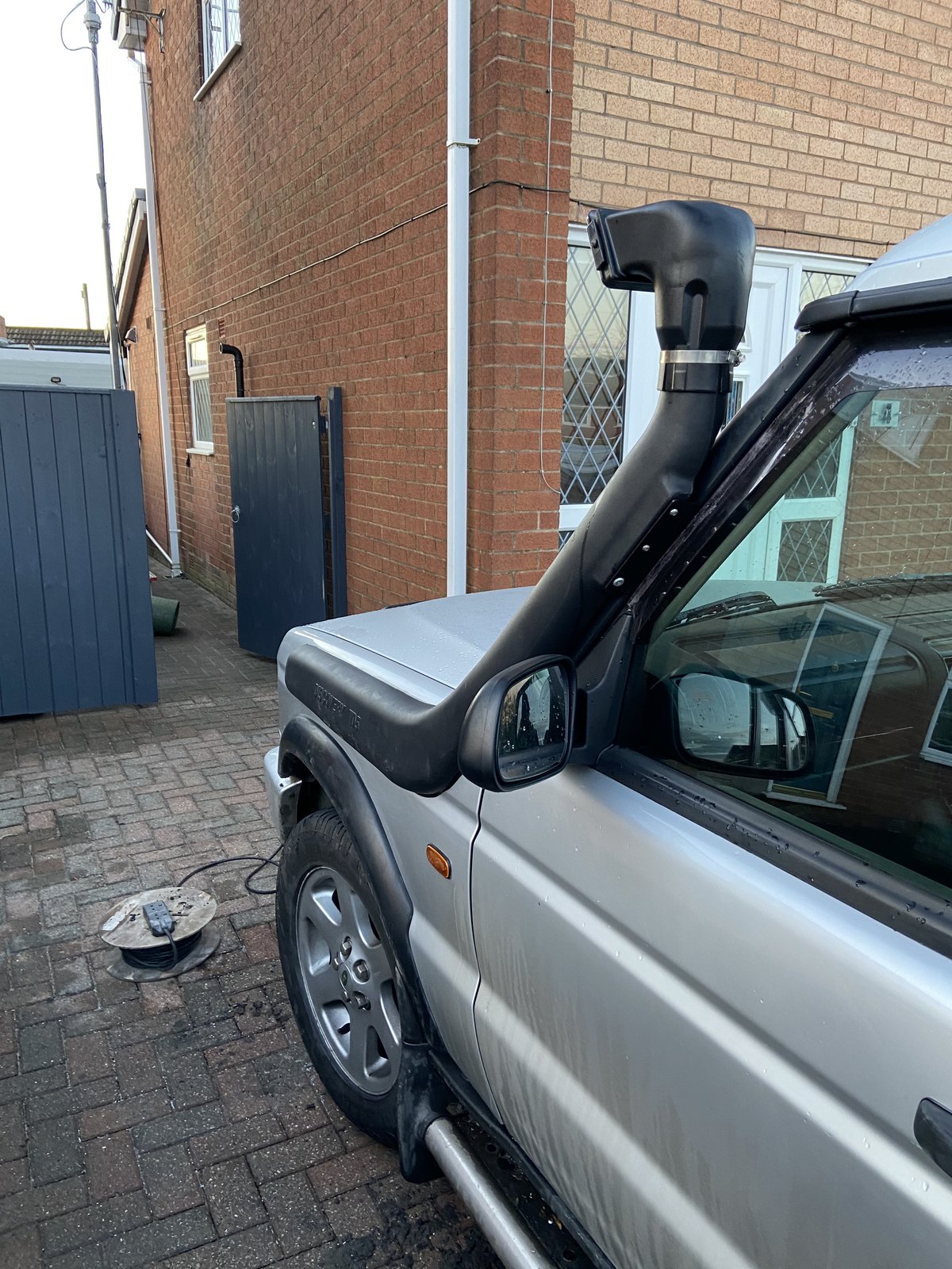

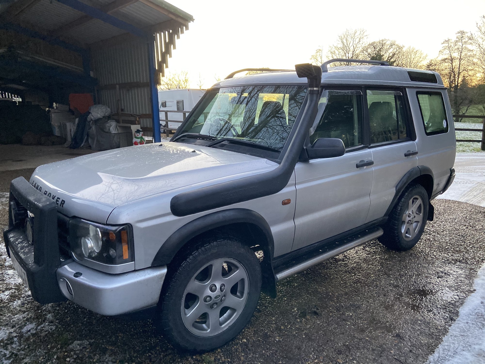

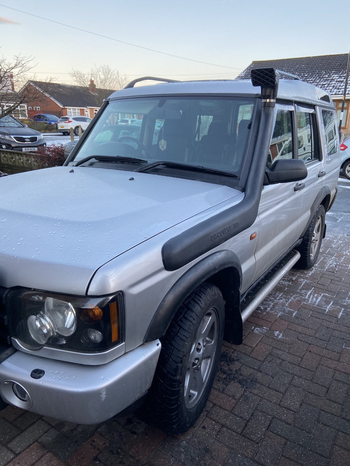

Ive modified every car ive owned and attacking the D2 with a holesaw for the snorkel was squeaky bum time
I sealed it all up with some duct sealant from screwfix, it was fine when a crossing was deeper than expected and water came over the bonnet

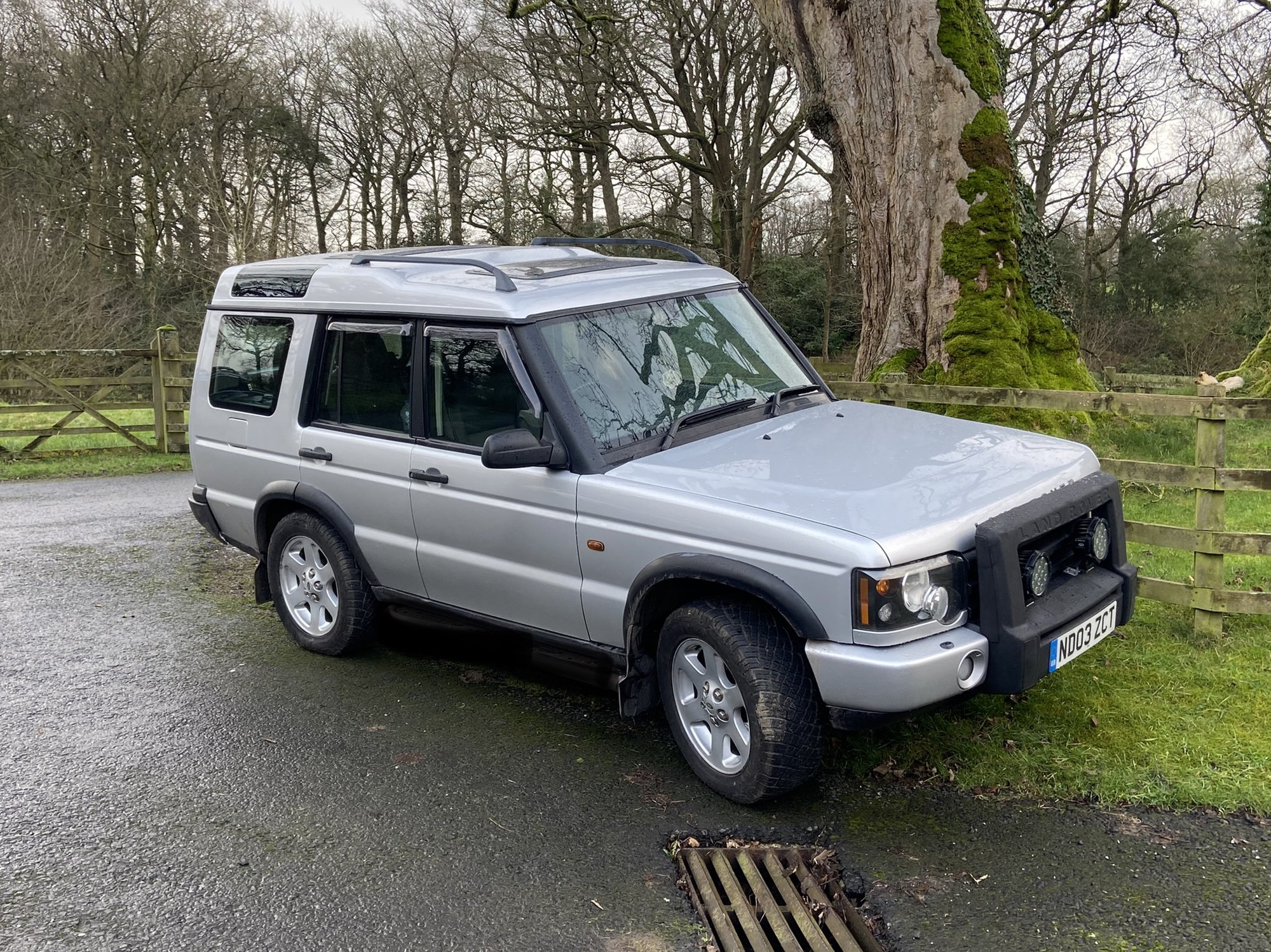

cheers, it came with a template so less scary than when I attacked the navara with a cutting disc to fit a sunroof. Ive got some sikafkex ebt+ to seal everything, its given a nice if cold day tomorrow so hopefully will get it finished
Did you seal up the rubber ducksbill thing on the bottom of the airbox ?I also taped up the cloth pipe from the inner wing to airbox, added sealant and jubilee clips. I tested by putting my hand over the top, tried to suck my hand in but the engine died, confirming it was properly sealed

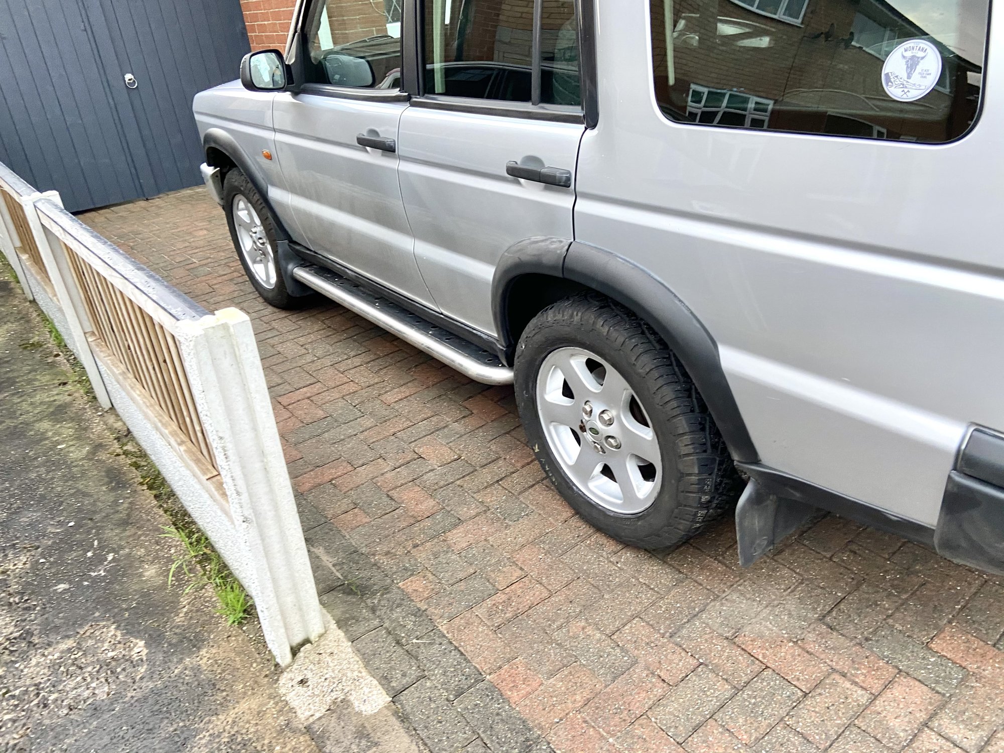

My Defender 90XS came fitted with side steps, after its first proper offroad adventure I discovered they were just cosmetic as they were wrecked. Good excuse to fit tree sliders then thoughTook mine off after one err removed itself while off roading. Much preffered it without
