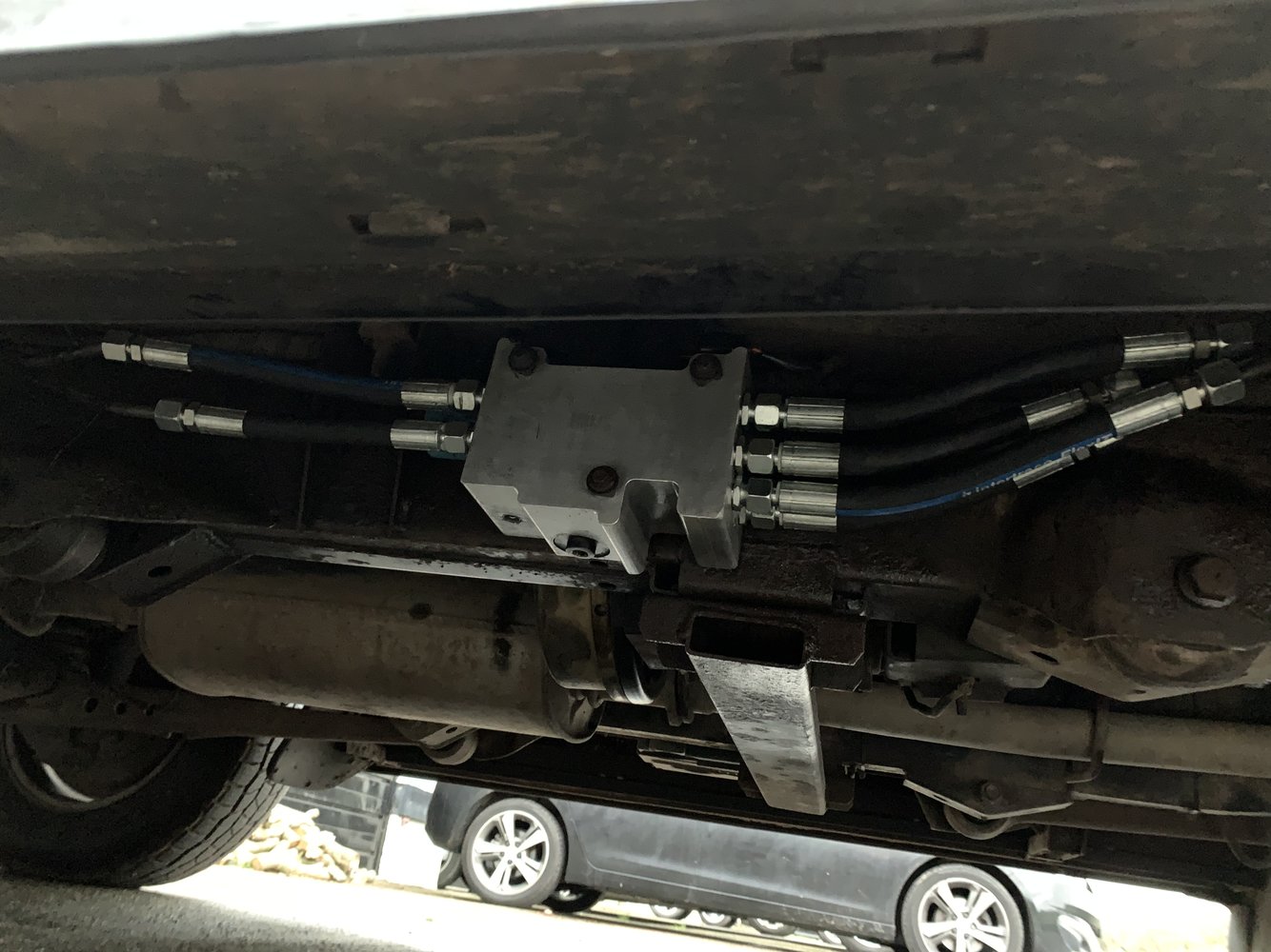

If you know Discos you’ll know that the ACE hydraulics can be troublesome.
Ours was leaking where one of the rear pipes enters the block.
I bought a used valve block on eBay and took into one of the businesses I deliver to to have all the ports drilled and tapped to 3/8 bsp. A local hydraulics place made up the hoses and terminated them with 10mm compression fittings. (Yes, I know the pipes are 3/8).
Off with the old:
…and on with the new:
All being well it’ll outlast the car now.
