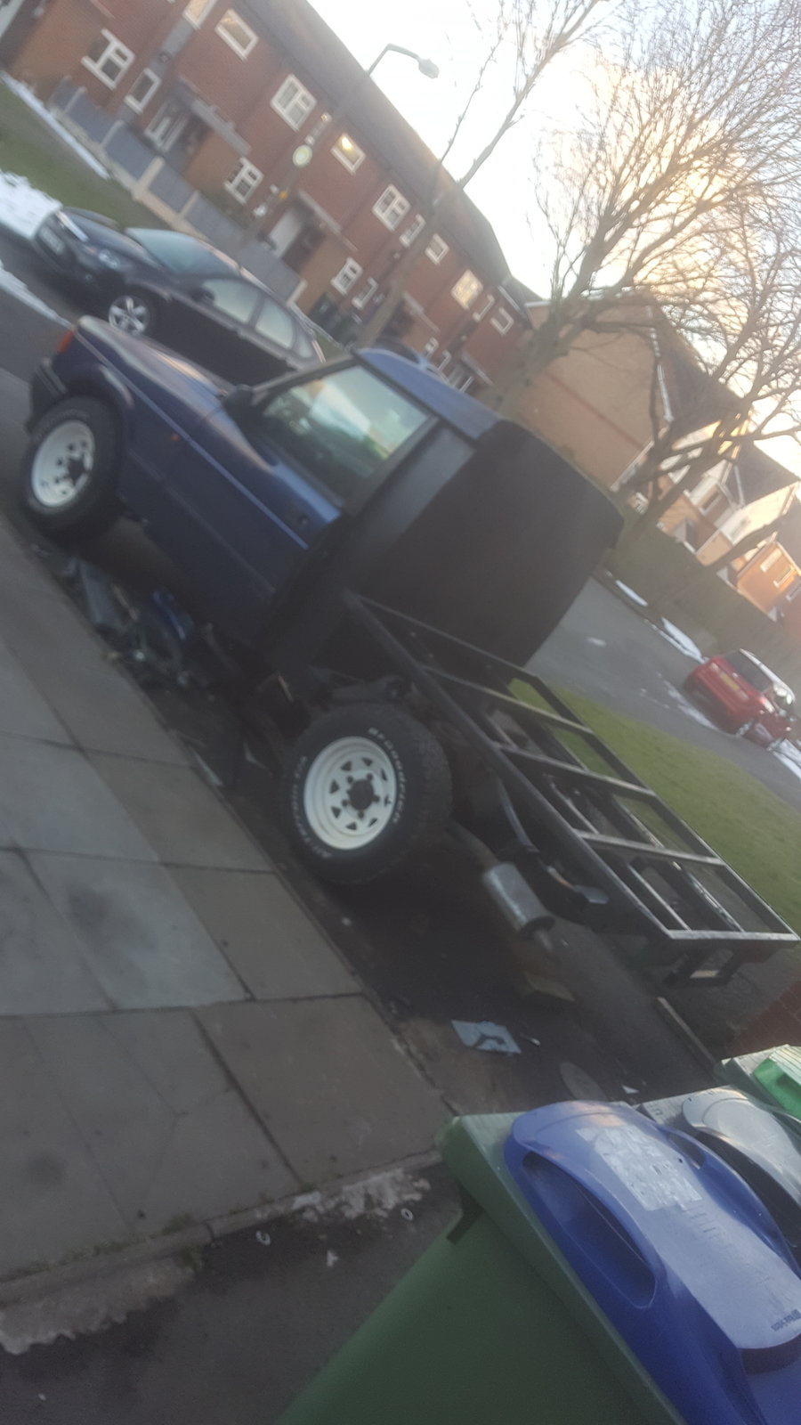

Hi, Not enough weight of the pick up bed might be more of a problem than fears of overloading it, otherwise it could get a bit tail happy. You would need it to weigh similar amount to the weight of the bodywork and internal fitments removed.
Colin
I have no idea how much the rear part of the body weighed
I built the rear of the cab out of 2mm so that would've added a few KG, but currently i know im way off.
3mm chequer plate is probably a good idea then.
