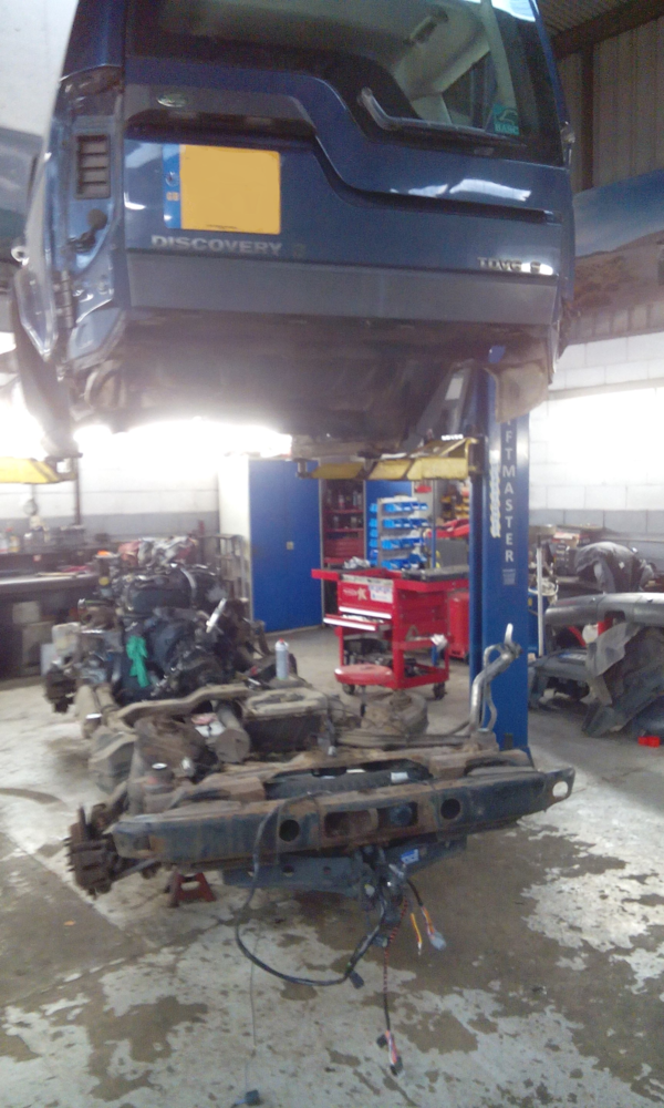

220k miles, 2010.
When cold, and climbing a hill, it sometimes goes into limp mode, with lots of grey smoke.
Scanned the codes recently and got a P1247 secondary turbo low boost pressure. This time, only a P2264 water in fuel. I think that’s down to a dodgy sensor, but it will, apparently put it into limp.
I can’t see a cracked manifold/pipe, and have checked vacuum on the TSOV/CSOV solenoid valves, if they are the ones on the front left of the engine.
TSOV (diverter?) valve removed and cleaned up, new actuator installed.
I did find this pipe off, which is the manifold breather:
Anything to do with it?
