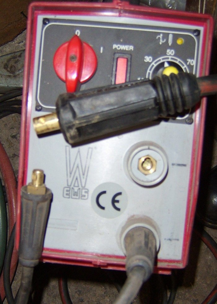

Ah !! just had a better look at the link that is the sort of thing i was looking for a while ago.
Can get them over here as well.........Dinse adaptor £14.
Are they rated in any way? I.E. 10/25 up to X amps? It's just that I've got 35mm cable in a 10/25 plug.
Basically there are only two Dinse sizes, small (9 mm) and large (13 mm). There's a third size, 15 mm if I remember correctly, but it' s quite unusual.
Smallest 13 mm connector is for 25 - 35 mm² cable which is what you should go for. Biggest 9 mm version is for 25 mm² cable, that combination would be best (using 25 mm² cable).
35 mm² cable in a 10/25 connector is difficult to fit and usually a waste of money. From 200 amps up it's the 13 mm Dinse, 35 mm² cable is overkill for low amps.
Anyway, the sizes are on page five here. Actually the area/amp details are there too.
