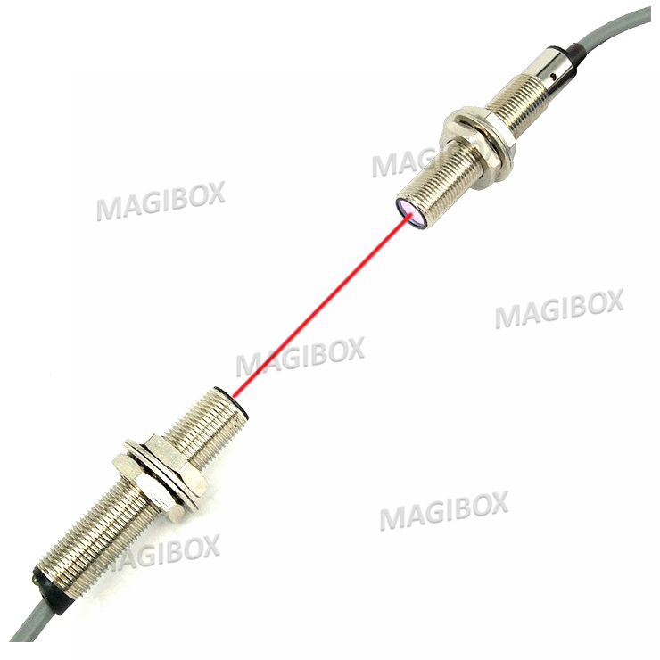

A mini laser module (Kidstoy) thats is mounted to the plasmahead, shines to a lightsensor with a cover a small hole in it.
The distance to the laser And the hole size determinte the angle when it shuts off . Good visible to reinstall if kicked over, simple , vibration resistant .
for reliable function the light (sender receiver ) should be modulated To not interfere with the plasma light..
aka industrial Laser light barrier
