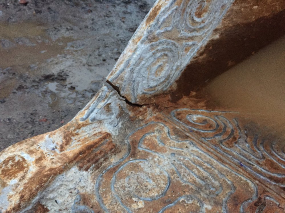

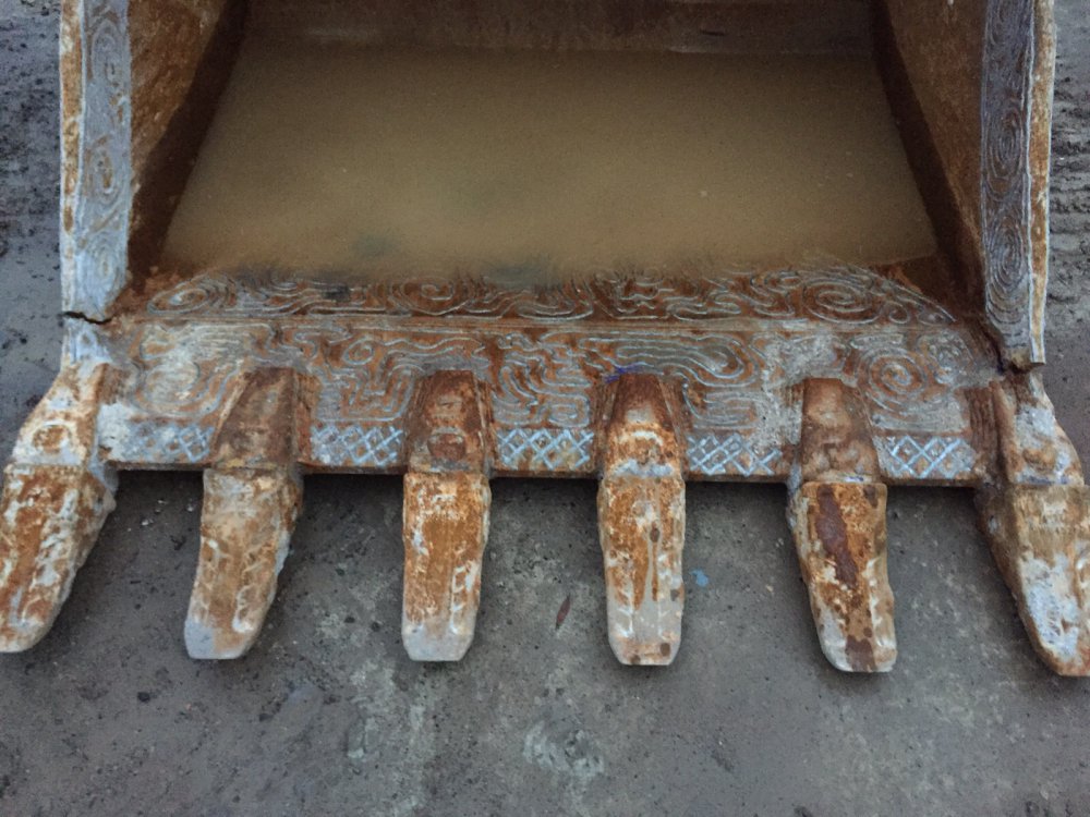

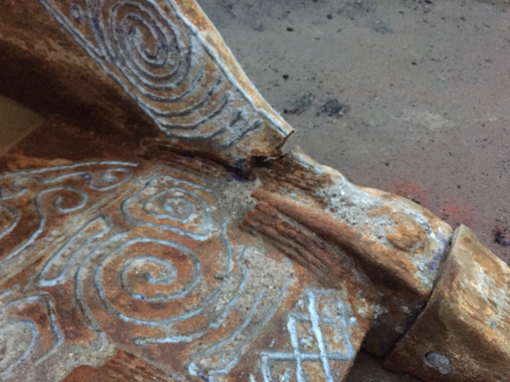

As I said it check cracks anyway so Id be tempted to give it a try without.........the risk is underbead cracking which is difficult to detect unless its bad enough to spall off.......If it check cracks it probably hasnt cracked under beadI never weave on these jobs anyway, only stringers. Does it require pre heat like solid wire too? Also PM sent. Cheers
