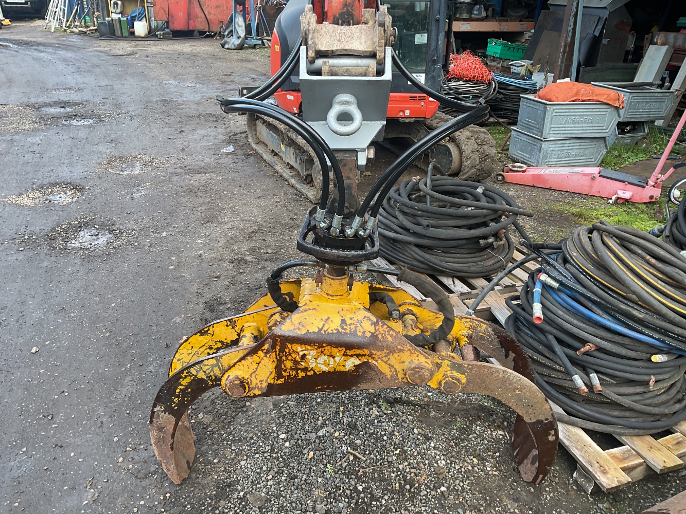

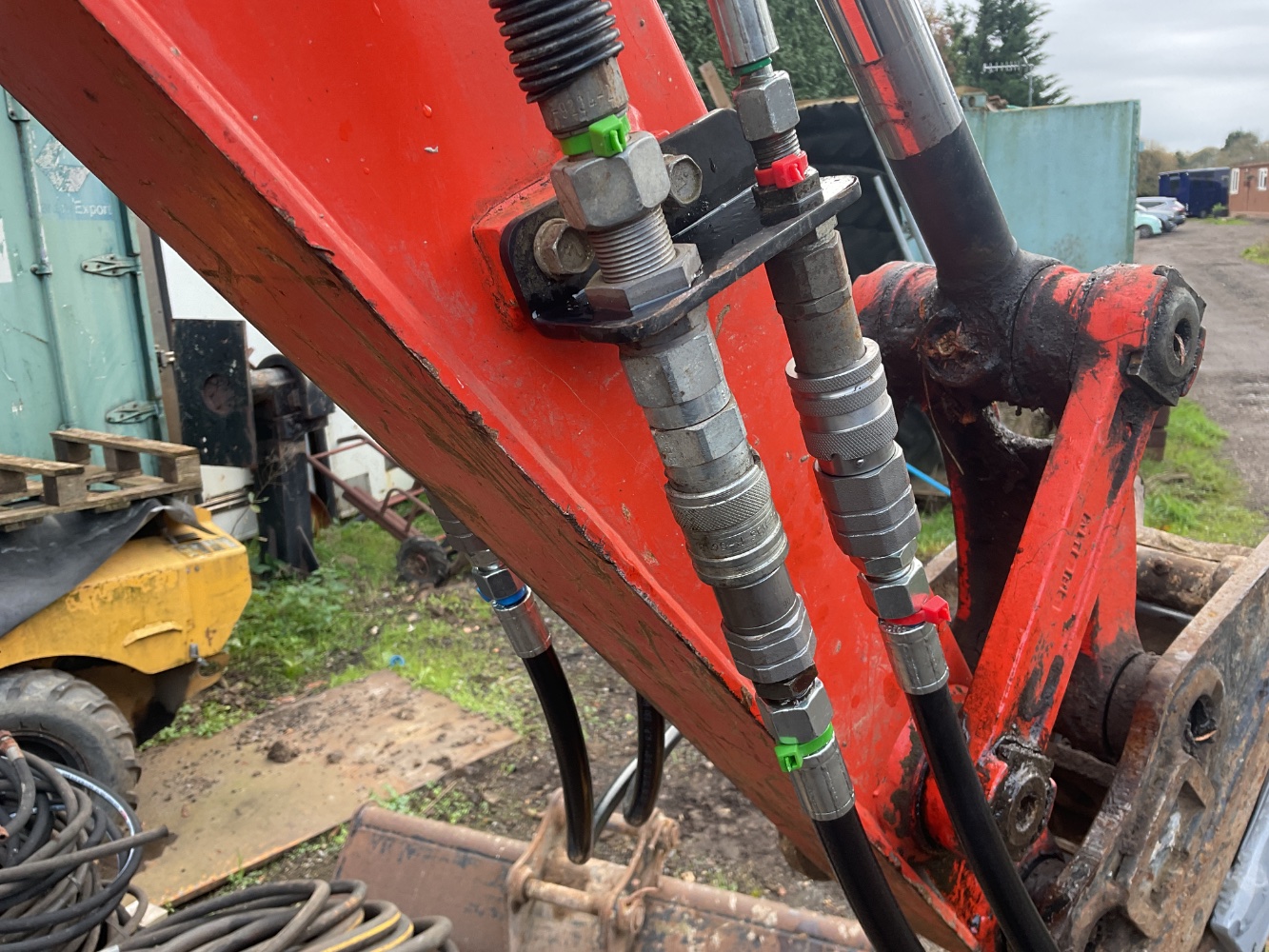

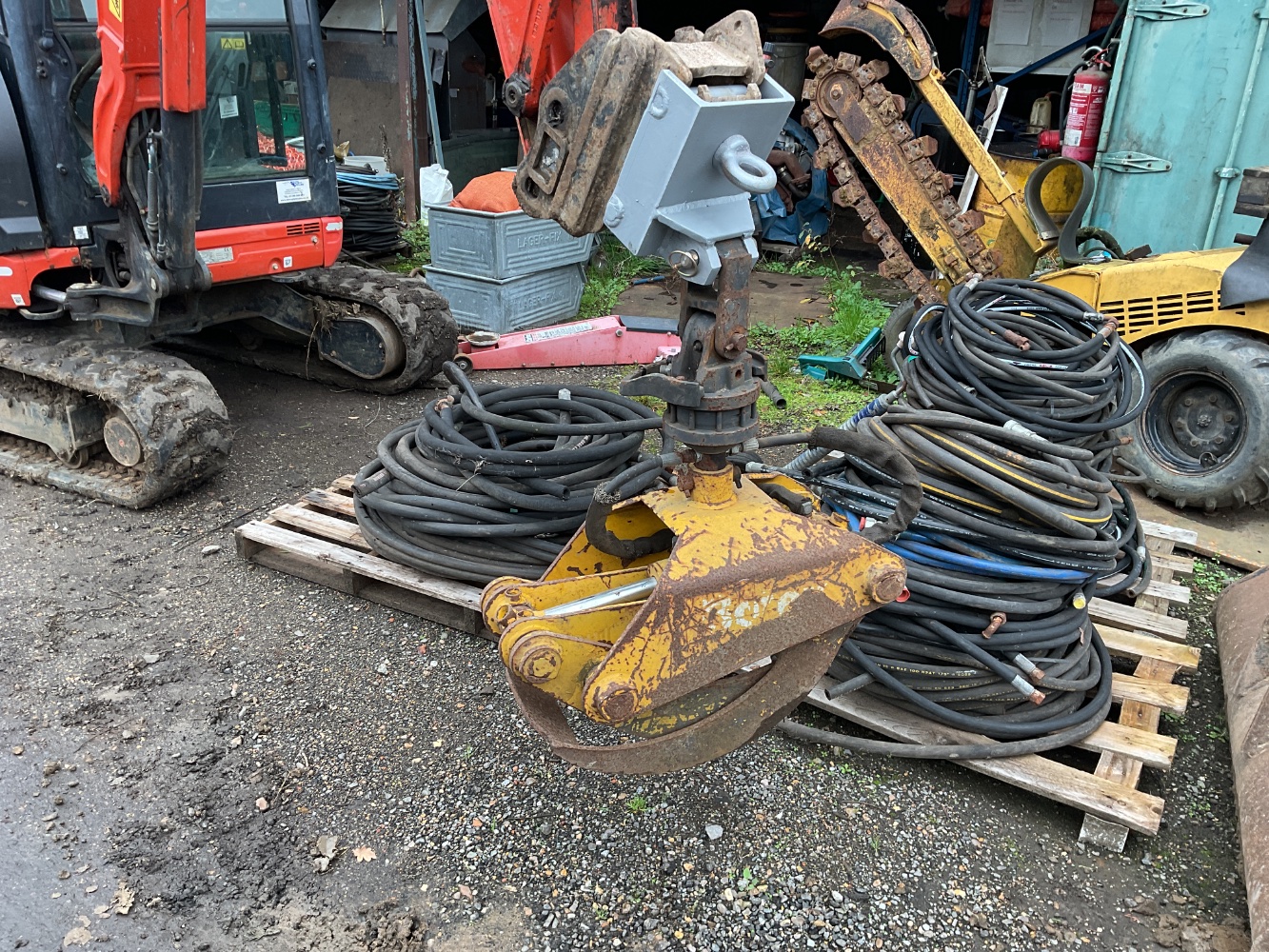

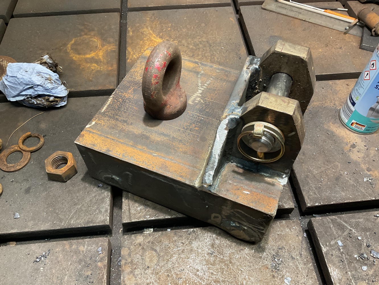

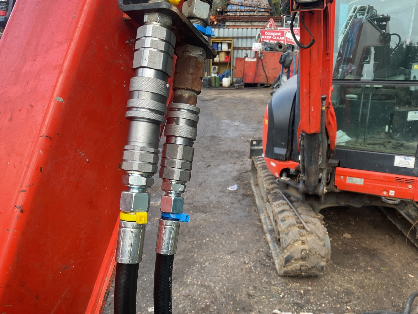

Got a few oddsnsodds to adapt to the excavators, starting with a log grab on Kubota. This is just a hitch adaptor and pipe up job, the machine came with the two extra services for grab and rotate vs just the breaker lines.

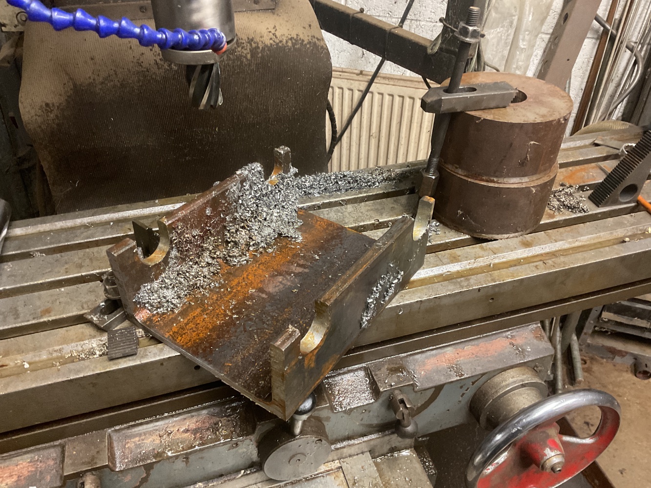

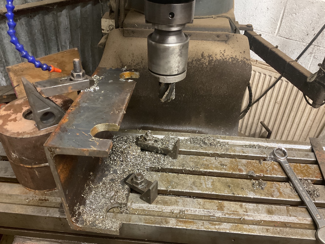

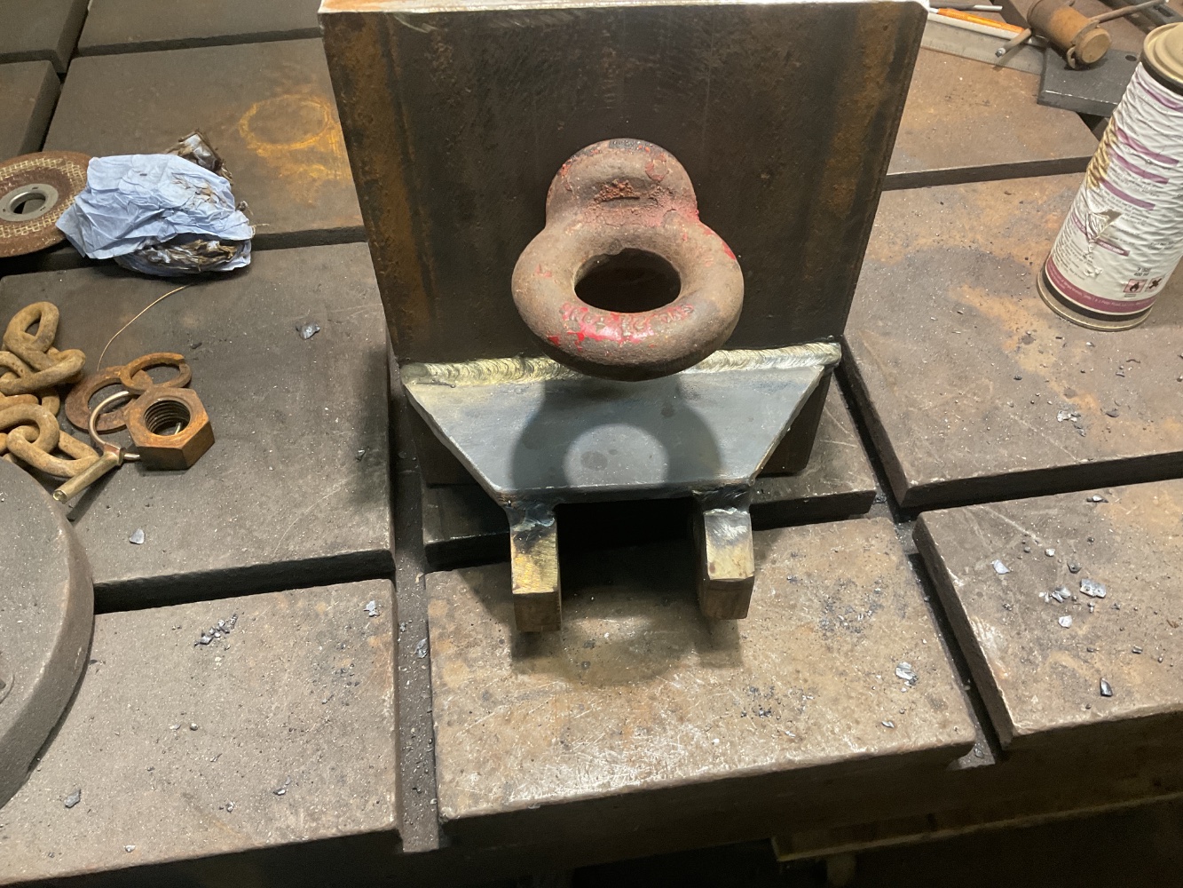

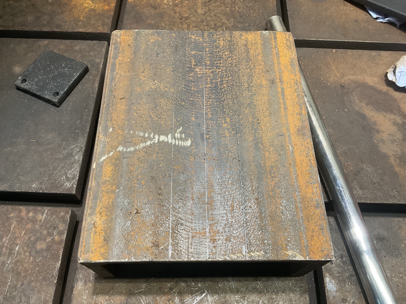

Started off with a lump of 8” wide heavy channel, milled in slots for the quickhitch pins.

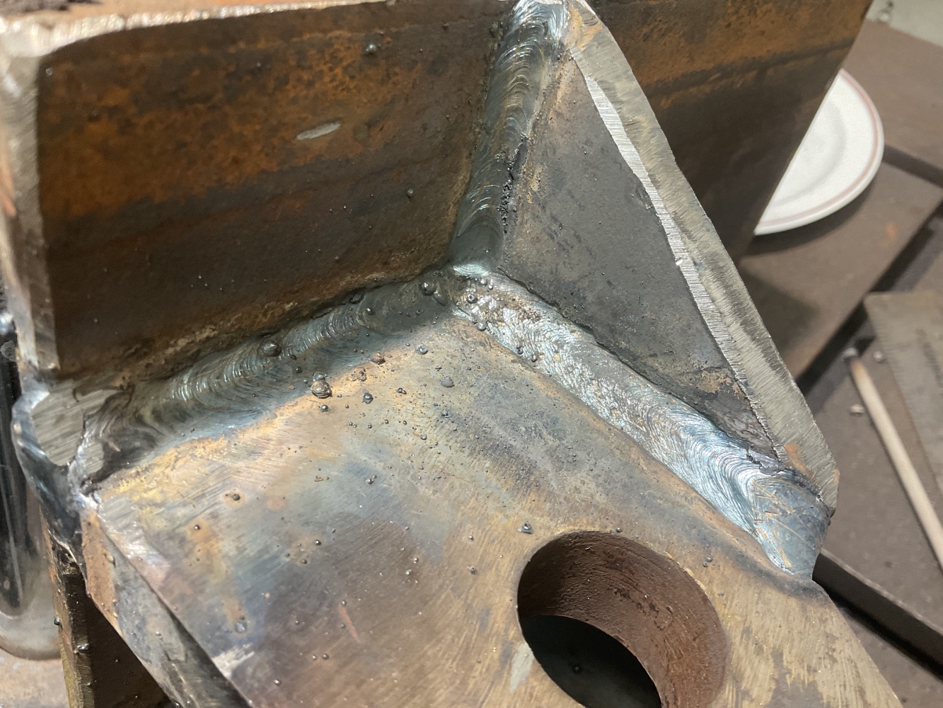

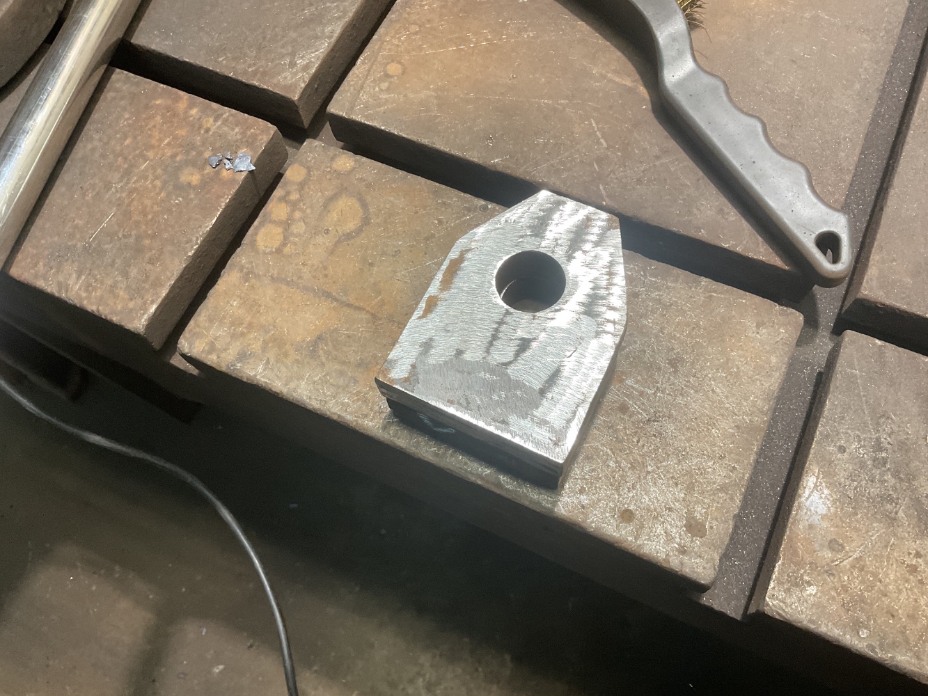

Cut the two lifting eye plates out of some 20mm plate and bored them out to 32mm
Set up the lifting eyes and cross brace.

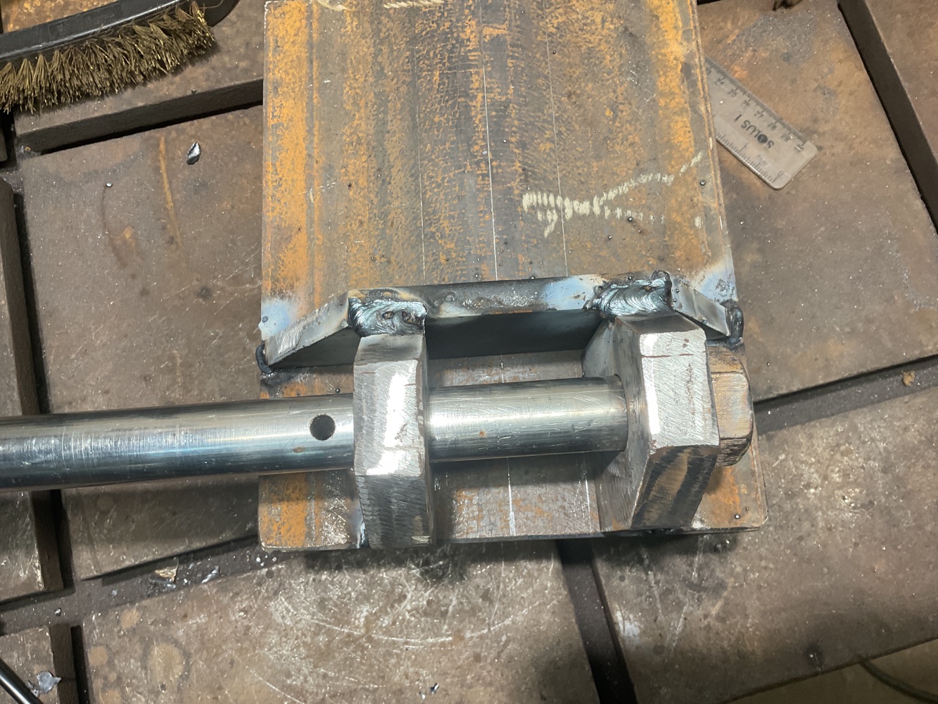

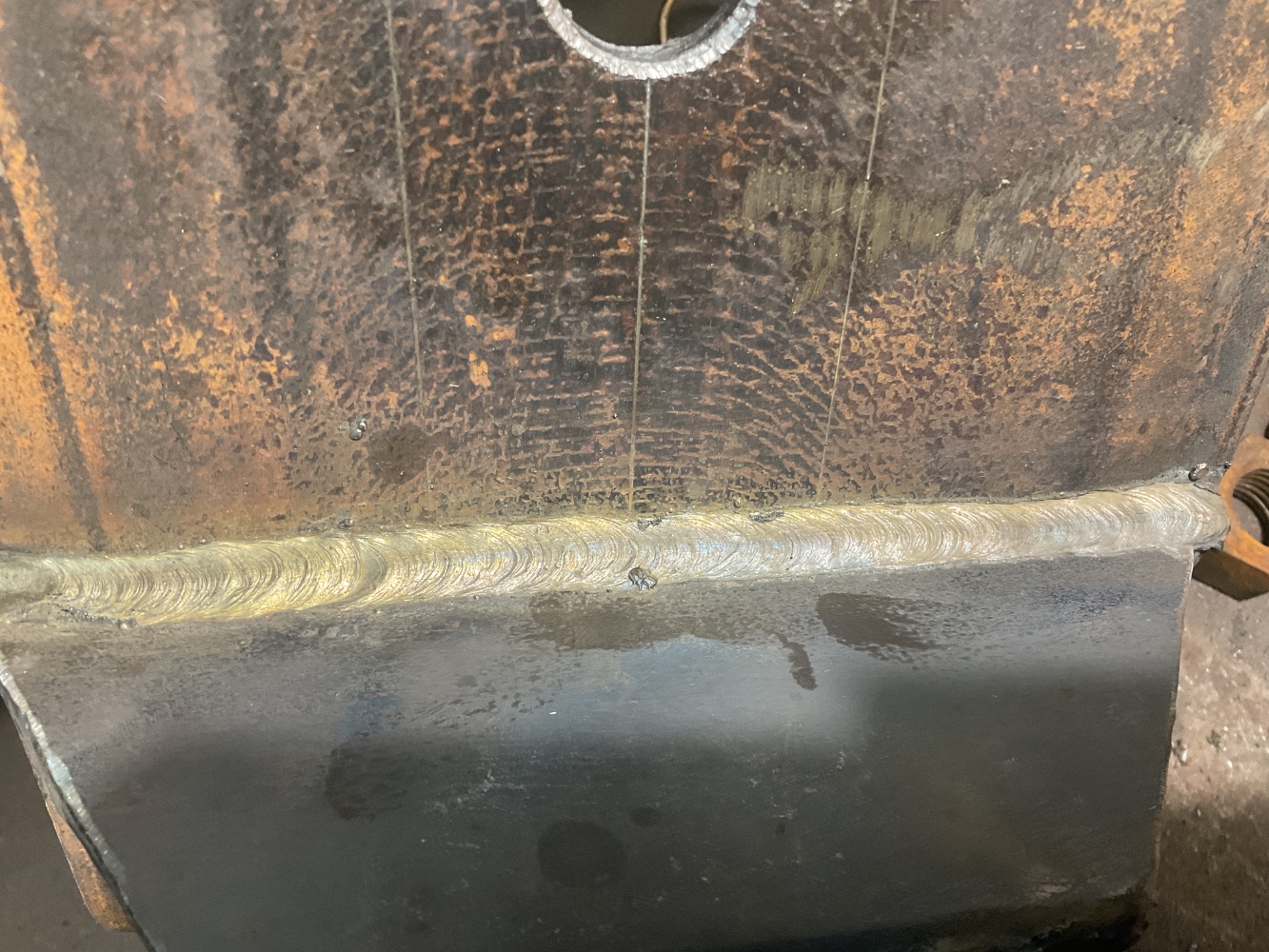

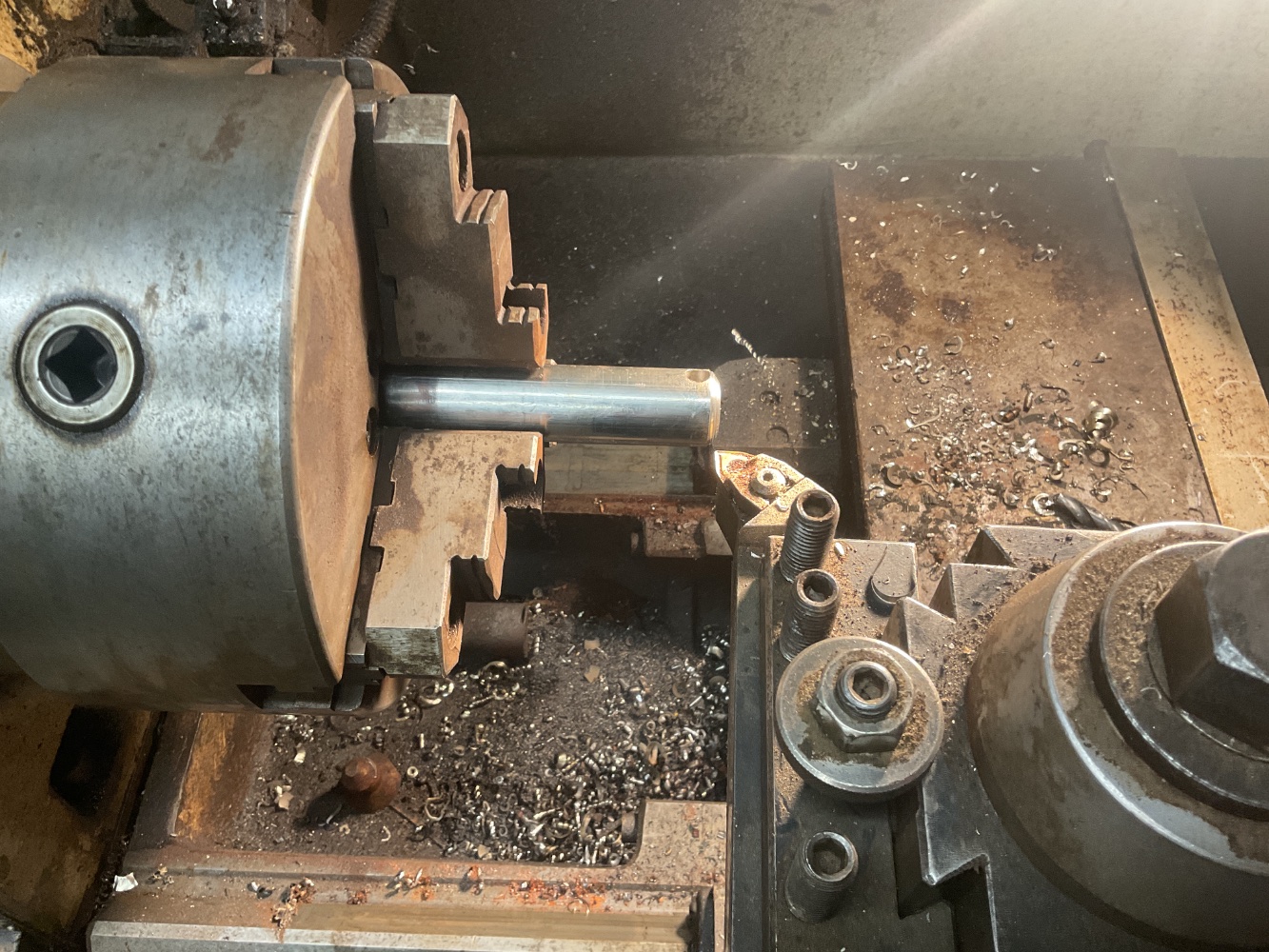

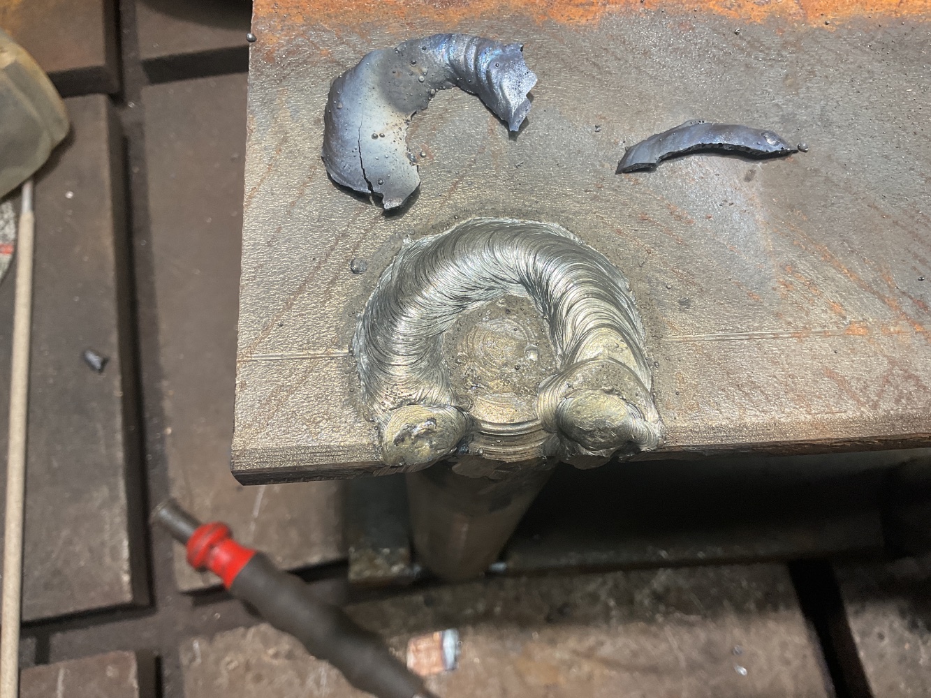

Welded that up along with the pins.
