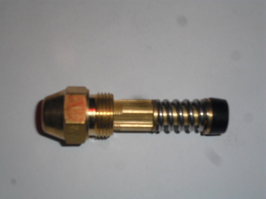

So I've fitted new hoses between the air pump and nozzle and the fuel tank.
Set up a pressure gauge off the back and I can't adjust the pressure above 2.4ish psi that shown on my gauge. The heater tries to ignite but doesn't.
If I crimp the hose from the air pump the pressure shoots up so assume the pump is fine, the issue must be with the nozzle not providing enough back pressure?
Any ideas?
Many Thanks
