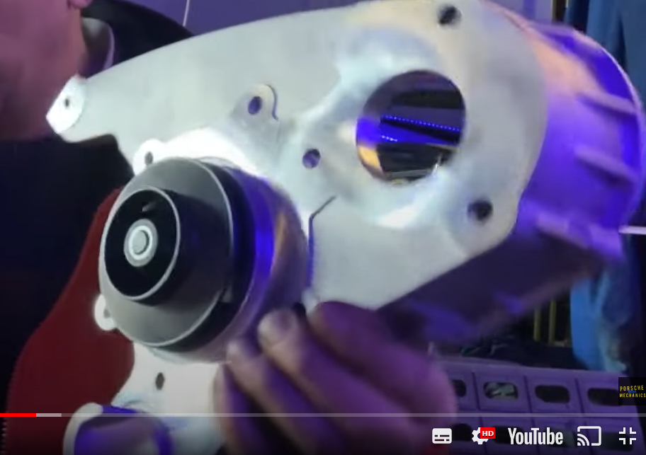

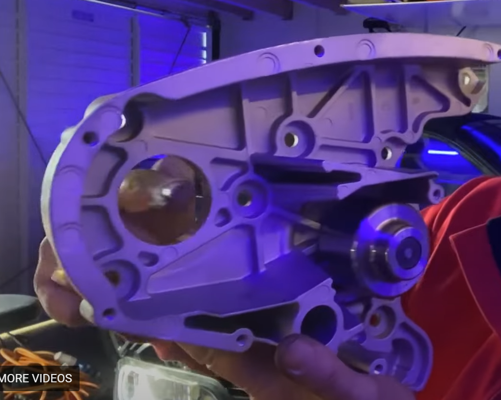

Head gasket problem ?????? Needs checking out doing a wet & dry compression & leakage test , for that's the first place to look when oil or fuel is in the coolant ,I was thinking the same as Julian has pictured. Not uncommon.
Whats the injection system in the head? Could a diesel passage leak into a coolant pathway if its cracked?
Yes, I saw that later - definitely separate, but the pump does seem to have an o-ring seal between its nose and the housing, so potentially a trap for a leak. (Understand what you're saying about the weep hole, and I'd also expect one, but don't know for a fact that there is one.)There is a gap between the fuel pump and water pump, and the fuel pump
Thank you for your post.Just a thought (grasping at straws on your behalf):
I believe the high pressure diesel pump bolts through the water pump housing on these. From what I can tell from photos of replacement parts, it looks like the pump mounting flange and the waterpump gasket share a machined surface.
Brief glimpse at 29:06 here:
Could there be a weep from the pump that is ending up trapped against this face somehow, eventually building up enough pressure to force its way past the waterpump gasket and into the coolant? A crack in the water pump housing that is letting a leak through? Any sign of a diesel or coolant weep where the high pressure pump bolts on?
