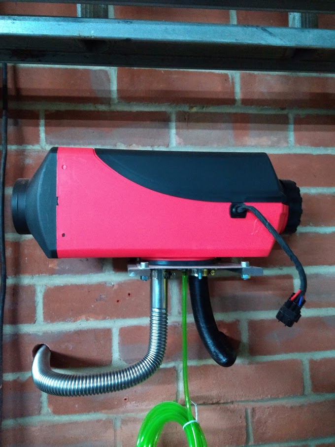

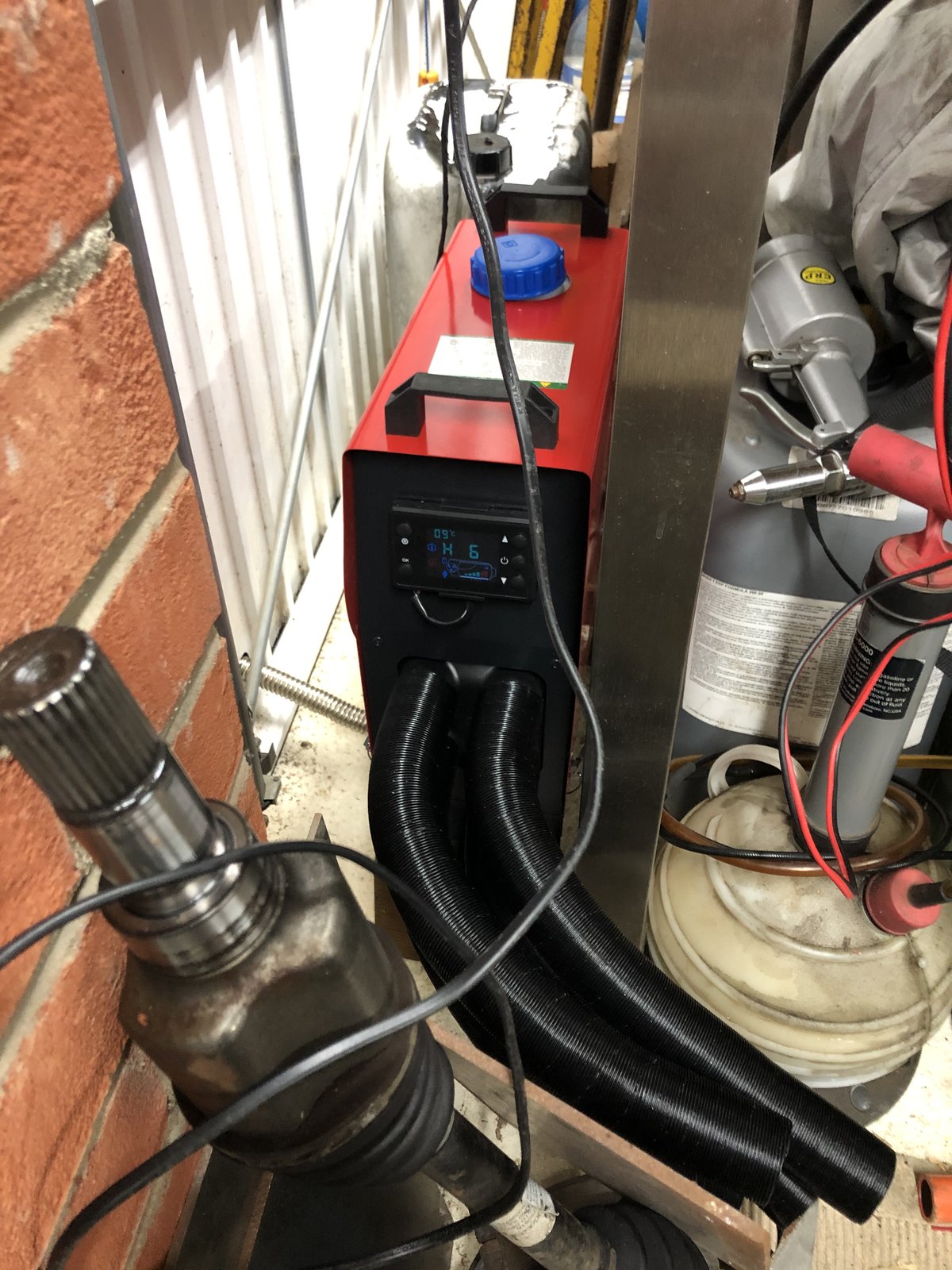

Brilliant little heaters I have exactly the same and keeps my workshop bearable in sub zero temps.
It tends to just run all day, but the supplied tank is too small so I re-purposed an old land rover series one diesel tank (10 galls).
Runs on 30p/ litre heating oil. Probably costs about £1 a day so happy with that.
Good tip about the heater plug spare though.

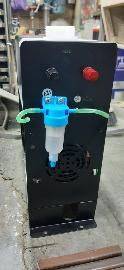

Edit Its best to add a cheapo in line filter as a precaution.
Got mine test fired yesterday

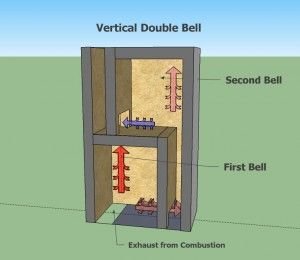

Nothing wrong with the idea, but be wary of an old central heating rad being rusty down the bottom. If it's sound, crack on.Another idea I'm toying with is the heat recovery of the exhaust running through a radiator type setup made copper pipe or putting it through a old household radiator we have as i feel a lot of hot air is wasted through the exhaust and shame to waste it.

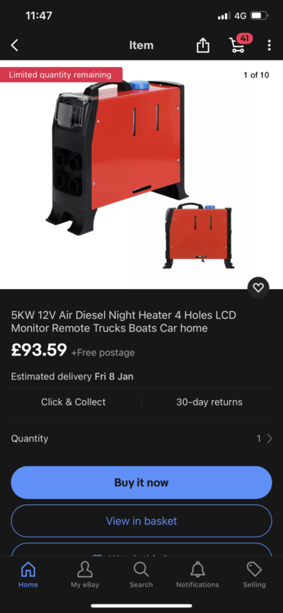

I'm thinking about one of these, where's the best place to get one?

Just bought two of them!
One for the conservatory (currently electric!!) and one for the workshop.

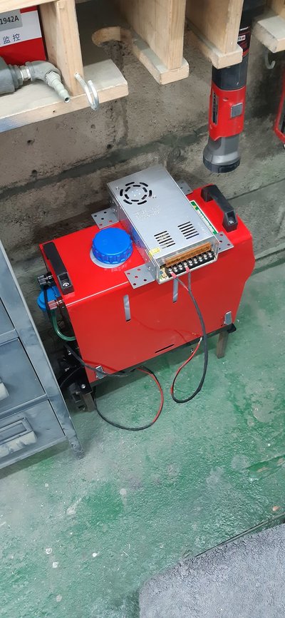

Power supplies now.

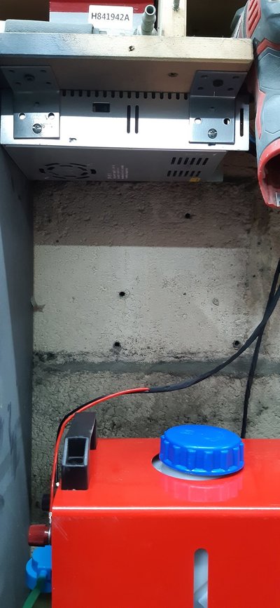

I've bought just one 20A one for now as a try out. In my workshop I'll probably use a battery.eBay, again.
Go for the 20A, (no less).
They need 12Aish at start-up. But Chinese power supplies are... Erm... "Optimistic" in their specs.
Best to feed them through a battery, however, as powercuts can cause them to melt the plastic cover. (They need a "cool down" period)
