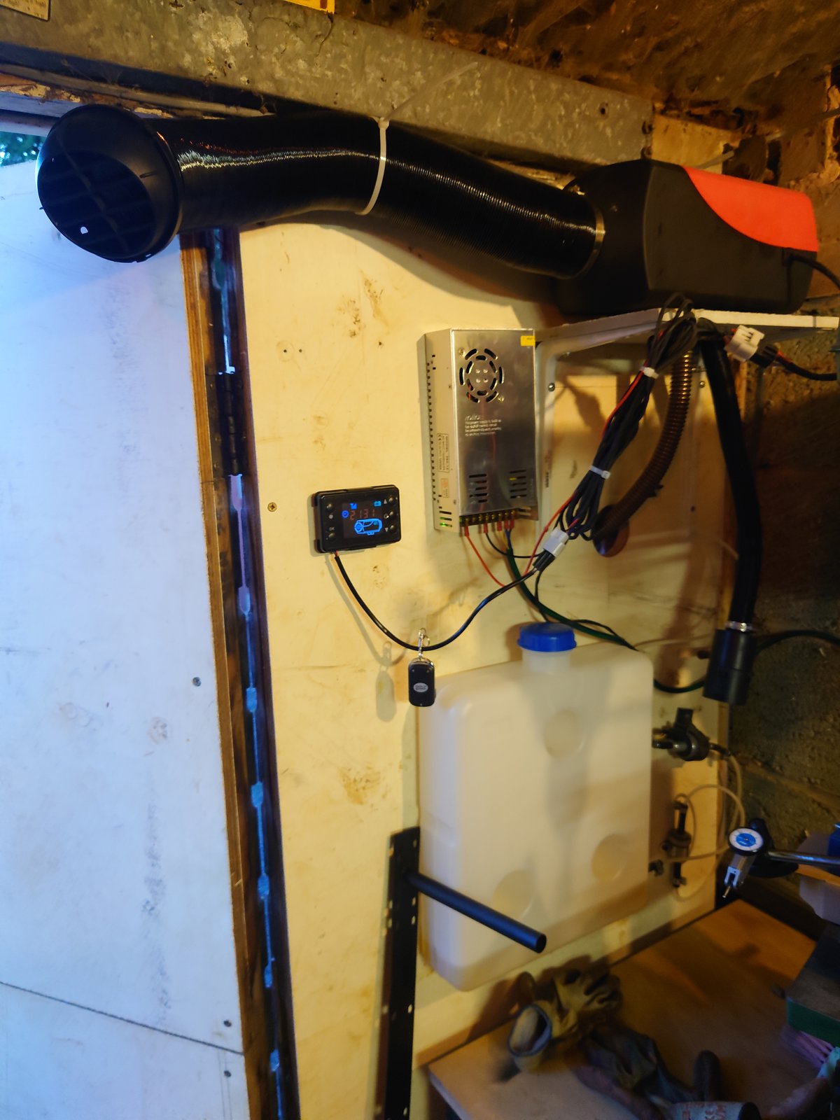

That's the main, big, plastic, inlet - NOT the smaller, metal, inlet (the combustion inlet) - which should come from outside the heated space.
Correct.
The bilges are well ventilated.
Can I ask if it's because it's a semi sealed living space that you don't draw the combustion air from the heated space?
I guess there is a risk of carbon monoxide escaping back into the heated space should there be a sudden power failure...
My unit draws combustion air from the inside space but my workshop has plenty of gaps and cracks to let fresh air in and I only sleep there when she kick me out
it is possible for a fault or failed start to cause exhaust to be emitted from the combustion intake. it is unwise to pipe it anywhere but outside with the exhaust.
Well, I guess it would take the fan to spin backwards? For it to pump it.it is possible for a fault or failed start to cause exhaust to be emitted from the combustion intake. it is unwise to pipe it anywhere but outside with the exhaust.
There are failsafes, but it would probably be vented out the exhaust, UNLESS, you pulled the fuse, stopping it suddenly, not letting it go through its cooling cycle more importantly.
Fuses and trip switches are a no no, if you follow the manual, but, the supply cables do have their fuses in their.
For over short circuiting if the heater plug goes pear shaped, to stop the cabling becoming a heating element, I guess.
Certainly doesDid that make sense?

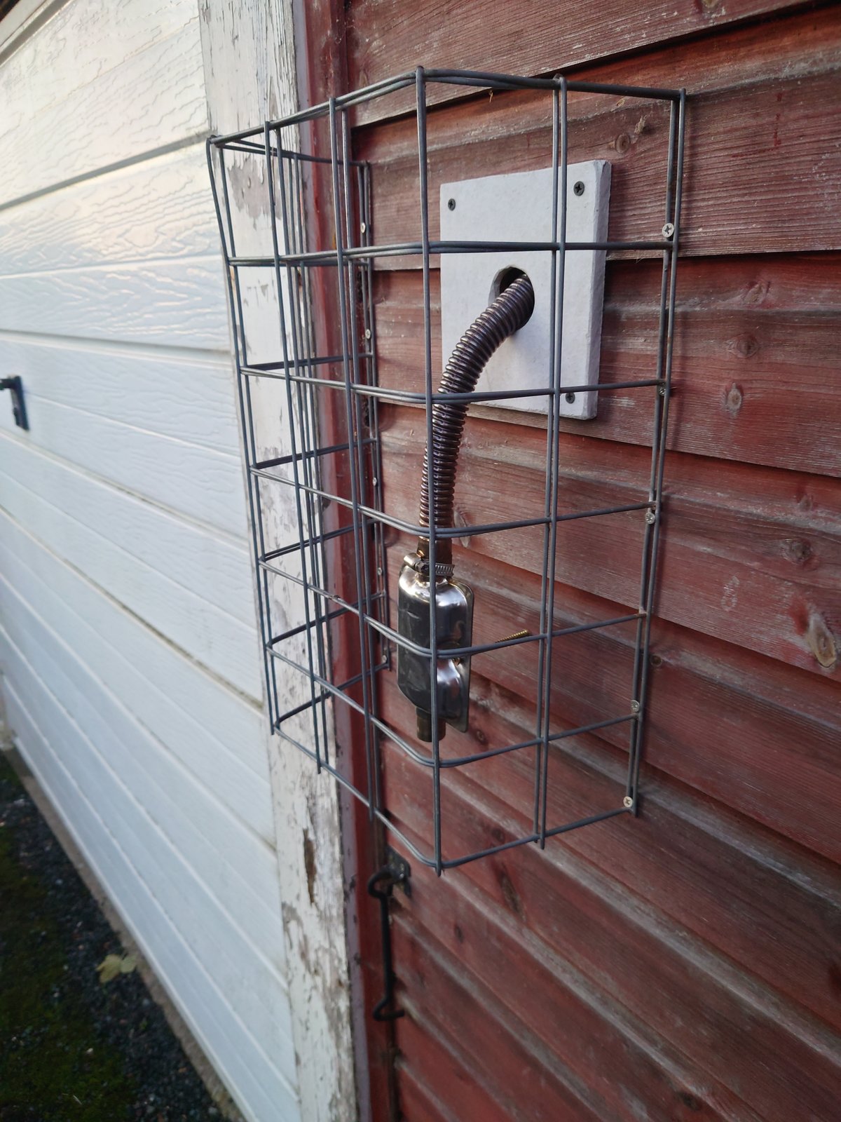

Hi mate,
That silencer will get to between 350 and 500° s apparently, wooden shuttering, I like the wire box, but please attach it to the wire frame with wire, to avoid the wood.
Avoid it sagging, fire hazard.
Just my reccomendation....
I'd stick an insulated metal plate behind it for peace of mind.
Just me.
Is that your workshop?
Burnt down workshop = bad day.
Just my thoughts....
Good, I have a very healthy fear of starting fires, well except the woodburner.Don't worry, the white coloured board outside is an A1 rated fibreboard with a massive clearance behind it and the unit mounting 'shelf' is the same. Nothing combustible in contact with the pipe, the inner skin on the wall is fireproof fibreglass coated ply again with a heatproof spacer
