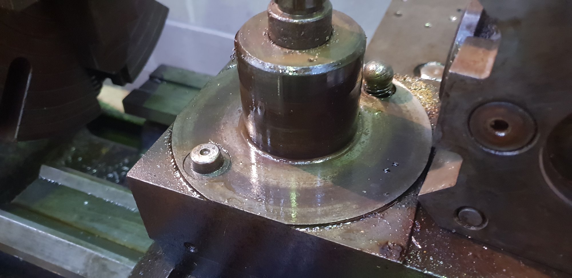

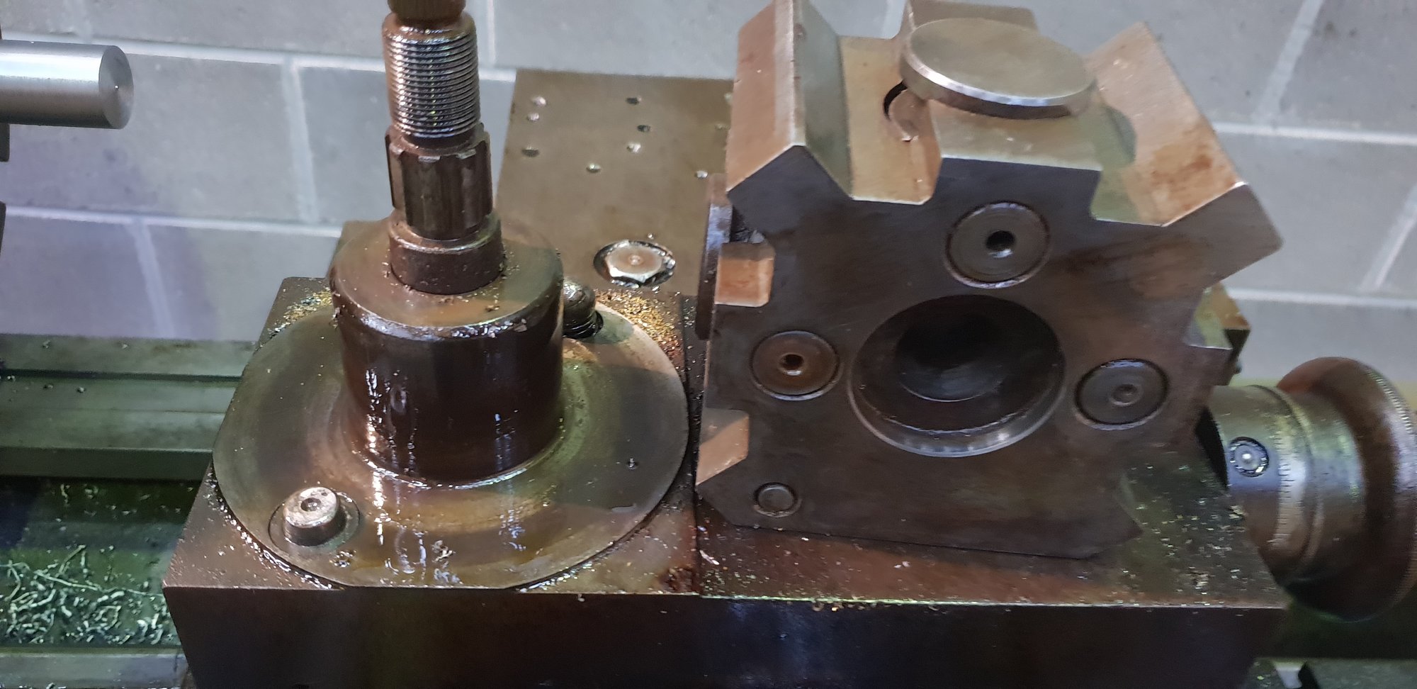

All quick change tool posts add flexibility to tool holding as they all add overhang
Yes. And look at the old boys: the Gibralter toolpost replaces even the top slide for maximum stiffness. Robin Renzetti and Stefan Gottswinter have also done the same recently.
I thought that might be the case. Its a big lump, like the bit of steel I have
