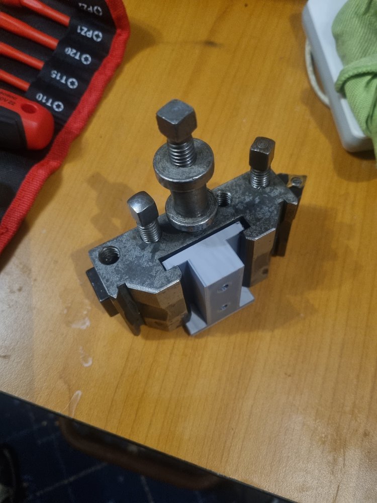

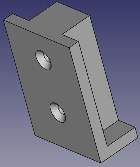

I am looking if anyone can re work this STL so the slot part is 42mm ID and 7mm thick and 50mm tall.
thanks in \advance
thanks in \advance
That will do for me. Cheers.Why is the non-holed side of the angle so wide? If the Dickson holder drops over the T, the base does not need to be wider than that. Saves on filament. It looks like something that someone has fabricated out of metal angle and then 3D modelled rather than something that has been designed.
A chamfer on the top to aid/guide the holder into place might be a useful addition (subtraction). Lose the two countersunk holes at the sides and put them vertically above each other through the T itself. Then the whole thing sticks out less from whatever it is screwed to (and the screws are going through thicker plastic). Less material again for no loss of function. As the holders themselves are dovetailed, could the 3D print not also be dovetailed? AIUI, that might give more options for orienting it when printing - you can print an overhanging slope but an overhanging vertical surface is harder.

This is how it could be simplified:-
It is 30 lines of OpenSCAD with all dimensions customisable.
Its printing now. 1 hour 20 at fast speed. 3 hours at posh speed.Why is the non-holed side of the angle so wide? If the Dickson holder drops over the T, the base does not need to be wider than that. Saves on filament. It looks like something that someone has fabricated out of metal angle and then 3D modelled rather than something that has been designed.

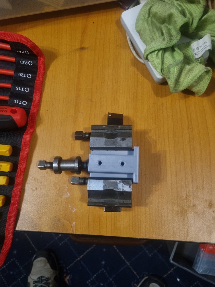

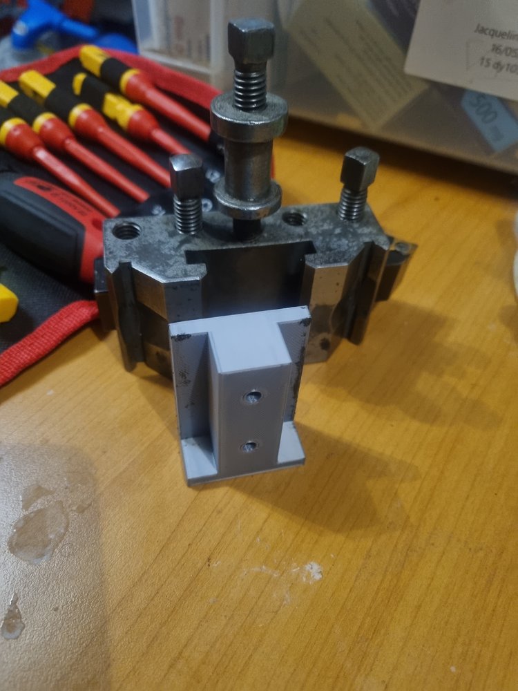

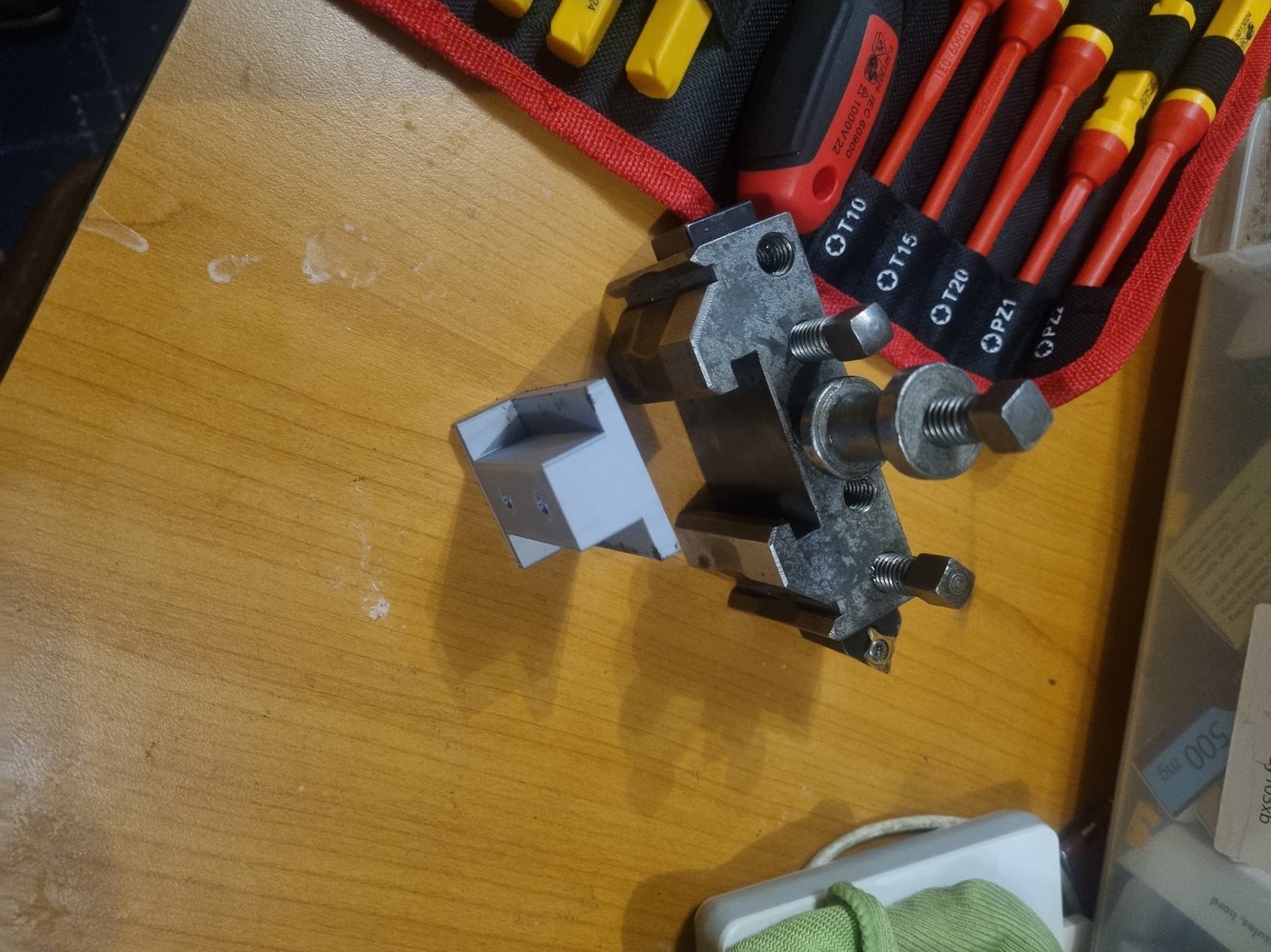

I went into the garage today and decided to mount the tool holders as I used the lathe a lot last week and kept loosing them in the mess........but could find nothing on thingiverse so sulked for a few hours.

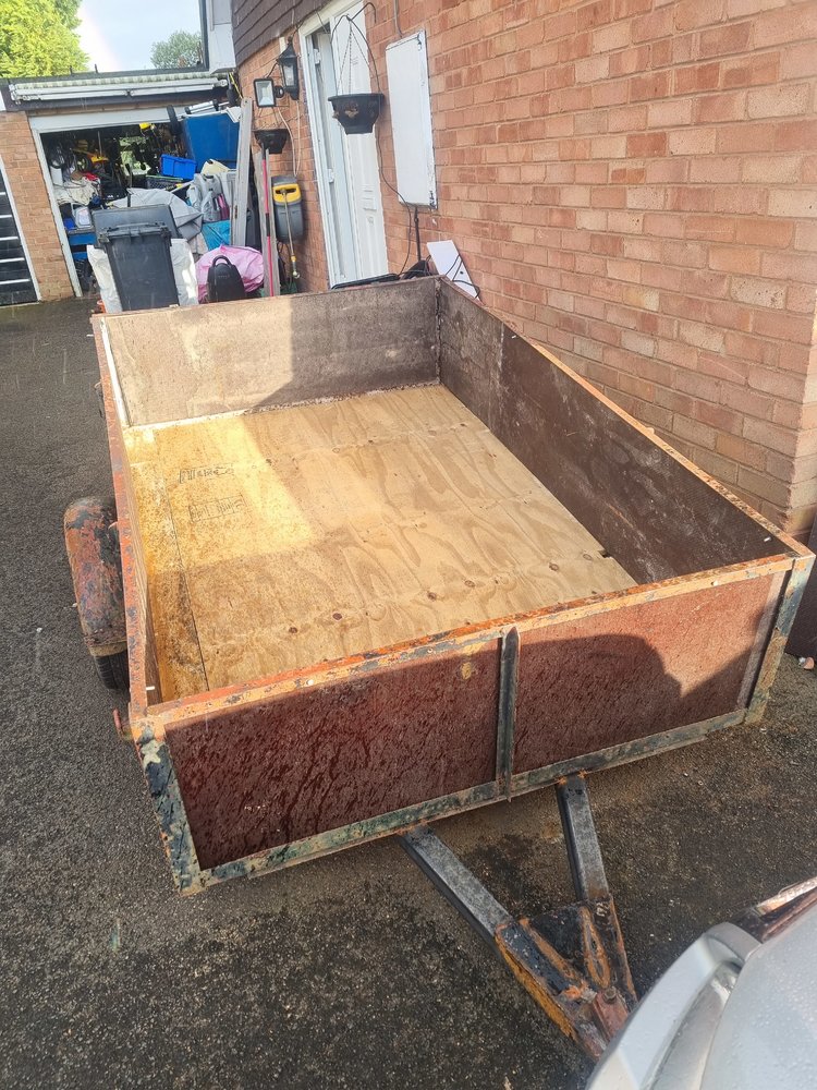

So gave up and finished revamping my trailer.
At least I got something done today.
