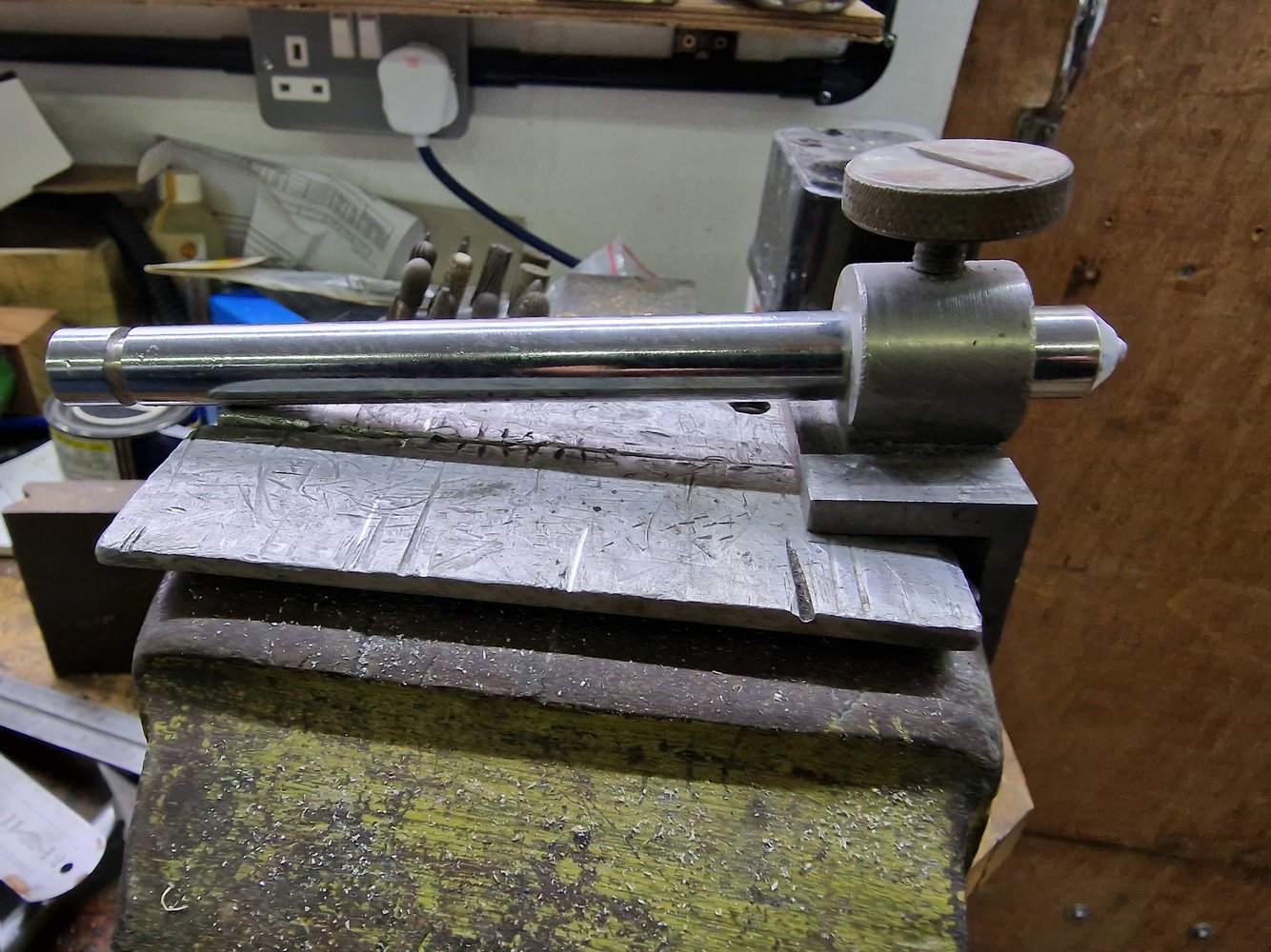

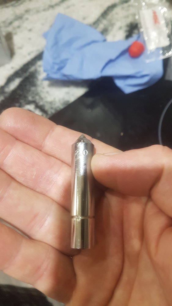

I just purchased a diamond dressing tool its soo short do they sell holders for these or is it suppose to be used short to get the wheel true

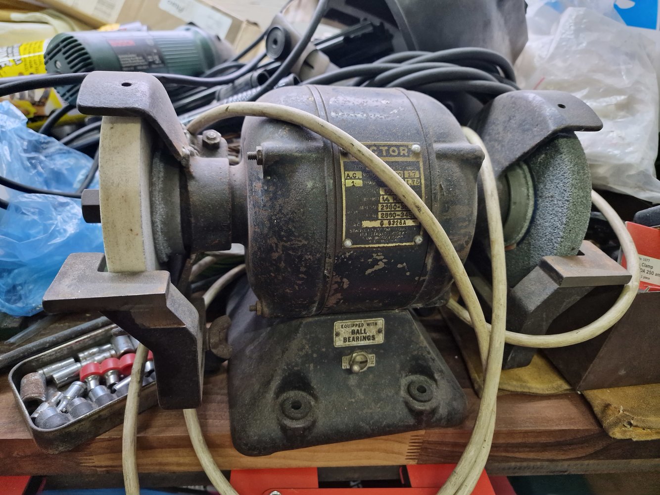

thanks so I should not have purchased it and just kept on using my regular one for dressing my bench grinder wheelsSee that groove, for a clamp screw, perhaps?
If you're using it on a surface grinder you'd stand it in a block and bring the wheel down to it. If you're trying to sharpen an off-hand grinder then you'll still need something to allow you to sweep the face of the stone without making grooves.
It does but then I had the same luck trying to true the original wheels.i have a couple of other dressing tools, my old wet tile cutter blade does a good job also. that does sound like a wobble wheel Kram
