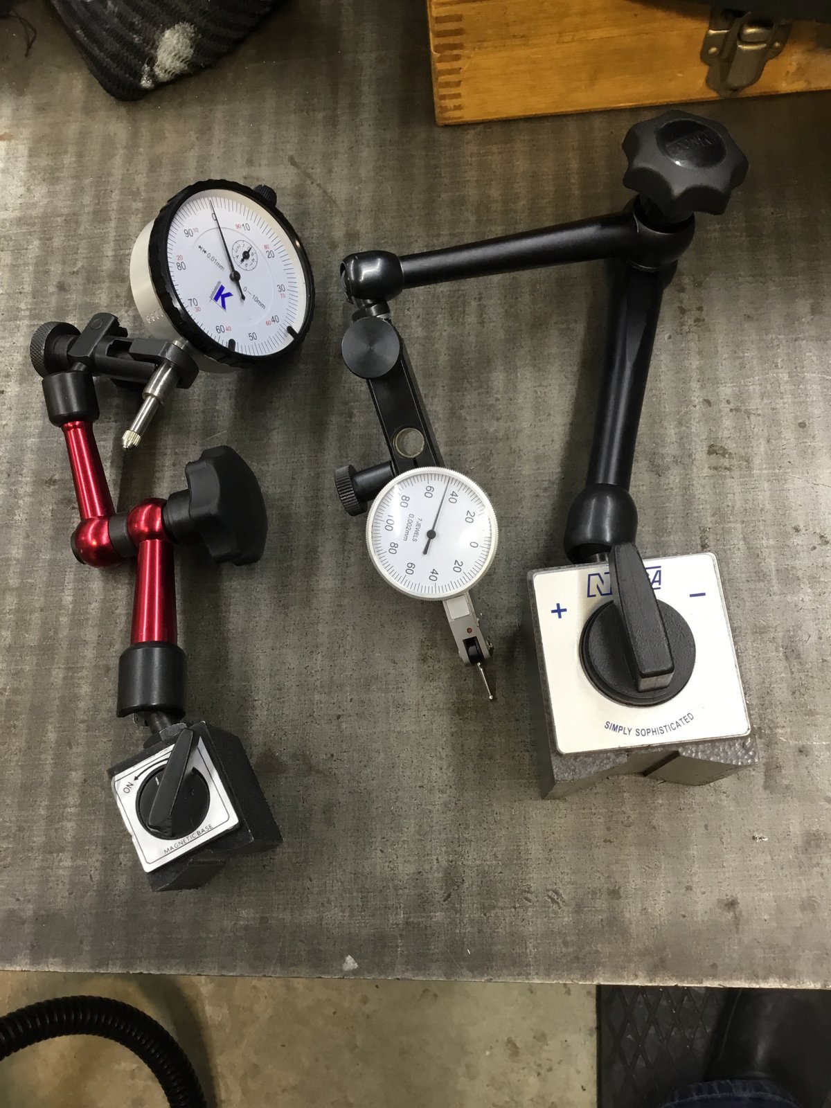

I’ve just picked up a 2nd Noga Mag and Cine arm. Lovely bit of kit. I also have a cheap (£12.70) mini version copy.
I bought it to hold a little perspex screen, at first it was stiff and none compliant, but its freed off and I would say its not far off the Noga
That noga is a lovely bit of kit. Dear new over here compared to the States. if I remember correctly they used to be made in Israel.
