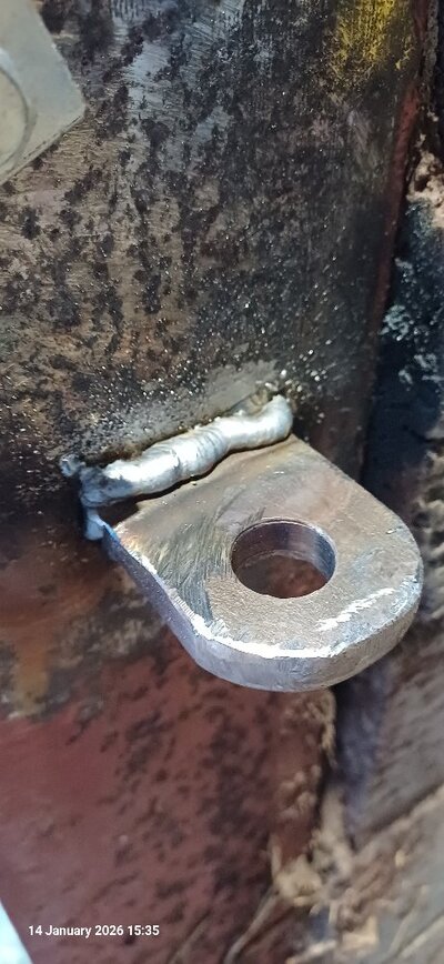

Good evening,
Obviously, I'm very much a beginner welder. I've done small welds and they're not too bad tbh but I'm making new gates and hanging them to large H beams on our farm. I've cleaned the materials all fairly well and I've adjusted voltage and my wire speed etc as it's thicker steel than I'm used to and I want good penetration, but I'm making a complete mess of it! This is incredibly frustrating! Is it gas related, too much wfs or there could be some wind preventing gas. My machine was set at 19.2 volts, wfs 5.8 mpm. Co2 82% Argon 18%. Set at around 10-12 litres per hour. Any constructive help/critisicm is appreciated.
