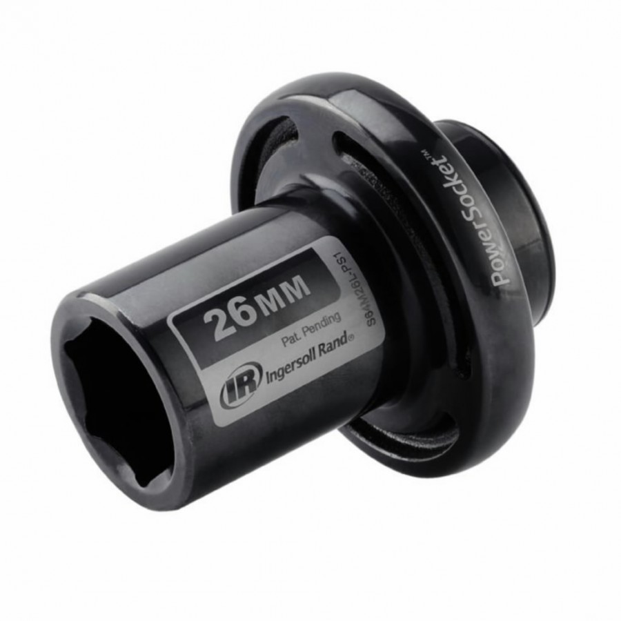

I didn’t think hipsters used impact guns!!IR make them with a heavy ring around it for even more extra inertia:
Notice its not a solid ring, I think it's designed to have a tiny bit of spring between the socket and the weight, presumably quite carefully tuned to give the highest peak torque on each impact.
No good where access is tight though, which is basically anywhere but wheel nuts.
