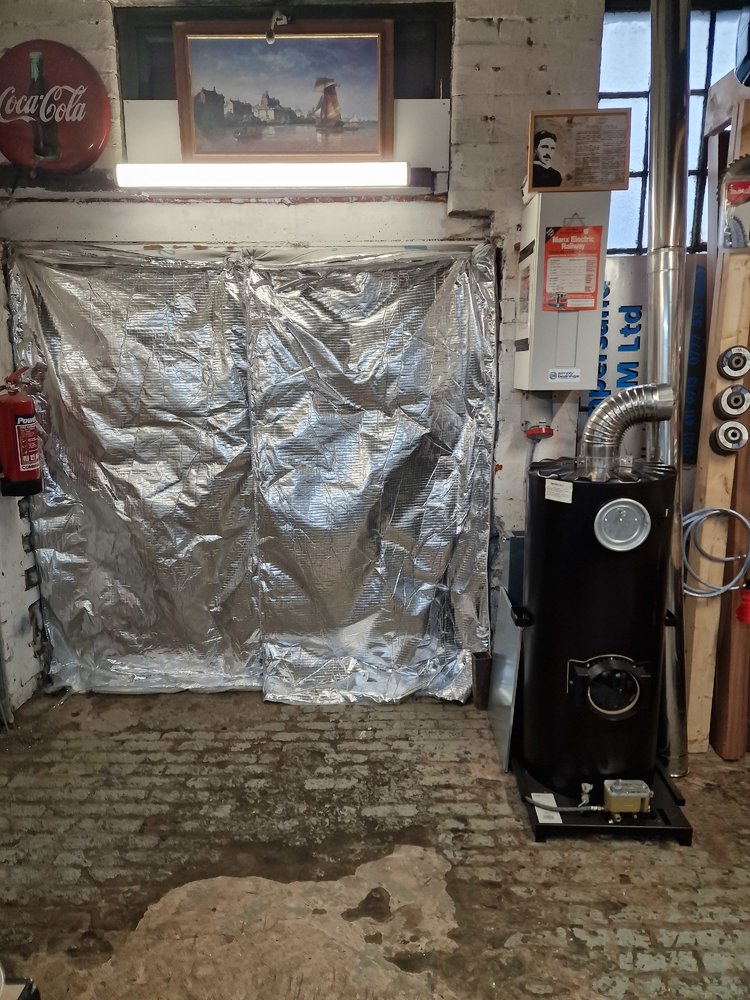

A roll of that multi-layer insulation blanket cut to suit to make curtains for the door and windows will keep things nice and toasty I reckon. Just got to order a stove top fan and I'm winter ready.I found that lighting was best with the reg set to 3, tip one measure of unlit meths into/around the central tube, light a second measure and tip it in. Kettle on, make a coffee, boot up the computer, close the choke and the flame turns blue. The only thing which took some time to set up was the damper weight to get it to the 'just so' spot.I have one here in London, and a truly excellent device it is.
Trick is to light the thing on No.1 setting on the Toby regulator, and use a single sheet of blue roll soaked in meths as the ignition mainstay... light a teaspoon full of meths in the special spoon provided, and pour in after the blob of tissue has been dropped in just by the central flame tube.
Sometimes necessary to leave the porthole door slightly ajar to minimise draught in the initial phases.
A simple clockwork timer helps, set to 12 minutes, by when the rich mixture control can be pushed shut, and a perfect blue flame will be established.
