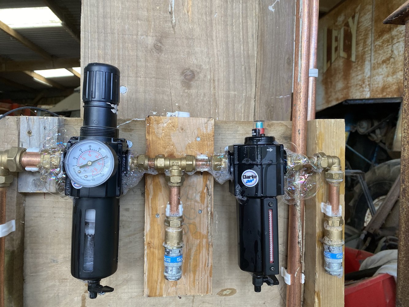

thought I’d got my airline leak free, couldn’t hear any hissing, but it is losing 150 psi tank pressure to 100 line pressure in about four hours.
a bit of water and fairy liquid tells me I need to install Dowty washers. View attachment 290745

@Miranda Ive found threadlock best for air fittings. Just give it 5 minutes before connecting air.
Plenty of PTFE cured that issue with mine, or as Kram says maybe thread lockCompression fittings are fine. The leaks are all in the 1/2 bsf into the filters everyone leaking.
Yeah, dowty washers required here... but you already know that.Compression fittings are fine. The leaks are all in the 1/2 bsf into the filters everyone leaking.
