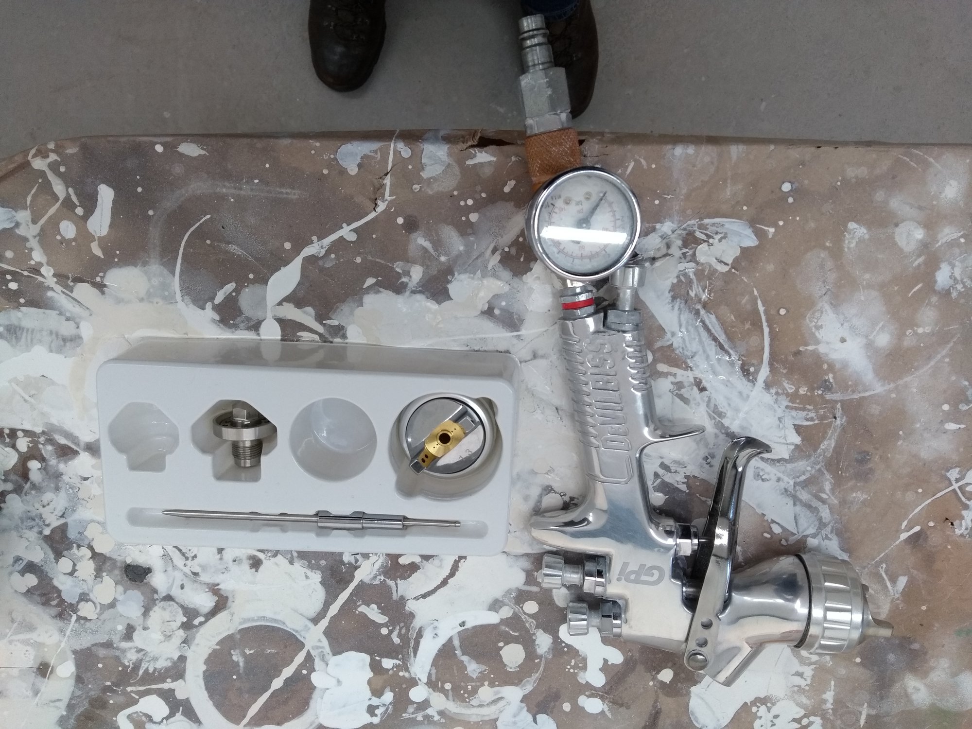

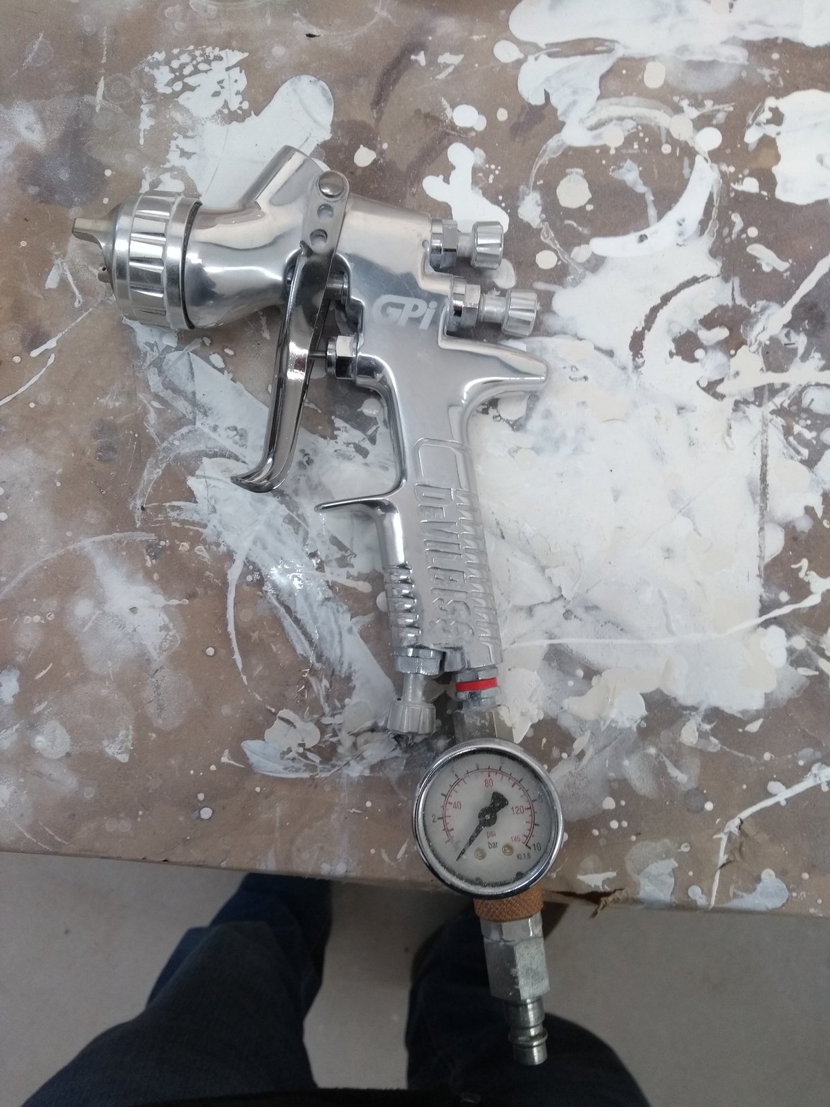

Not a really in depth review. Been doing some spraying with my GPI 1.4mm and it's a fantastic gun, would highly recommend one.

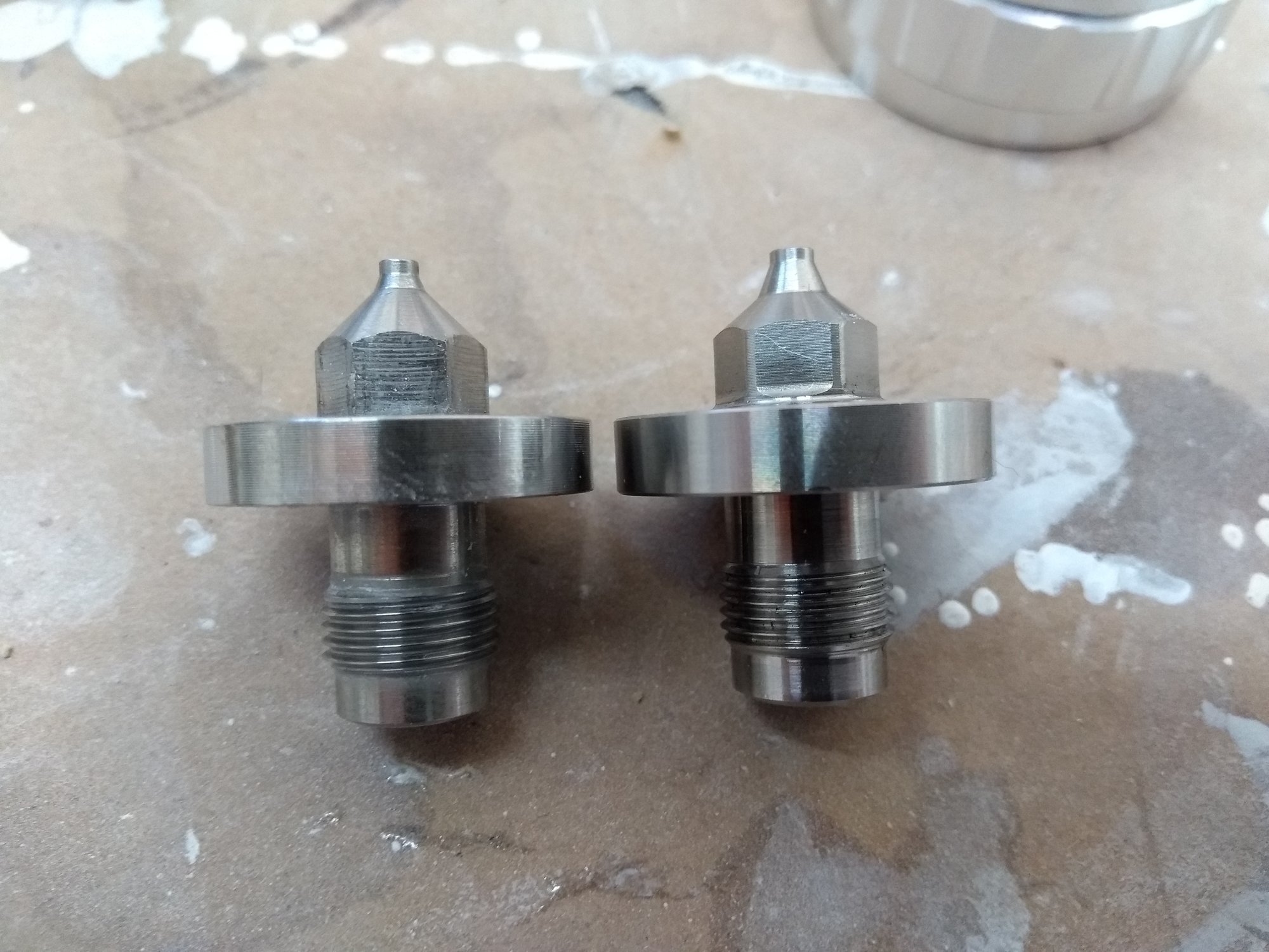

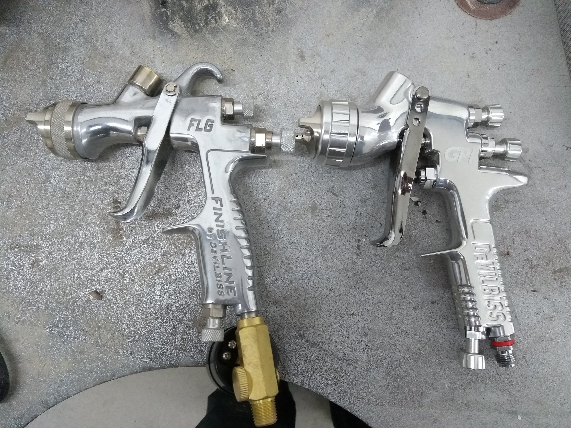

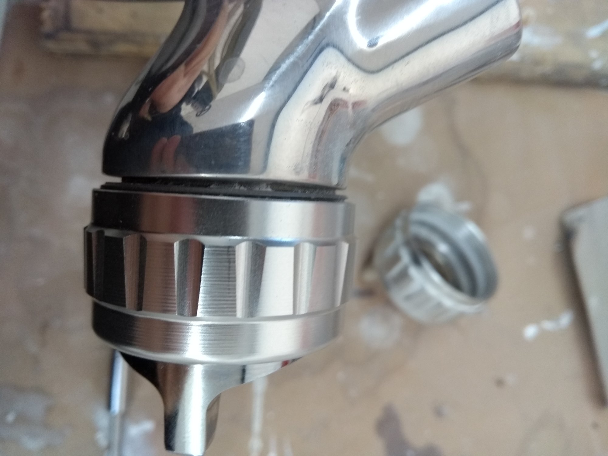

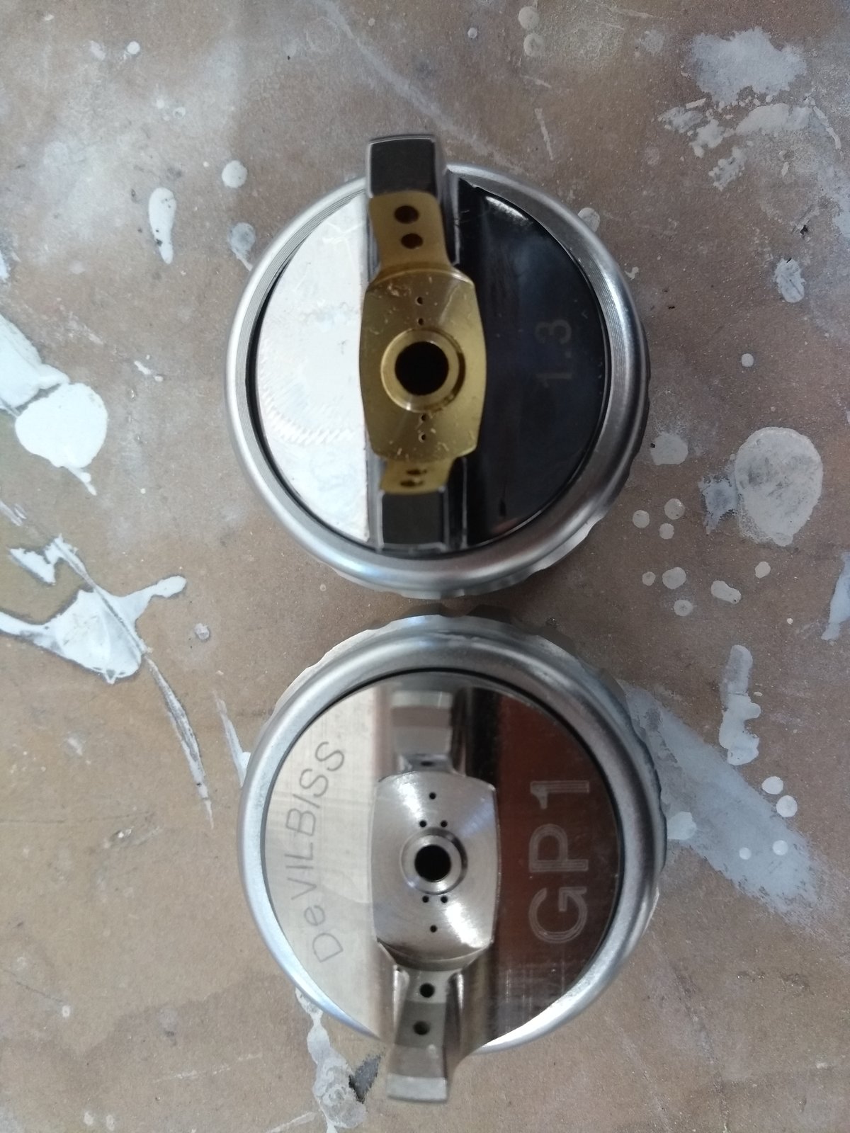

One reason why I got one is I thought along with the 1.4, 1.6 and 1.8mm sizes I might be able to use the caps available to the GTi pro and lite as the GPI is almost identical to the GTI pro body, but unfortunately Devilbiss have made some changes so you can't, or not easily. The GTi needle is thicker so doesn't fit but you could machine it down if really keen. The air cap doesn't quite wind up tight so would need a bit of work to get it to fit also.
Some pics of the gun and comparison with a 1.3mm GTi setup.
