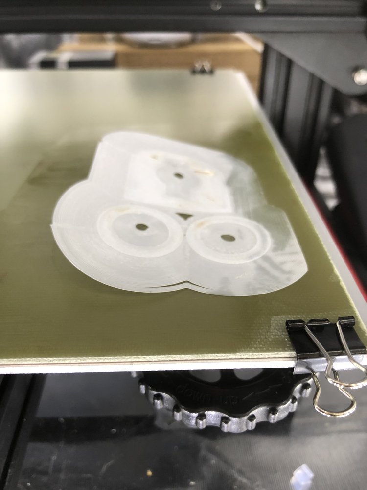

I use 50/50 diluted pva (ie wood) glue. Paint it on and it'll just wash off if required.Just been over to Tesco for one.. HOWWWW MUCCCHHH? £2.36 for a little Pratt stick! I should have gone to the Pound shop earlier!
I used to use hair spray but I lost the can. I was ordering some filament and thought blow it let's try 3D lac.I use hairspray with very good results (exclusively with PETG).
I just grabbed whatever they had in Poundland. Because I’m worth it.

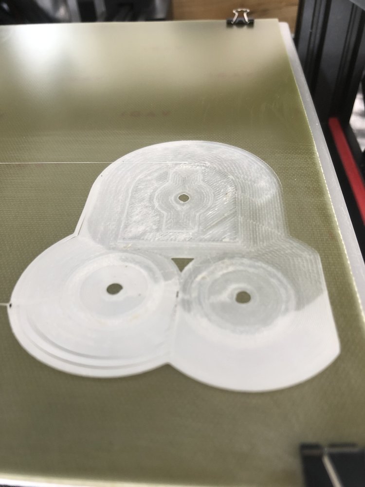

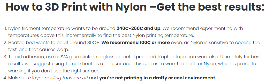

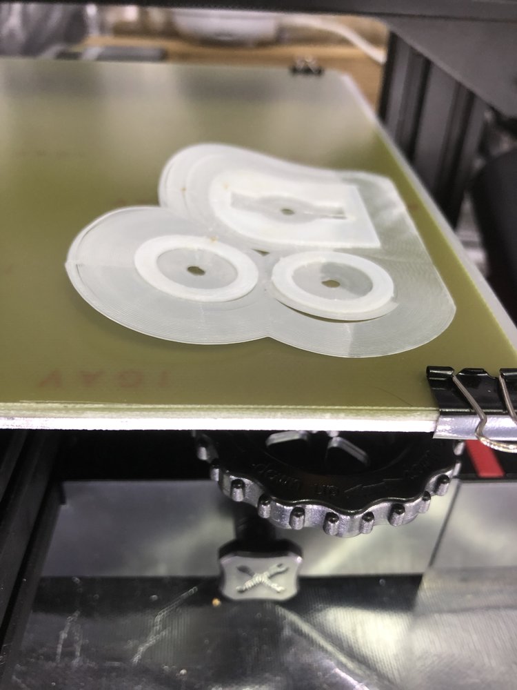

I've never tried Nylon, but won't it be very prone to warping due to the high temps involved, so will ideally need a heated enclosure?Looks like the PCB is warping with the heat, so may be that causing all the detaching. It is interesting that in all cases the right hand side, nearest the edge remains attached.
That issue of the brown marks and the "flash" is present on every print so far. I put the brown mark down to contamination from the PETg, but it is the same every time.
Might struggle for that bed temp on a standard Ender :/

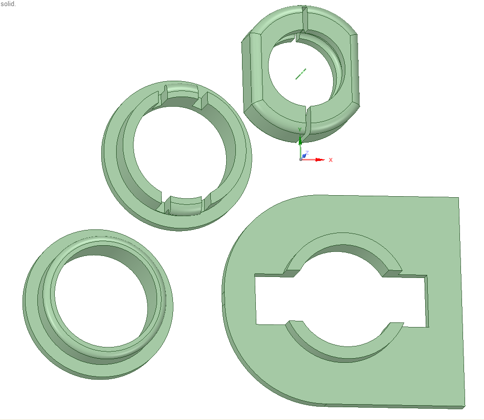

Possibly something to do with wall thickness, and infill (I'm assuming you're going for 100%?), so the slicer is rounding to the nearest nozzle width/stepover.Still playing with these bushes and have now made the full set of CAD files. One minor irritation that I can't work out for now is the ID of the bushes. It is supposed to be 16.3mm yet comes out at 15.90. OK, easy to sort and that dimension was increased in CAD by 0.5mm. The mystery is that it produced no change whatever in the printed ID?

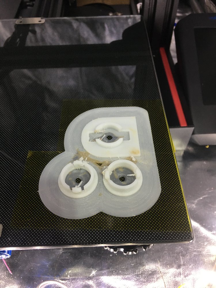

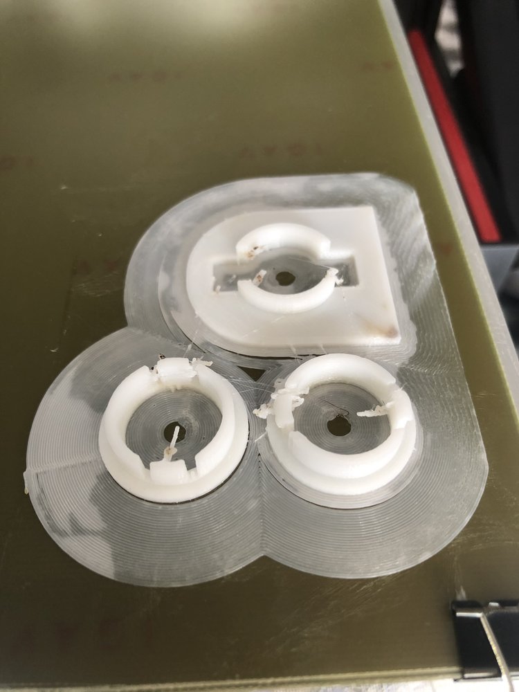

The squared off bush took some designing. I made it from 3 separate rings in the end. I have yet to test print one of those but I may do over the weekend. My test print tonight detached from the bed halfway through again, but at least I was able to confirm that the ID had not increased.
