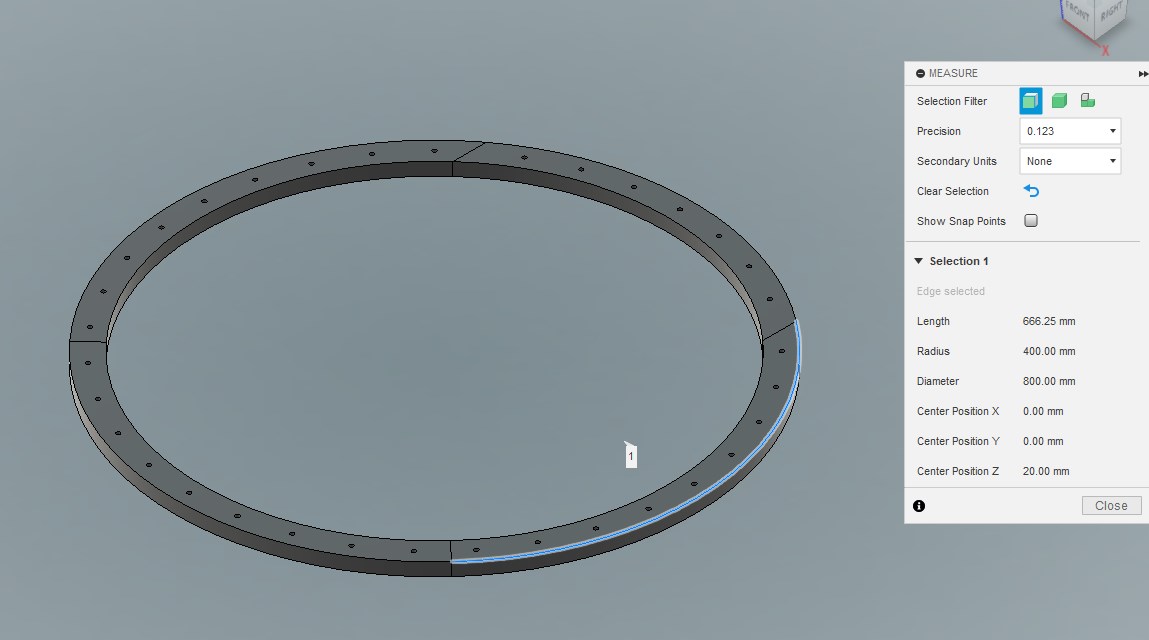

I'm really struggling to find anyone that can supply me with some pretty thick plastic parts cut or machined to a profile.
Ideally, it would be 20mm thick natural delrin. However, I've been quoted over £500 for these four parts and the customer fell off their chair.
And to be honest, I could actually use 8 or 12 of the parts, because they need to be stacked to give about 60mm of depth.

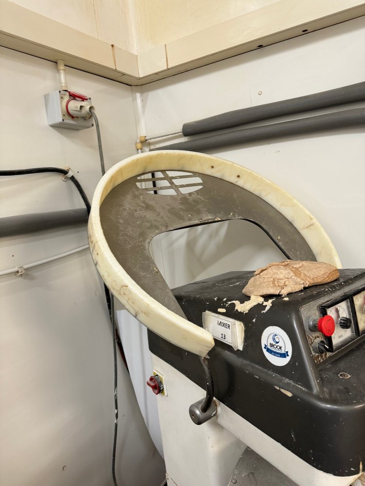

One the OEM guards (not available for this old machine) the plastic is 'formed' or rolled to the ring shape about 80mm deep and 20mm wide.
Holes are just 6mm through holes.

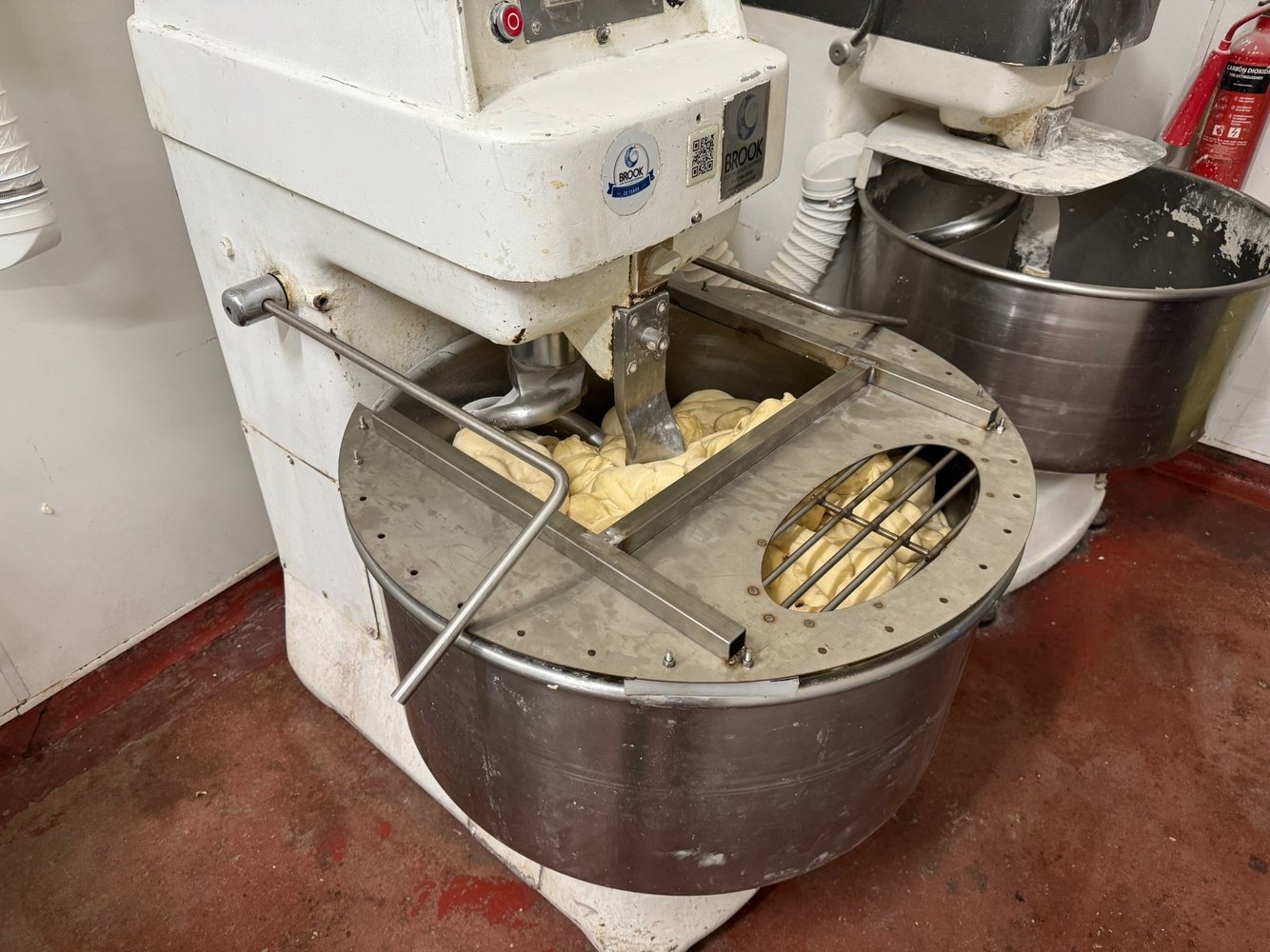

Food industry use, in contact with food, goes on a food mixer and rubs against the bowl. So i believe it needs to be delrin, nylon or uhmwpe?
