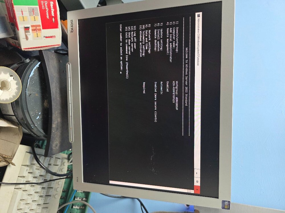

Server 2022 has to be installed as a full version, not headless or command line only. There should be a proper Dell image for this available as a ISO download. Search in SUPPORT and DRIVERS using the service tag. The Dell version includes all the drivers you need etc. Once that’s done you can use the RDP client which I would do through a VPN. Best to not expose 3389 to the general internet.
