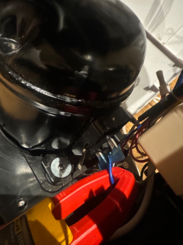

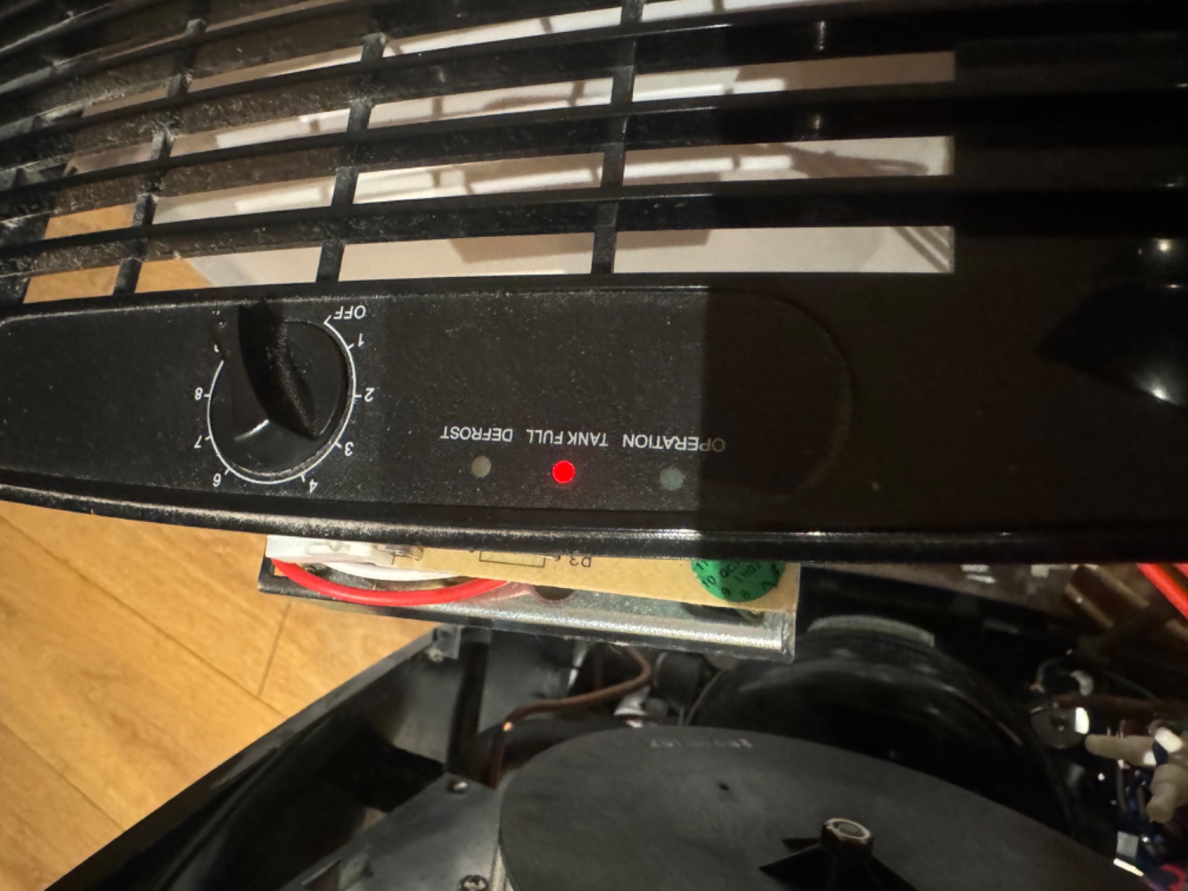

Have a great little dimplex dehumidifier but it stopped working so I decided to see what was going on. It is about 12 years old.
Now before it stopped working I saw the operation LED flickering a bit.
Now it doesn't light at all even though I've got power down to the compressor.
The fan motor runs perfectly.
Water bucket switch operates correctly,
I've got live coming down to the compressor 230v to earth.
I found the capacitor was only showing 1.4uF not 4uF so I thought I had sussed it. Alas no, new cap fitted an still no go.
Looked at the PTC relay. Got continuity across the overload. Got continuity at 40Ohms across the PTC thermistor. House temp currently 16°C.

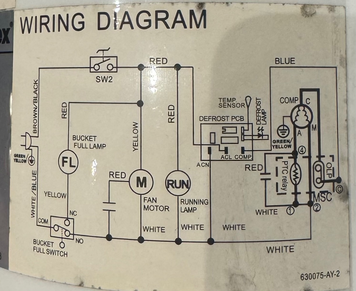

Has this handy wiring diagram.
I'm half tempted to wire the compressor up on the bench just to check I'm not going mad.
If I put the amp meter on the blue wire coming to the compressor (common) I get no current draw at all.
