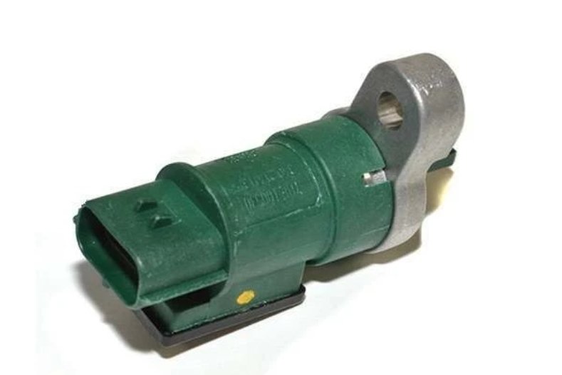

So a three years ago the speedo failed, I replaced the transducer with a cheap aftermarket part and all was good (aside from some hassles fitting). Just recently it started working intermittently, sometimes stopping during a journey and sometimes starting again.
I wasn't convinced it was the transducer but I swapped it anyway, that seems to have fixed the intermittent fault but the speedo read unreasonably high. Something near to 50% fast. So that was returned as faulty and I bought another one, this one claimed to be genuine LR. Same issue, reading 70 mph when probably not even hitting 50 (1,500 rpm)
So the question is whether there could be something other than a definitive transducer causing this?
And a second question, assuming it is the transducer, what's the advice on parts? Are any of the branded aftermarket parts worth trying, or genuine VDO not in an LR packet. Or does it have to be from LR.
