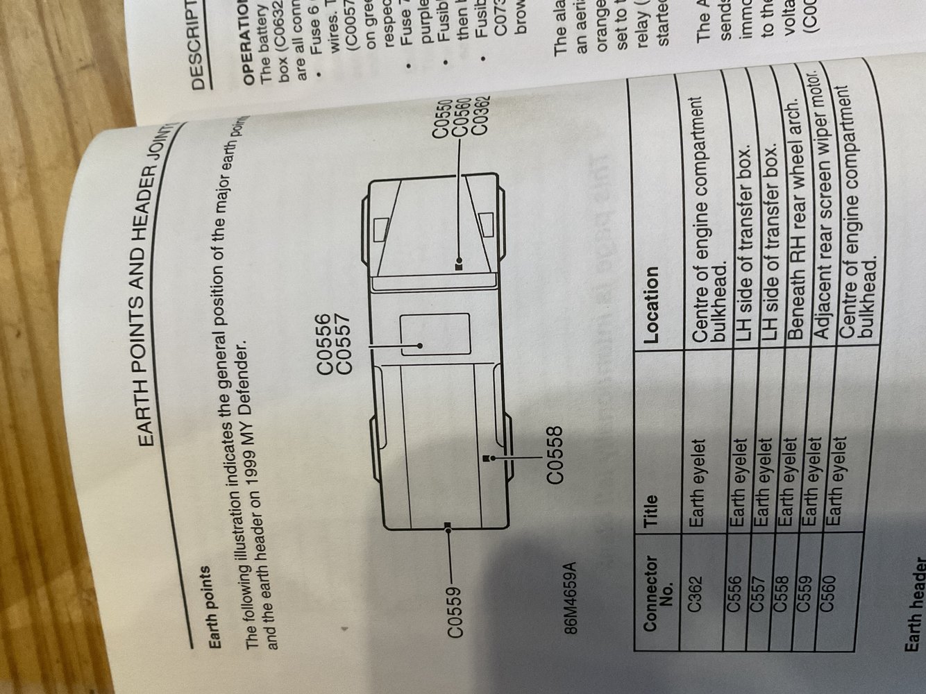

No sign of a fob on his keys but maybe he leaves it somewhere in the landy. Yeah will get another crack at later today so will see if it makes a difference.The key is a basic metal one but it should have the fob with the lock/unlock buttons next to the steering column in order to work. No lights at all on the dash suggests more significant but possibly easier to trace wiring fault.
