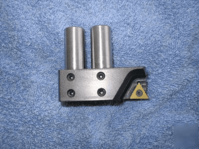

I did some boring last week at 7.6:1 ratio (25mm over 190mm stickout in my boring head) and it was pretty chattery... I got an acceptable finish with a very shallow DOC, but I'd like a much more rigid setup, specifically for doing deep holes at 40-50mm diameter.
I love the look of these, our machinist has one and the design is great, but I'm not splurging that kind of money on something that get used once a year!

I'm thinking of making a long solid boring bar at 40mm diameter held by a 40mm endmill holder, with about 220-230mm stickout to give around 5.5:1 ratio.
with one of two options:
1. bored hole for a 12mm cutdown boring bar in the crossways direction, secured with grubscrews in the bottom. I can adjust it using a flat faced dial indicator for reference.
Upsides: Free (I just need to machine a bit of material and cut a cheap boring bar down)
Downsides: Very fiddly to adjust. Won't bore blind holes.
2. Machine the end to accept a 38mm small adjustable boring head like this one:
www.arceurotrade.co.uk
Upsides: Adjustable and a lot easier to use.
Downsides: costs money for a chinese quality boring head. Also have to buy a spare 8mm bar to use with it. Not as rigid as option 1.
Either way, I have a dogbone to machine soon that if I do both sides in one setup, I'll need that 220mm stickout.
The mill itself is fairly rigid, it's a 2.5t bed mill with an ISO40 spindle.
Anyone with "boring" experience care to add their tuppence?
