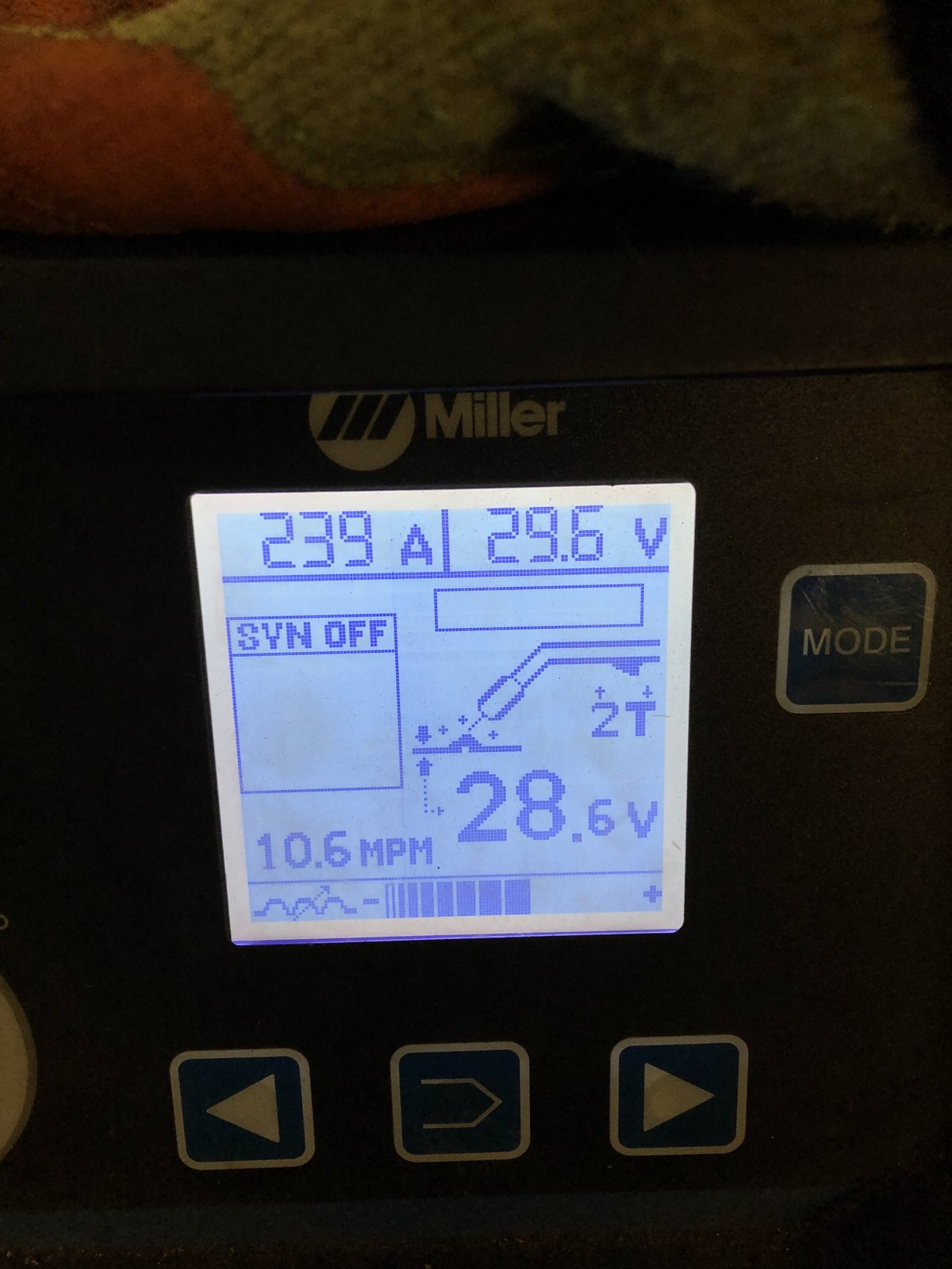

Yeh I understand that, I just mean that its odd the spec says 200amps when I know it will do 220amps.
It wont do 220 amps for a significant time, i would say. If you work with very short stick out (probably too close to actually weld continuously) the current will increase and may read 220 perhaps, but without the wire feed increasing accordingly, this will not be a characteristic that would be recommended, therefore that is probably why they don't state the 220 amps, perhaps?
