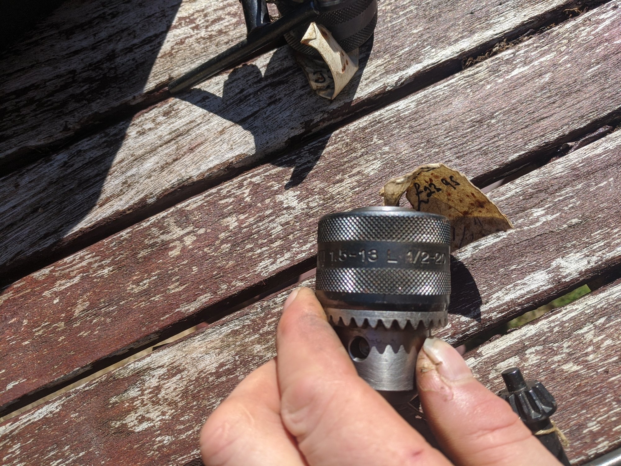

I have an Evolution mag drill. It came with an adaptor to the standard 1/2" x 20 UNF power tool chuck thread and a pretty lousy keyed chuck as supplied. I fitted a keyless Rohm Supra: pricy but very good. I've never seen a 1/2" x 20 Albrecht (which doesn't necessarily mean they don't exist).

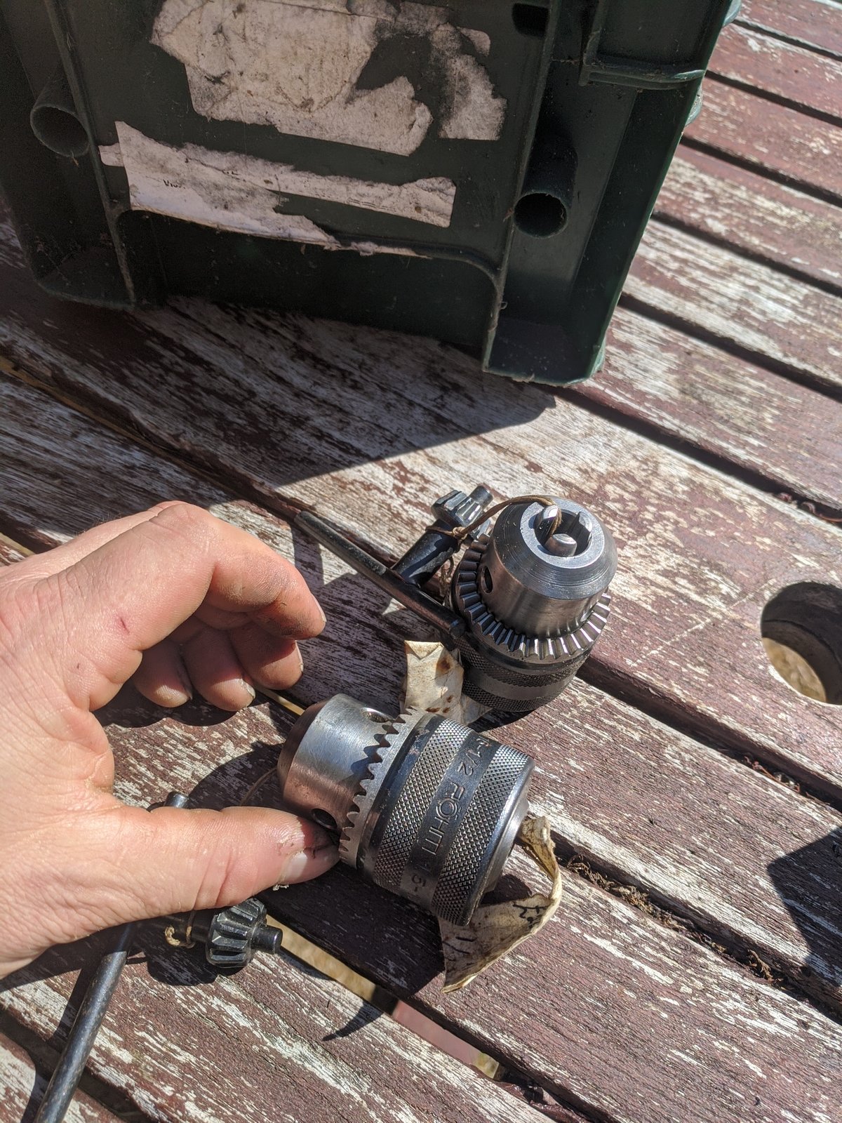

What’s in the mag drill? Mines an mt2 which has a Weldon on it. I’ve a chuck that I use for twist drills that’s also mt2.
Jacobs are good or they were at least. I don’t think I’ve ever bought a new chuck. Just go for quality old ones which you can find for not much if you are patient.
