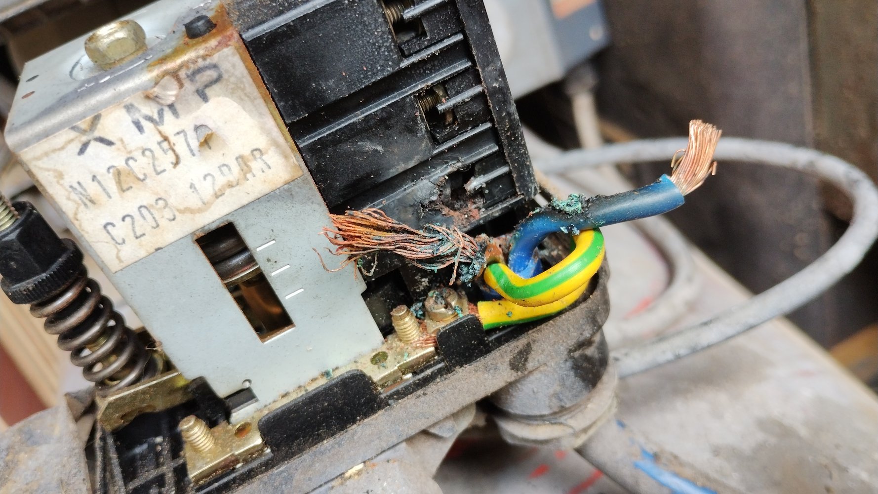

One of my compressors has just failed. It's the evil direct drive one that eats fuses, won't start when cold, etc etc.
I think this burn out has just been caused by poor terminal conduction. It's lasted like that for years but I've been using it at higher duty recently (to run an air fed mask) and I think it's just melted things where the terminals create higher resistance.
It's wired on 2.5mm.
Anyway, I could get a switch off eBay that will be marked as "ultra heavy duty" 1 million (Chinese) amps etc, but, if I actually want one to work for a while, what should I get?
...and where can I mail order it from?
I mean machine mart has 20 or 25a ones, and I'd trust them slightly more than eBay sellers, so maybe just get one of them?
