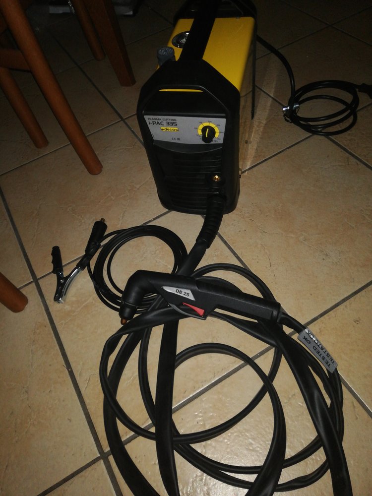

So that's what you get
4 meters fixed Trafimet s45 torch
Roughly 2 meters 10mm² ground clamp with Dinse 25 connector, very rubbish battery charger clamp

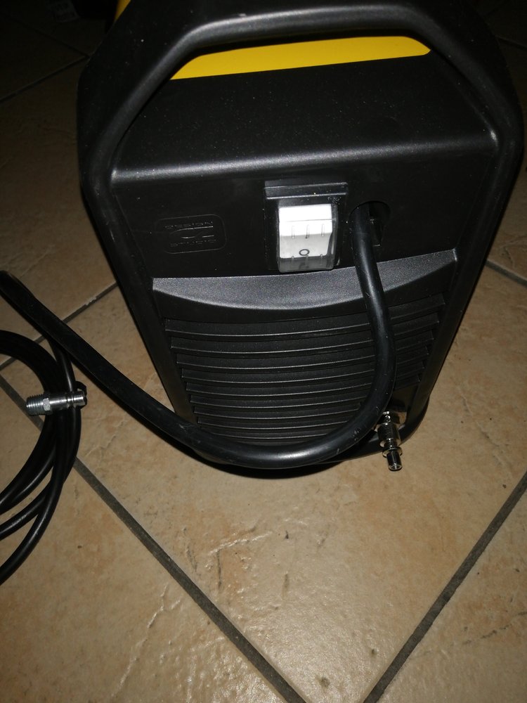

Roughly 1.5 meters power cord with euro plug
2 air fittings 8 and 10mm .
No consumables if not the ones installed on the torch.
It has a 30% duty cycle at 35A and 100% at 20A

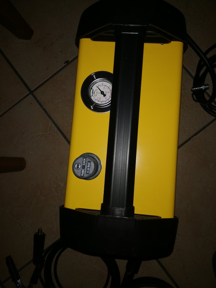

It has a built in regulator which is something I really like , protected and inside the machine .

No water trap .

Air pressure range between 3 and 5 bar

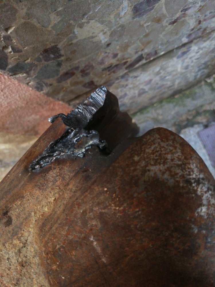

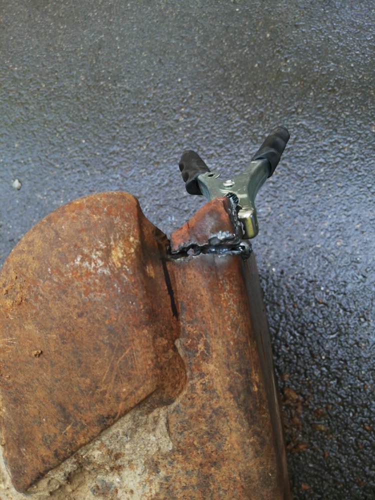

That's the cut quality on a 10mm cutting edge on a bucket I've been repairing
Little bit of crack gouging too .
Overall the machine didn't work in the perfect conditions , and to be honest I'm more an oxy fuel guy ,but I felt the machine like a toy and a waste of money, hopefully it will change my mind later in the future maybe in better working conditions but I don't think so .
