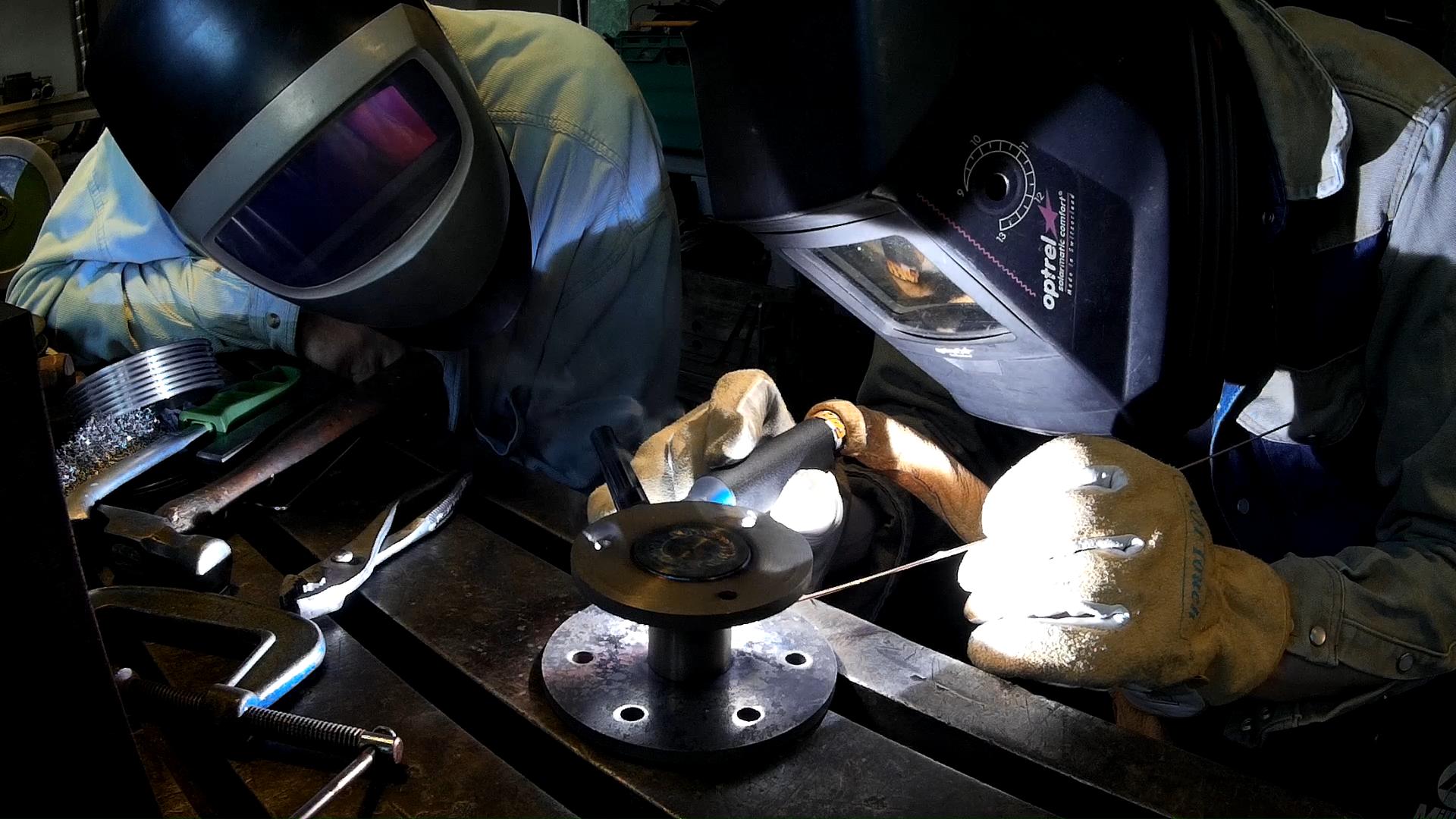

Well you need something mate otherwise it's just watching a random guy welding
Kind of what I aim for... I just like playing about with the cameras to be honest, I don't do it for any other reason. Kind of like what Travis (fieldres) does... less talkin', more arcin'

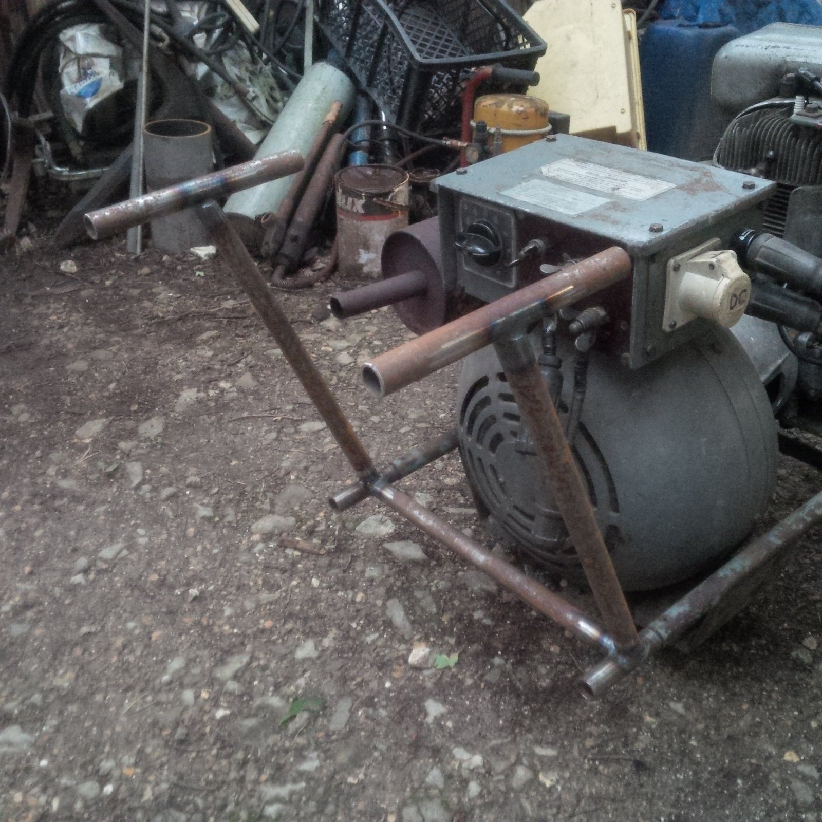

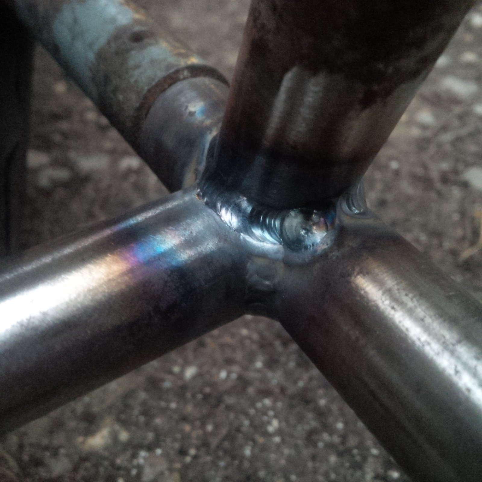

These handles make moving this machine around very much easier. Welded completely with this engine drive with a miller hf-251 HF box, 26 flex head with a stubby kit, 2.4 thoriated, 1.6 er-70s-2 wire.
