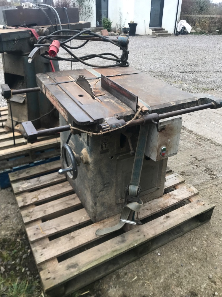

Fitted to a big Wilson table saw, 3ph, recently bought cheap.
Running on a rotary phase converter, which runs a Crompton S10 brake just fine.
When I connect power, the brake contactor K5 pulls in, and stays in. The DOL contactor K1 for the motor is disabled. This isn’t right.

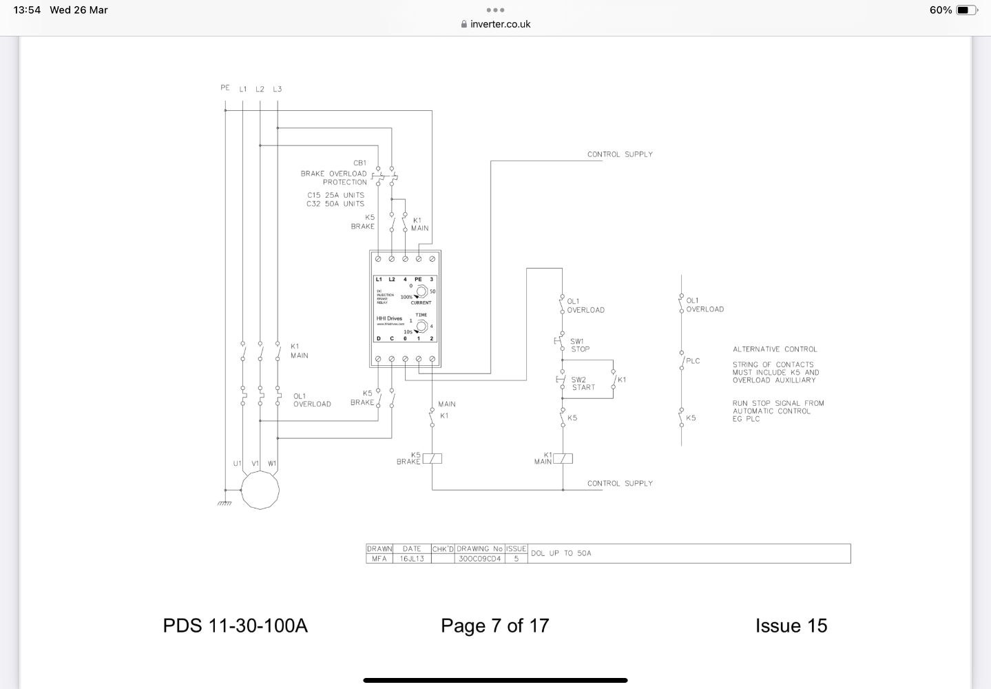

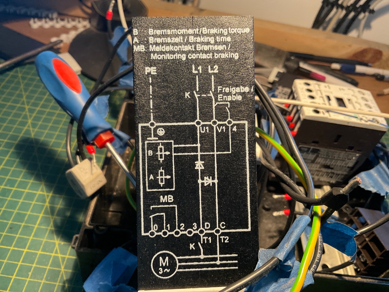

Diagram:
I’ve made sure the wiring is as above, but CB1 in the unit is only single pole to the L1 terminal of the brake unit, and is a normal MCB. The diagram seems to show a normally open type of breaker. What is it?
Relevant control stuff:
According to this, braking is triggered by voltage between inputs L1 and 4, but this is the initial state of the unit, with power applied.
Link to manual:
