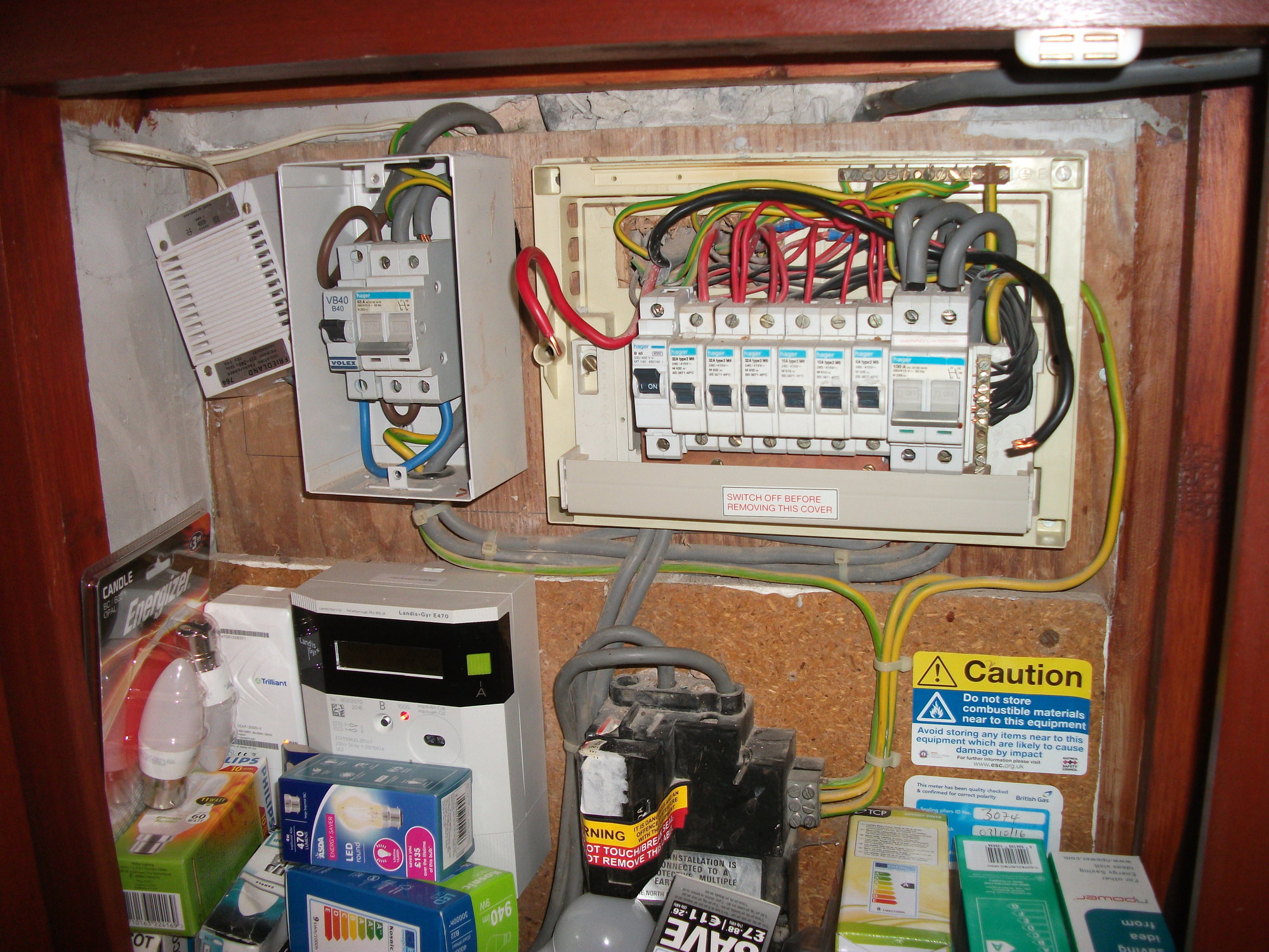

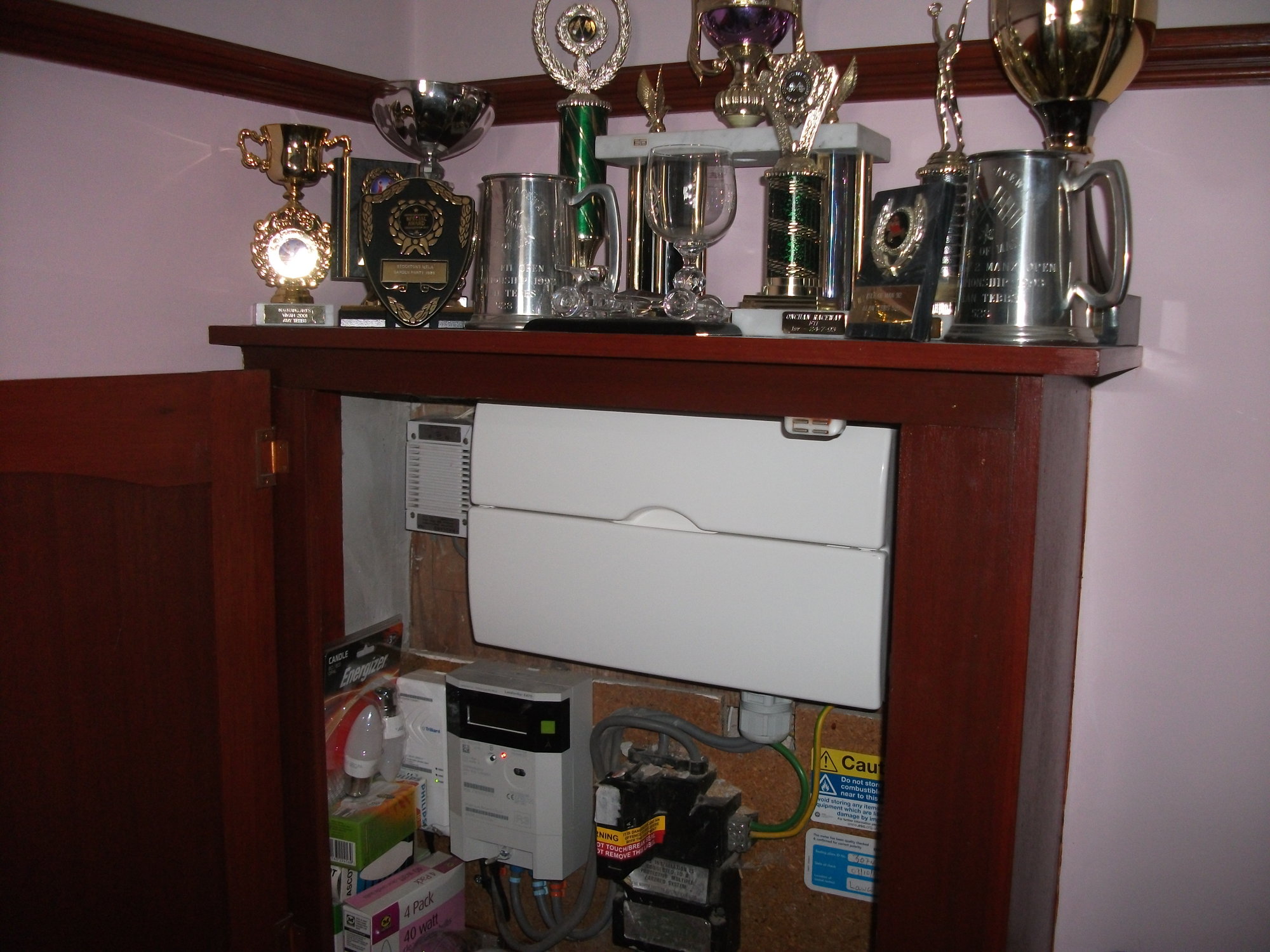

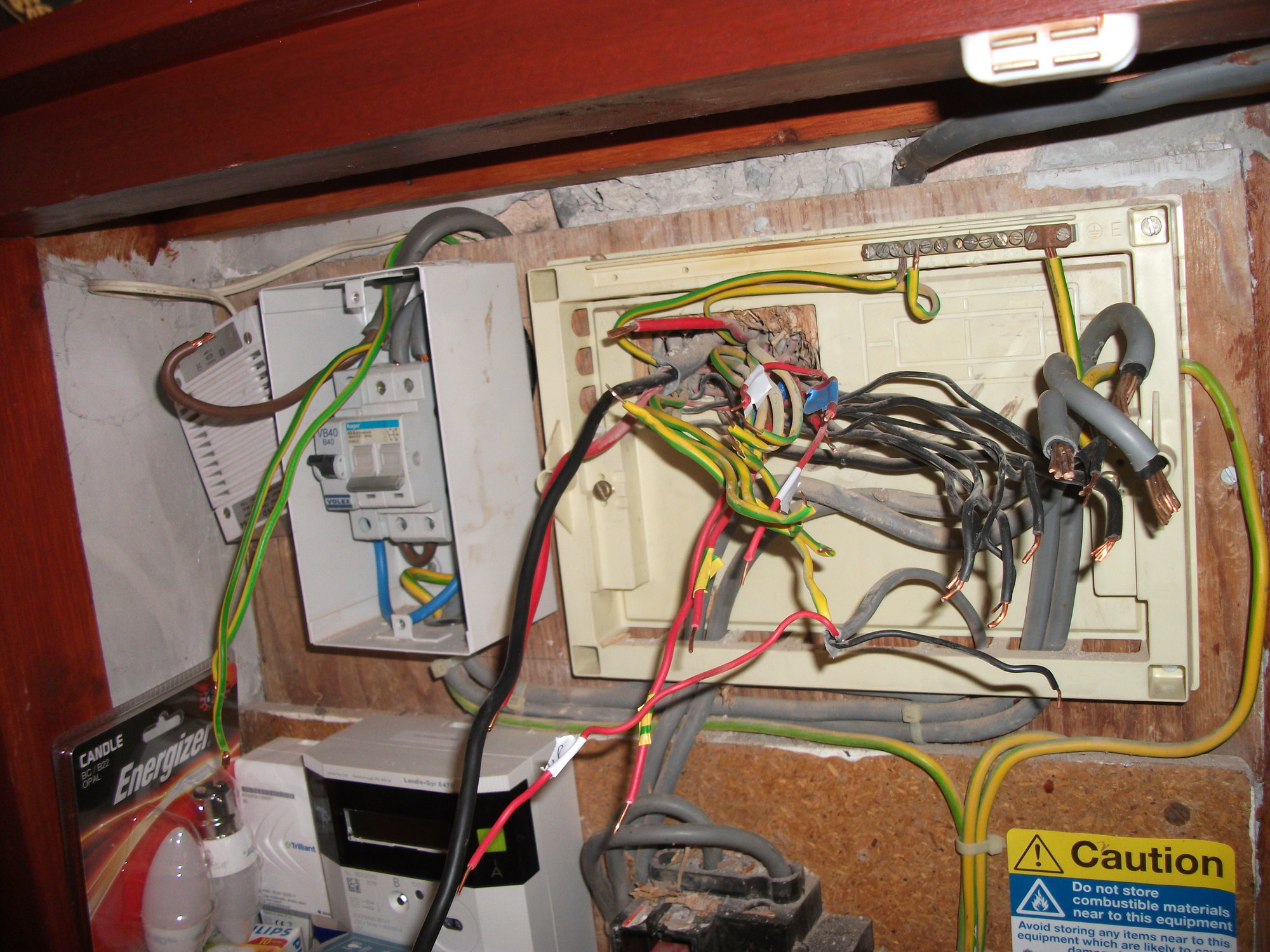

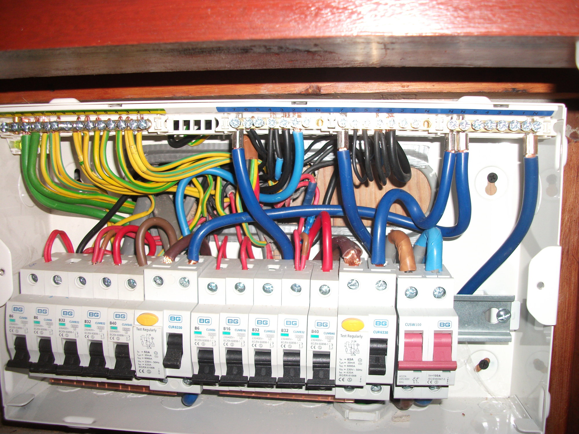

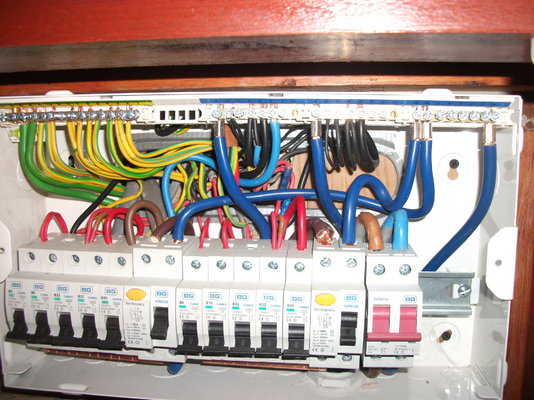

well finally got round to doing it after 6 years of humming and haring /namely for not a lot of room and wires weren't very long .started at 8 am and it took till 1pm to get it fitted all seemed well apart from garage that needs sorting that's another day then turned on the landing light and trip
the only part of the house I never rewired was upstairs lights and guess what a borrowed neutral
should have realy known because the guy before me was an electrician or supposed to have been . ran another neutral up in cupboard up some trunking already there and separated the circuits now all is left is the bond under the sink . I did run it over the new kitchen when it was fitted but never connected it gonna have to dig a few boards up to find it . not the end of the world though the box is quite tidy but some cables had to be stretched otherwise it would have been perfect still acceptable and all cables are in correct order the 10mm ones were a pig and the mains tails to fit one for the shower and other for the garage
