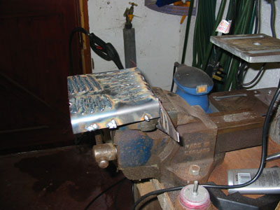

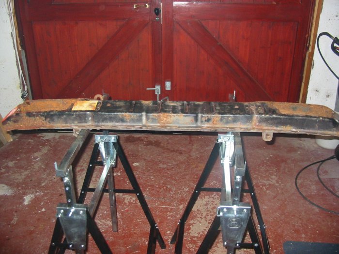

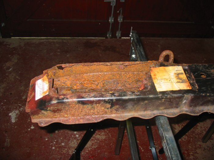

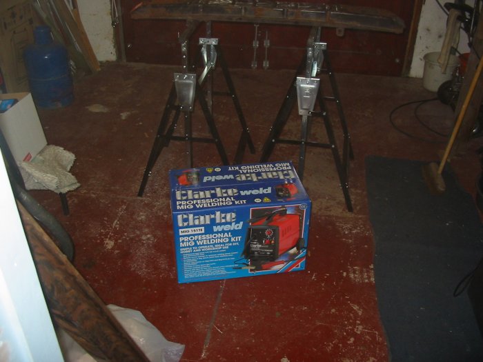

Well folks, I decided that after lying here a fortnight I should open the box
Was struggling a bit for some material so decided to improvise, well, it's no good as a bumber bar
Thought it could be my welding table
2 mins with a flap disc and it's nice and shiny
Can't put it off any longer, time to be a welder

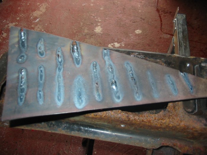

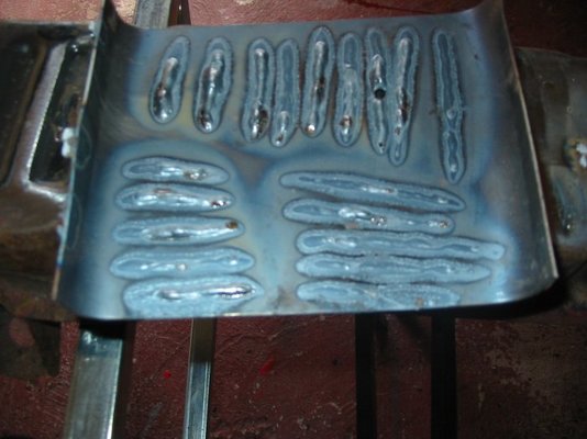

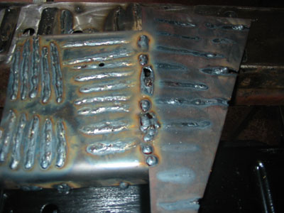

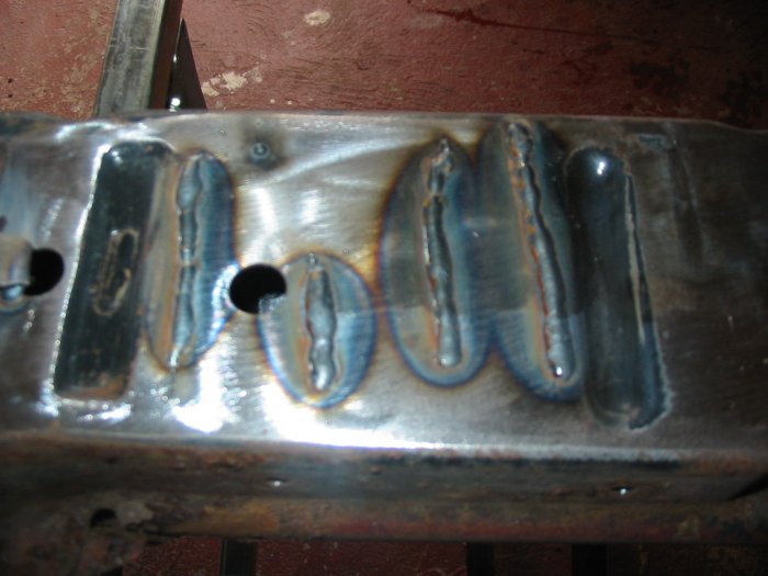

Clarke TE151

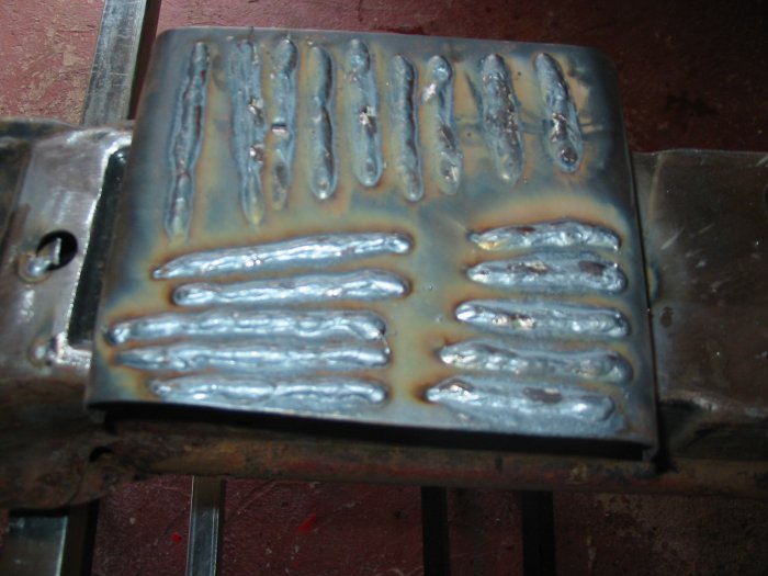

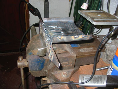

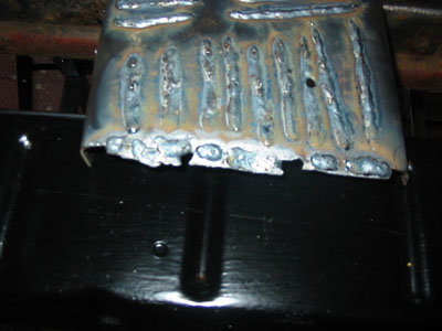

Put it all together and followed the tutorial re wire tensioning. Have some bits of 1mm so set it at MIN, 2, wire speed 6 and gas at 4. It is the CO2 that came in the box. Couldn't resist a quick try:
Will get some of the 1mm sheet now and give it a go, more later I hope
Cheers
Jack

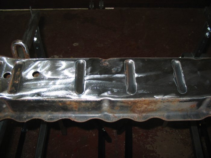

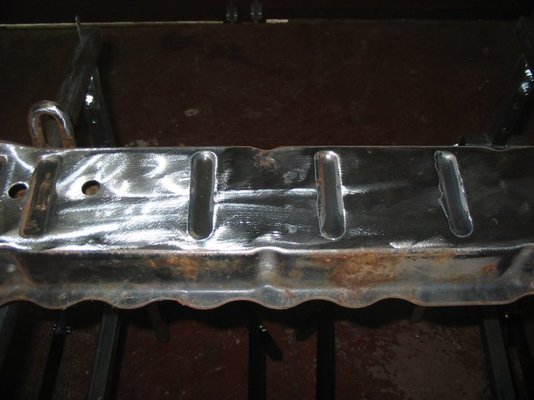

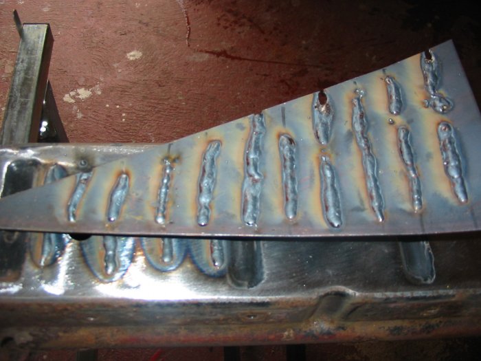

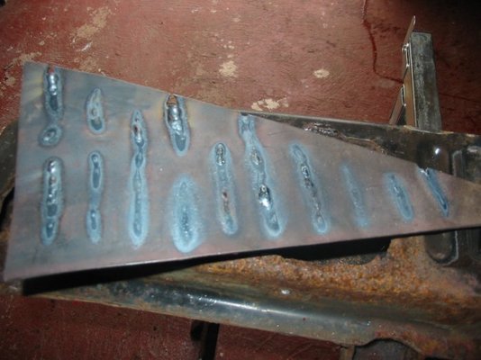

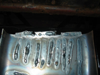

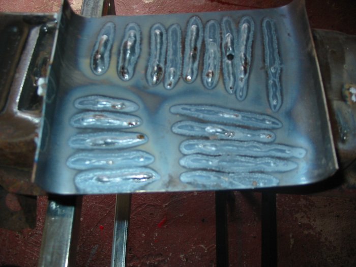

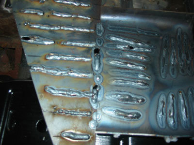

Here's the result
