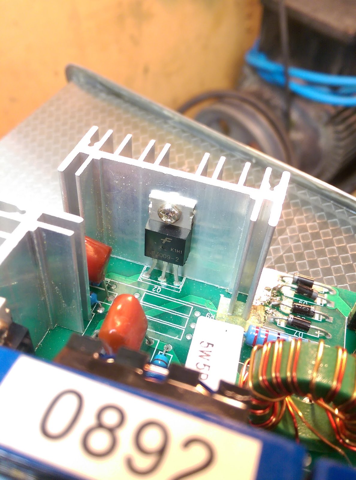

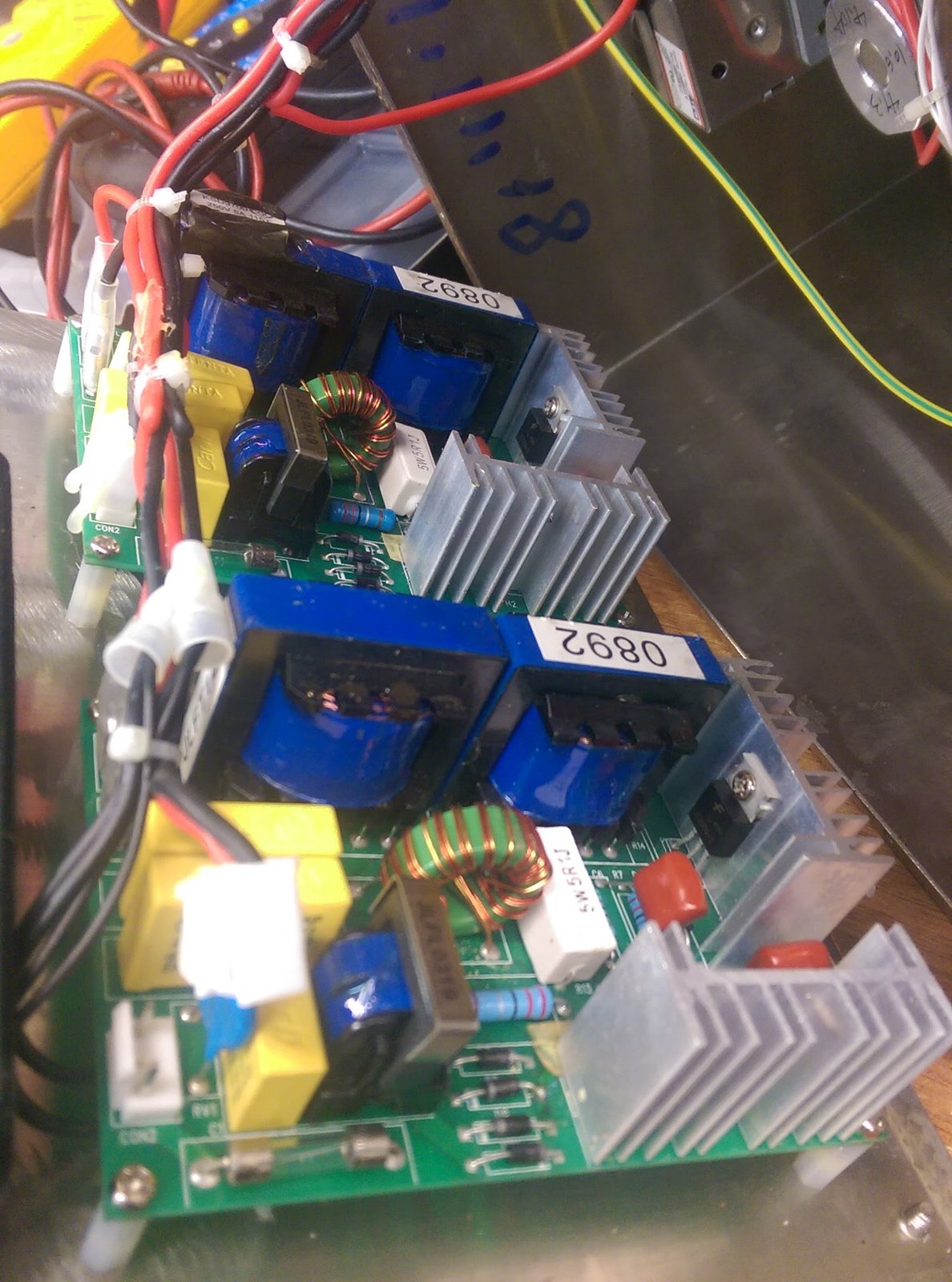

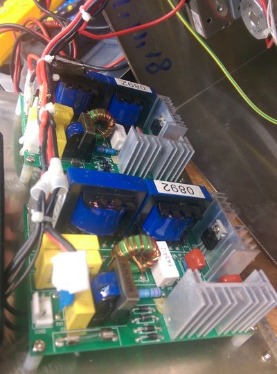

Interesting to see the electronics underneath the tank - and a welded tank at that. Used to specific TIG welded, inside and out in an attempt to keep them together. The transducers are banging the bottom of the tank up and down rather fast and it tends to fatigue, leading to leaks. Sometimes used to see it local to where the transducers are fixed to the underside - used to vacuum braze the mounting boss to the tank bottom. Tank bottoms certainly erode over time. Although I guess that was on tanks with a several kW of ultransonic power, no the toy ones pictured here :-)
High frequency (ie like the 45kHz pictured) is usually okay on aluminium - the lower stuff (25kHz) will punch holes in it if left in too long - dangle some aluminium foil in to see the pin holes appear in it.
