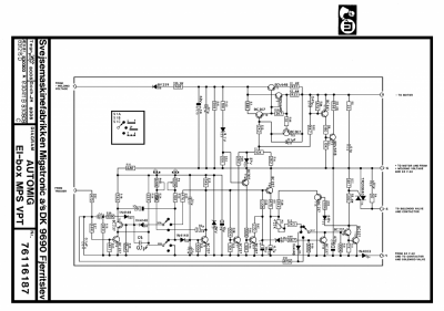

I've identified the triac on the control board appearing as TXD10K40 in the schematic appearing in https://www.mig-welding.co.uk/forum/threads/dan-mig-140-mono.98734/.
I know it's an AC switching component. In a couple of posts on these forums that triac is mentioned in discussion of wire feed problems, though the consensus suggested the wire feed motor is likely a 24V DC motor and that an AC switching component probably doesn't drive it.
I haven't found a definitive reference regarding what that triac does control, so I thought maybe it is causing my "no arc" problem.
