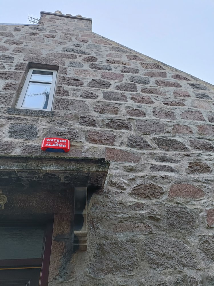

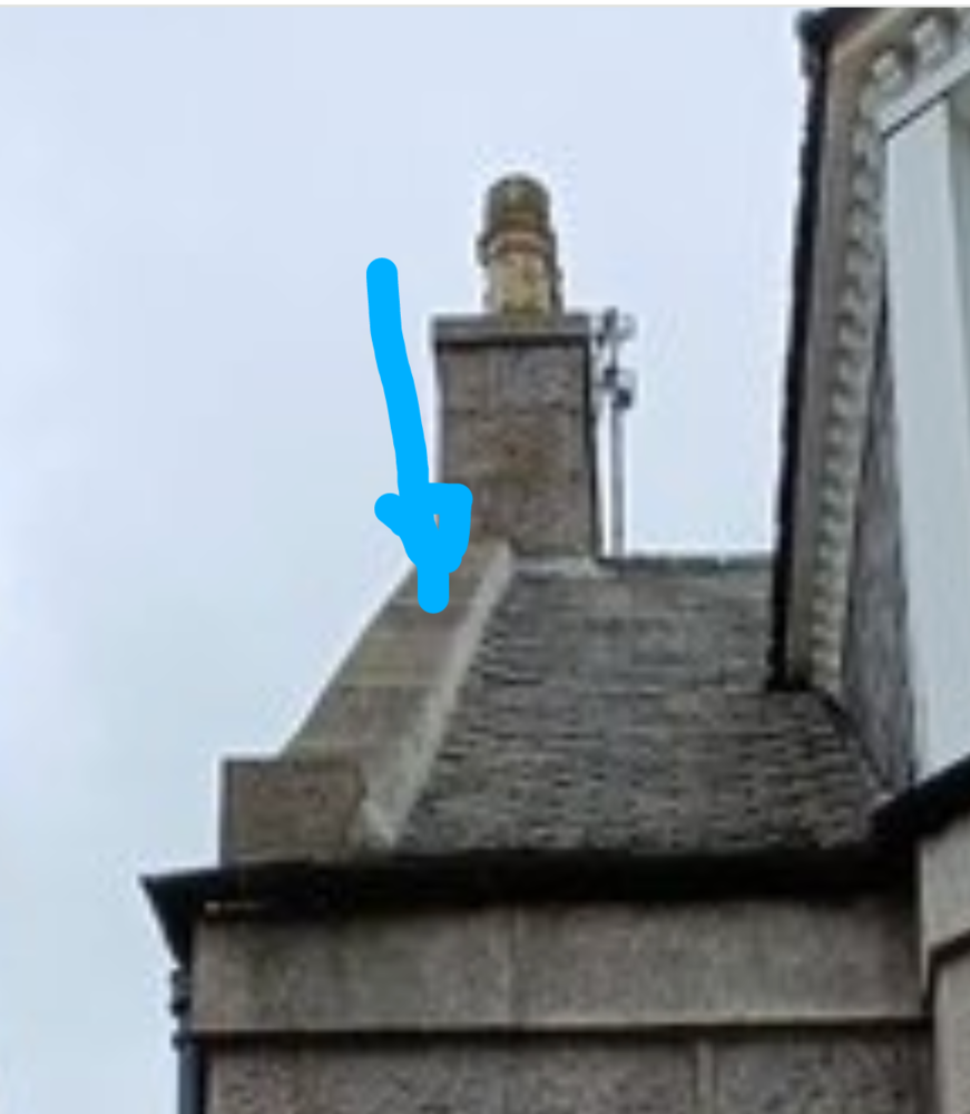

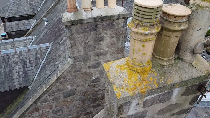

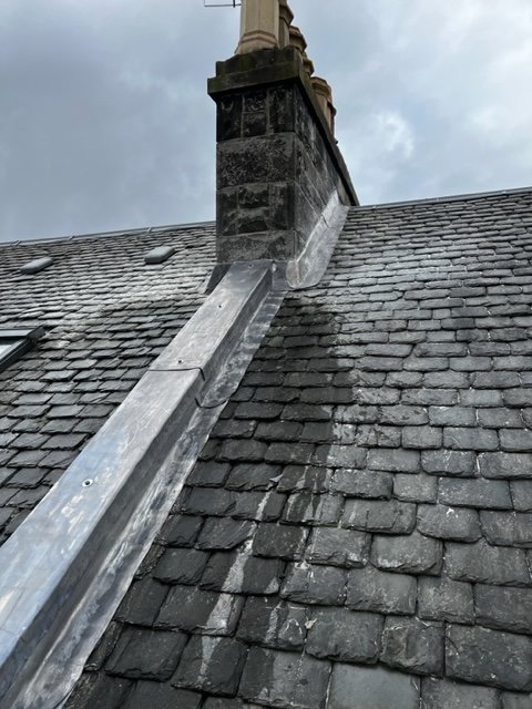

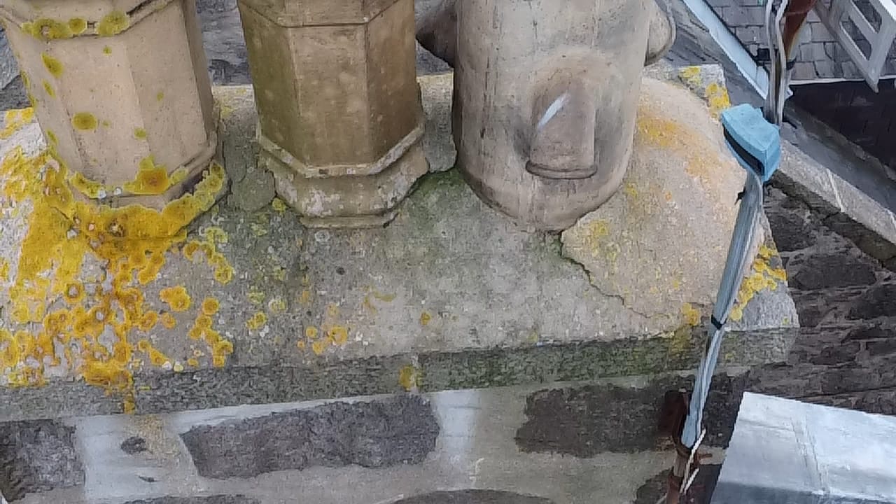

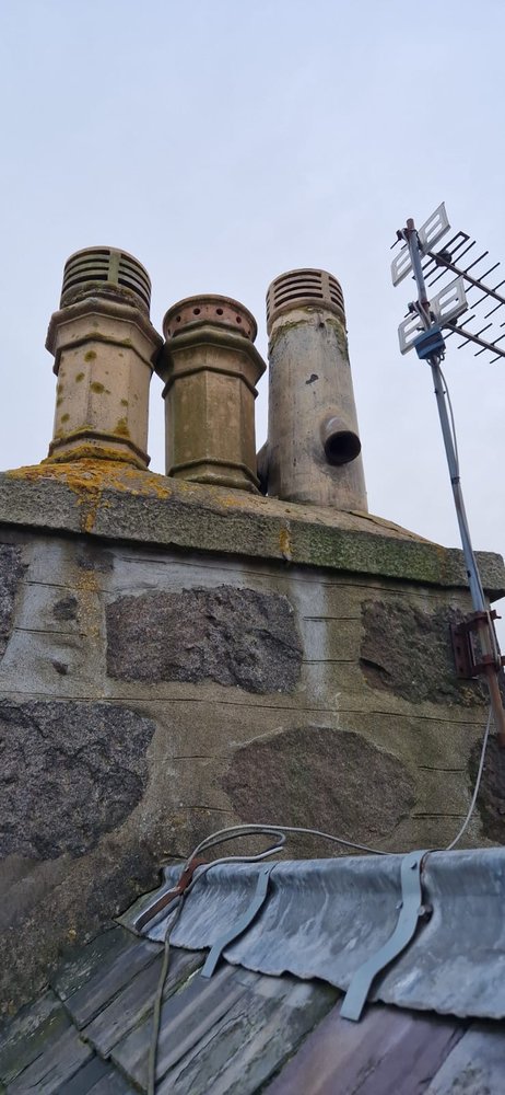

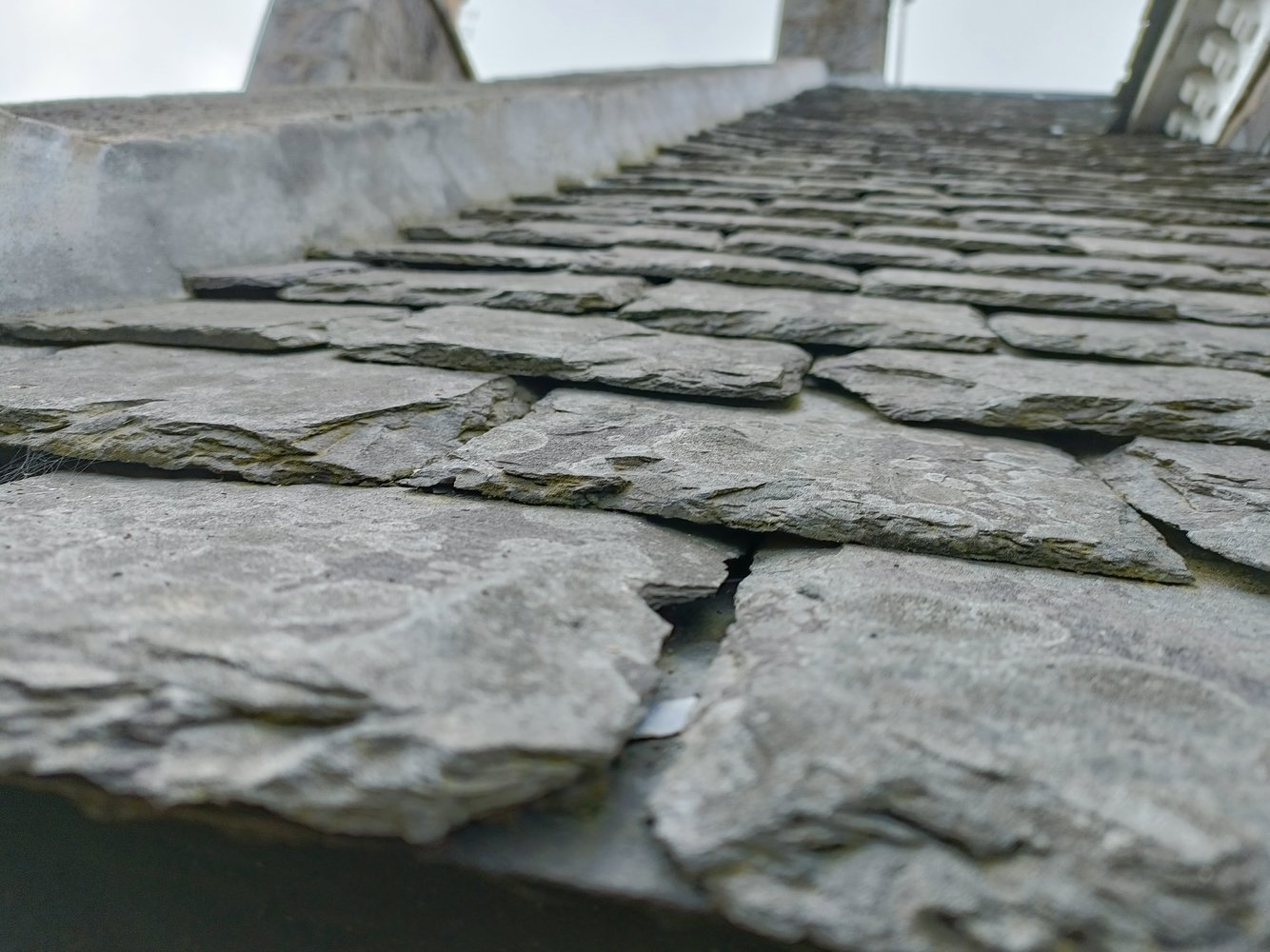

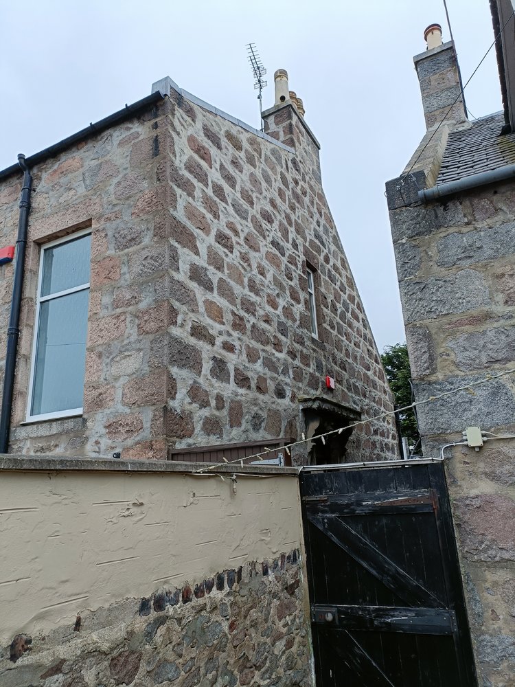

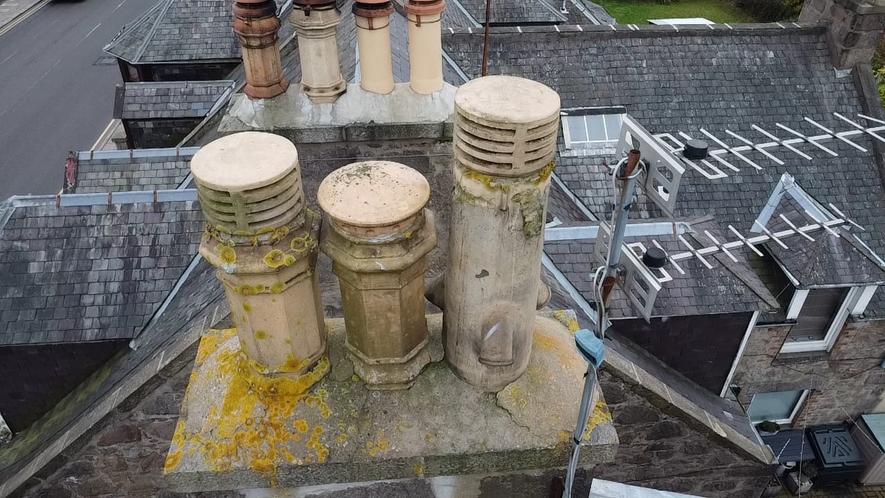

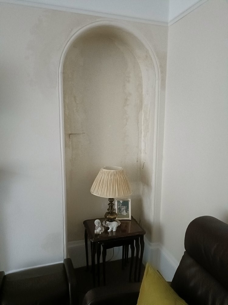

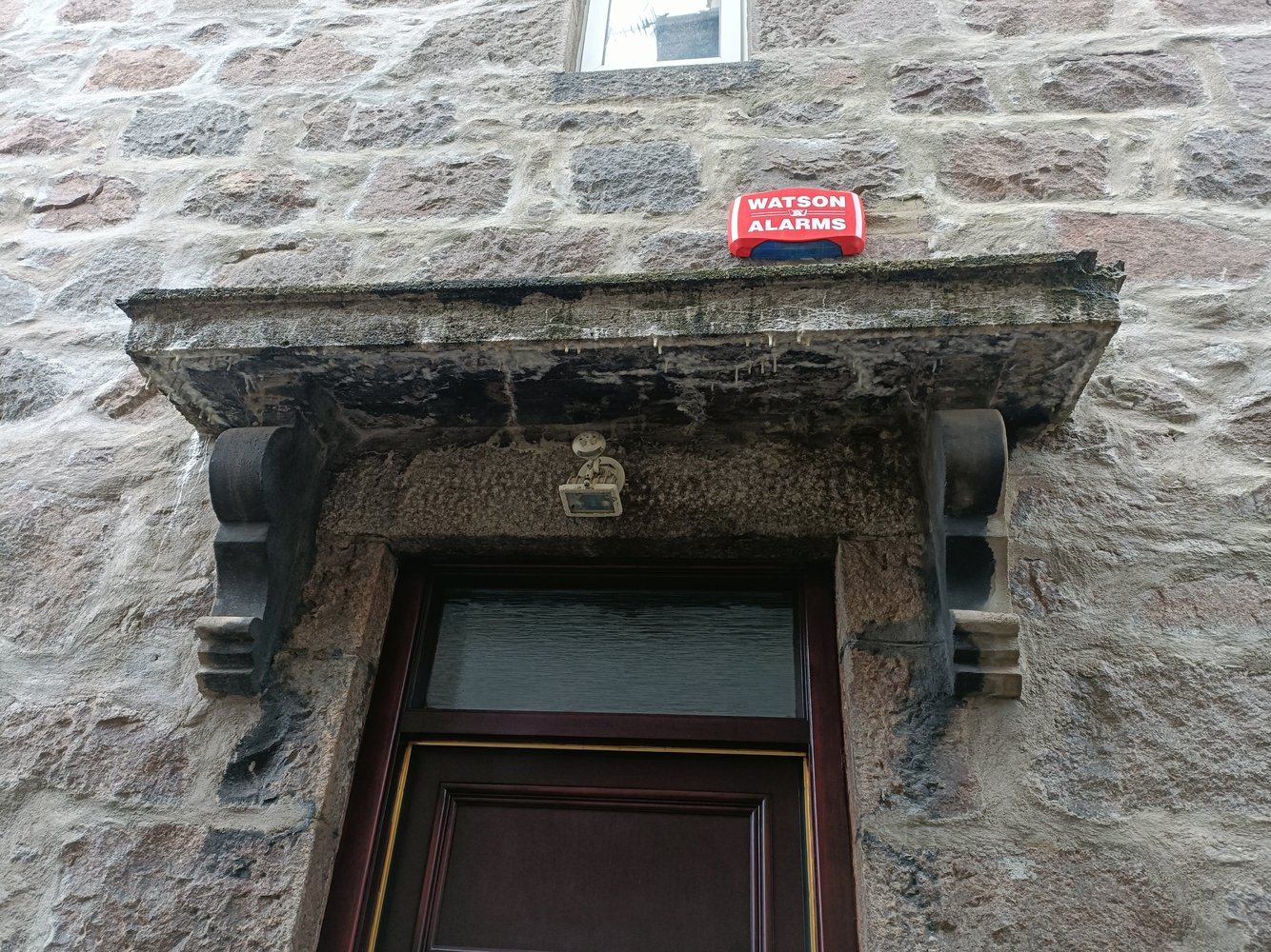

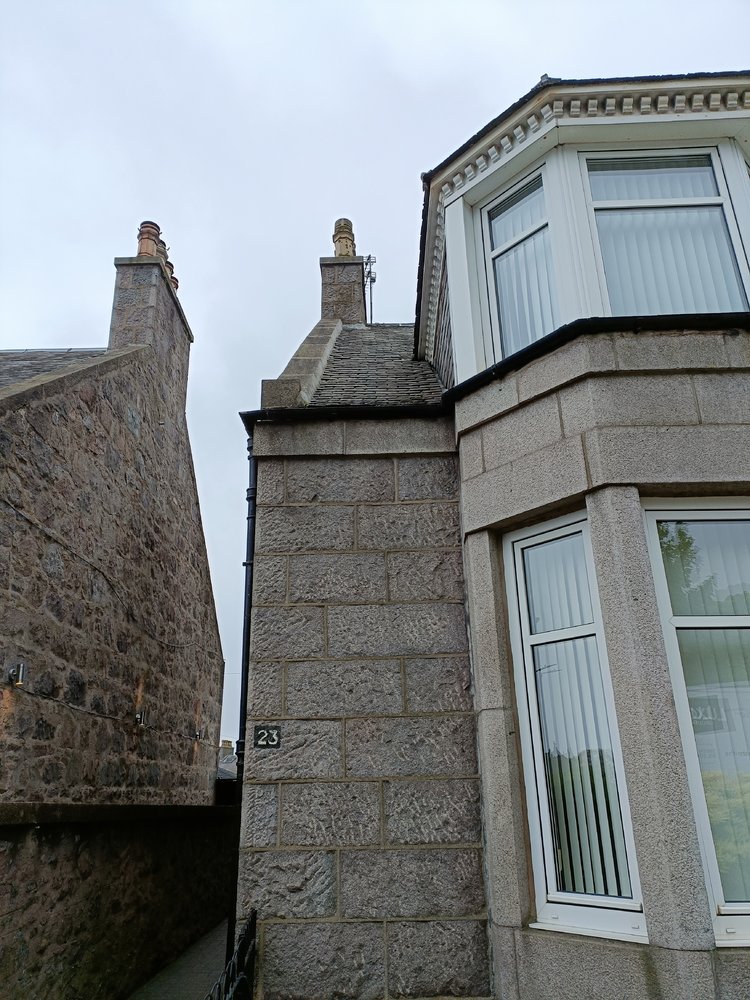

I’ve started helping my neighbour and this is the biggest issue for her house. She’s had a few quotes and all really expensive to sort. The chimney cans have areas of the cement around them missing and assume it’s leaking at joins inside the chimney inside the wall. What would be the cause and fix do you think? Could the chimney have a blockage and water pooling and leaking at joints? Also in the alcove could the issue be mainly due to it touching the outside wall or muck built up behind the wall and not allowing air to flow? The area is on the right hand side of the outside photos and in the downstairs room. Anyone experienced with what the cause would be and a solution?
