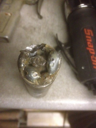

as i don't have any SS electrodes, and most want to sell 20 or more rods.
im searching for some SS wire and will weld some blobs on it around the edge.
where the spinning collar and wheel nut are.
and try the 24mm socket first...
I have removed 17 locking wheel nuts this week.
And have a set of four Peugeot ones booked in for next Wednesday
I normally do about 10 a week on average!
I charge good money for it! T0rnado69 now knows why, it is not a simple as people would have you believe.
McGard locking bolts are not that bad. Modern Jaguar hyper dome wheels nuts are the only ones I refuse at our workshop.
why?? and what options does the owner have to remove,is there a risk of damaging the wheels with that paticular type.
