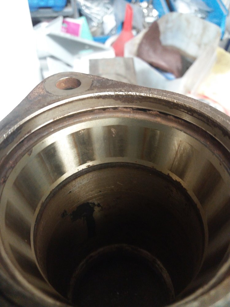

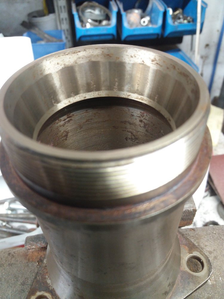

There is no room to machine the existing housing, it is so thin. It's literally regrind or try lapping.£100 for two bearings and two seals and they conveniently forget to mention you have to machine the housing out to make them fit.

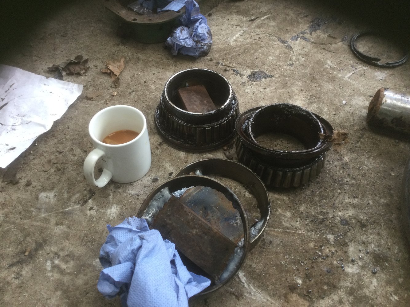

I would say most of the race is okay, and it's actually impact damage from the obviously harder rollers in about ¼ of the raceway.

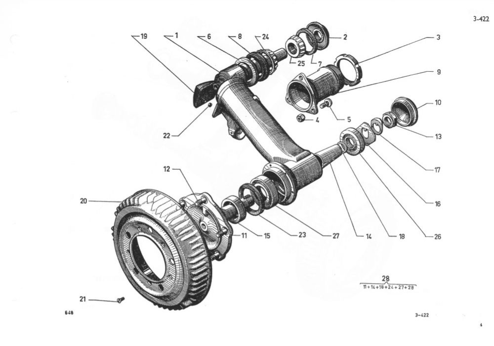

The chassis is linebored after welding, these housings then bolt through the chassis from what Peter was explaining.
