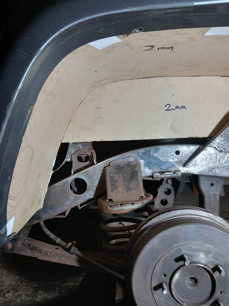

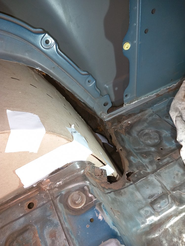

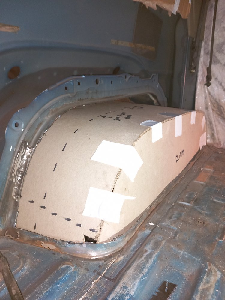

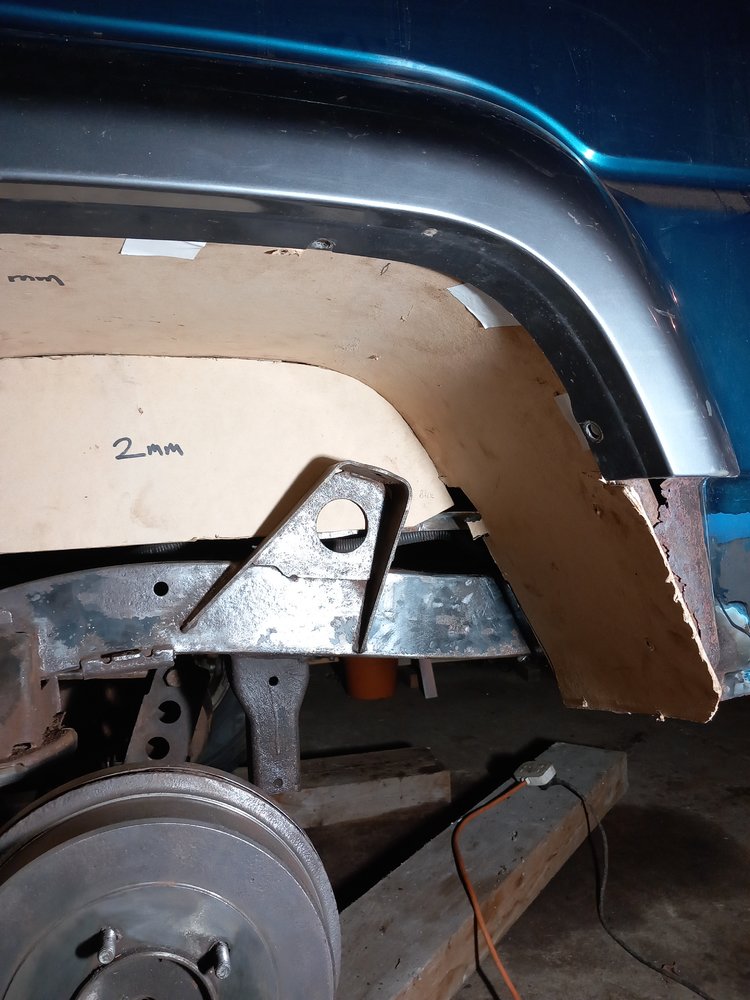

Made a giant card template just to check my idea was viable. I think I can bend 2mm steel in the shape of the plastic wheelarch trim and continue that shape for the whole arch depth. Then one vertical piece of 2mm sheet from that to the 4trak floor.
This is a rough mock up
View attachment 429939View attachment 429940View attachment 429941
I will join my new arch to the seam between the original inner and outer arches which i am going to leave in and extend downwards. The floor at the front and back of the arch requires repair and making slightly bigger to meet the shape of the new arch.
