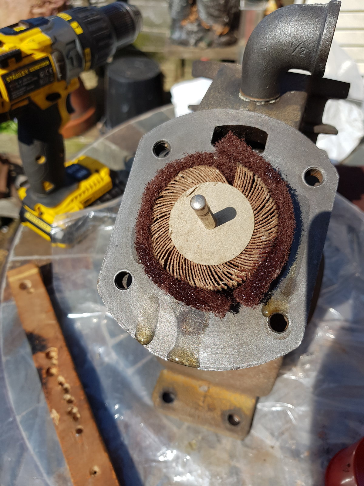

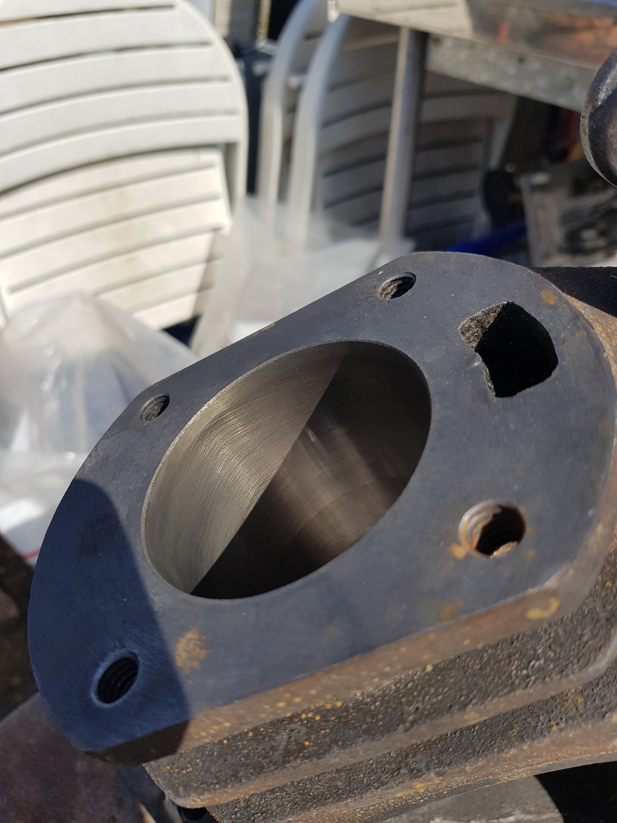

The cheapy three stones on a spring loaded stick thing, i have been told, can cause the centre of the bore to be larger than the top and bottom, the bore would be barrel shaped, of course you will get the rings opening and closing, fluttering. So be careful.
Never had an issue myself.
But I know those who did not run all the way to the top or bottom and caused that.
