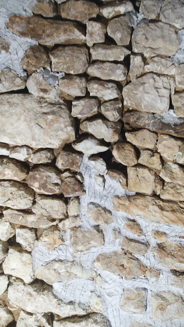

The walls are faced with coursed stones about 20/30cm deep and the space between is 0.6 metre of rubble infill. I was present on a friends job a few years ago when a few of the coursed stones fell followed by a small avalanche of infill. I think once the fierce jet gets behind a coursed stone it removes material from behind very quickly, more quickly than can easily be controlled.Why is a powered hammer needed if the stuff is cottage cheese ?
if it cannot withstand a power washer set on low/med, then the mortar needs to come out.
That is a very interesting looking tool, it may be another candidate.why not get a rotary carbide mortar cutter fitted in the angle grinder theres loads to choose from https://www.pipestock.com/masonry-mortar-router-bit
I have a similar wall to do, been putting it off for years…Luxury having all those straight lines. The attached image is what I have to deal with. For certain an angle grinder would be in and out of my hand too frequently. My pic shows commencement of deep pointing before second decorative "pierre apparentes" semi render on a job helping a friend out. The raking out was done with hammer and chisel as the construction was most certainly not a candidate for a chipping hammer, it was very laborious and I wish I had been unavailable as my right arm was unhappy for days afterwards.
That type of construction is the norm hereabouts, there are no straight or wavy lines of more than 18" and those are infrequent.
I think I took this photo because it was possibly the most hideous random coursed masonry I have ever seen, there are many 4 ways joints and too long straight paths. For the work at my place I have slightly more elegant to contend with but not by much, I need an aglile cutter that can be steered tightly.

I tried one of those type things, and a thick diamond disc too….a chipping hammer, sds etc. all work, but none are perfect. Pointing especially in stone is a tedious task, that just needs doing and doing properly! Ive a corner down the side of a chimney that needs doing again since some muppet, me tried to nail / tack cables to.why not get a rotary carbide mortar cutter fitted in the angle grinder theres loads to choose from https://www.pipestock.com/masonry-mortar-router-bit
At various properties I have had to chase out bands or door reveals done in OPC, sometimes we leave it in place if the stonework is too fragile, its a crime to use the stuff, or it should be. You do need tools when you are going at over 350M2 of walls as I did on a place three years ago, just gentle tools.If you are taking lime pointing out, you do not need tools, unless its so bad the wall needs rebuilding
Tools will make the joint bigger and more likely to fail again
Ive seen houses ruined when lime mortar has been hacked out with a grinder or sds chisel, even worse when it is redone with Portland cement and the owner then has damp issues....

I reply a long time later because I only tried a scaler recently. I think for any hard stones, basalts and so on, for sound brick they would be perfect for raking out and to a controlled depth too. The stone hereabouts is chalky limestone, Tuffeau is so soft that with a multitool or swiss champ you could probably carve yourself a well detailed name or inscription in a few minutes, a large hole in an hour.How about a needle scaler ?
